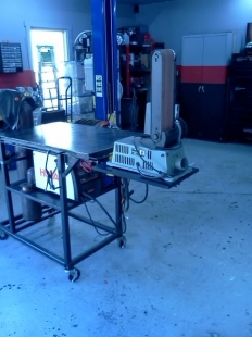

Homemade welding and fabrication cart fabricated from 1-1/2" and 1" 11-gauge square steel tubing, 3/8" rod, and steel plate. Cart rolls on ball-bearing casters for enhanced mobility. A hitch receiver is utilized to enable a variety of power tools and accessories to be mounted directly to the table.
