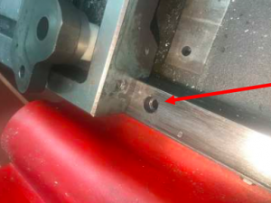

Homemade Y-Axis Take Up Nut Mounting Bolt Access Improvement
rgsparber on homemadetools.net
Homemade method for improving access to the Y-axis take up nut mounting bolt on an RF-30 mill/drill, by drilling a hole through the table.
