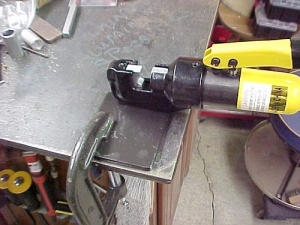

Homemade hydraulic crimper mounting plate fabricated from 1/4" steel plate. Screw holes in crimper were tapped 10-32 and plate was counterbored to accept the screws. Intended to ease crimping operations by freeing one hand to guide the wire.

Nice mod, makes crimping easier. Got my hydraulic crimper from HF .for less than $30 bucks.

Very simple mod, yet made the crimper a lot easier to use.
