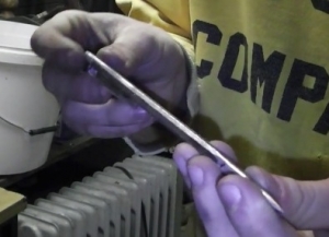

Homemade metal scribe fashioned from an M6 tap and steel rod. Scribe tip was ground by spinning it in a drill against a disc sander.
