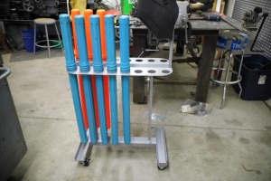

Homemade rod guard caddy intended to improve the storage paradigm for TIG welding components by incorporating both stability and mobility into a rack system. The top was fabricated from 10GA hot rolled steel, the base from 1.5"x3" channel, and the uprights from 1" square tubing.
