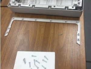

Homemade Screw Differentiation Method
rgsparber on homemadetools.net
Homemade screw differentiation method constructed from shipping labels and a marking pen.
Jan 05, 2016 4:02 PM
ncollar
Rick
I use a piece of cardboard with the part drawn on it and small ice pick holes where the screws are located at in the drawing. No more screws on the floor.
