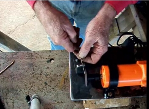

Electrode sharpener made from HF trim router with 2" 3M roloc sanding disc mounted on a 1/4" plate.
