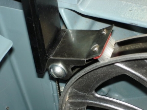

Homemade Bandsaw Wheel Brush
kerflesss on lumberjocks.com
Homemade bandsaw wheel brush utilizing formed, 22-gauge steel to mount a medium-bristle toothbrush head. Bracket is attached to the saw by means of the blade guard bolts.

Great solution for cleaning bandsaw wheels

Neatly made, and costs next to nothing too!
