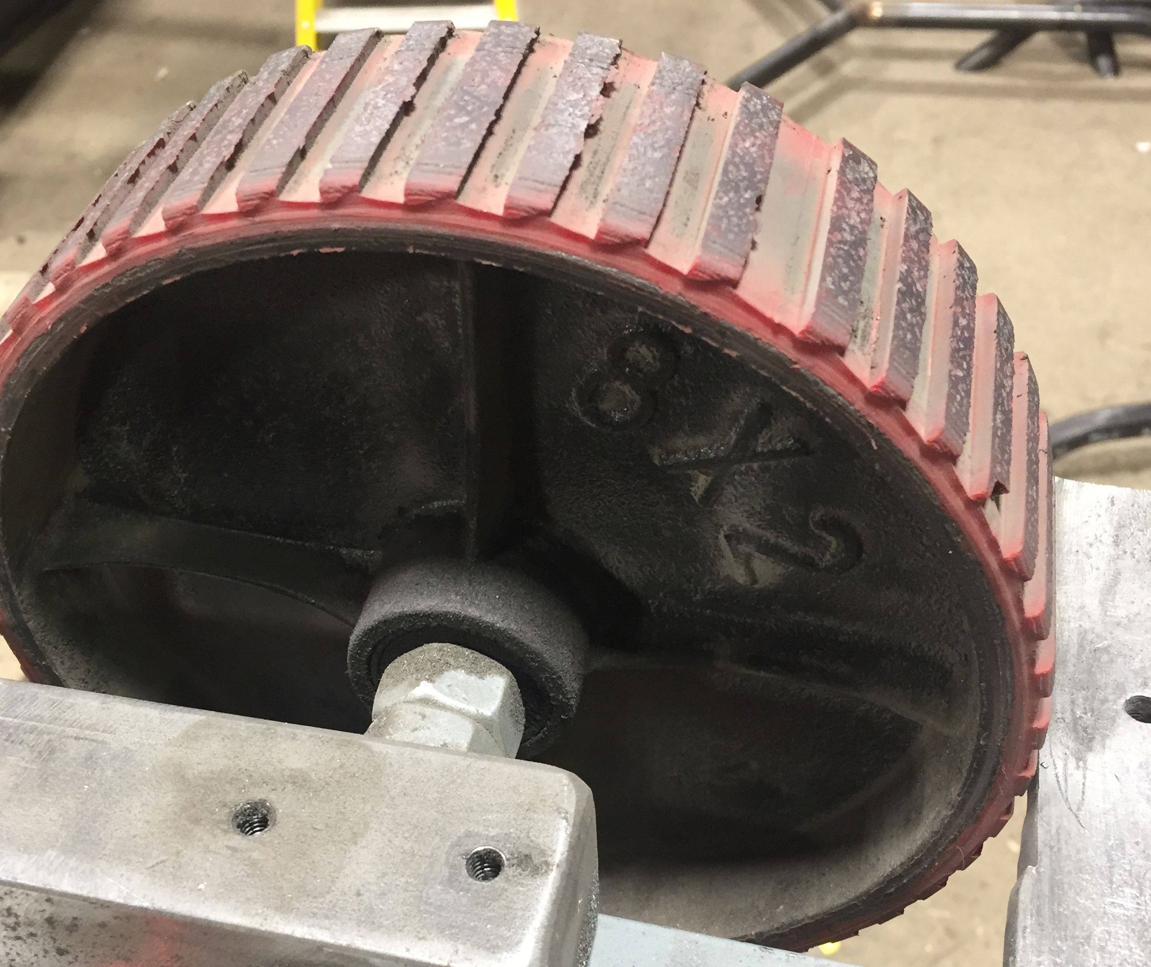

Machined Bearings into 8" Castor contact wheel
Attachment 16549

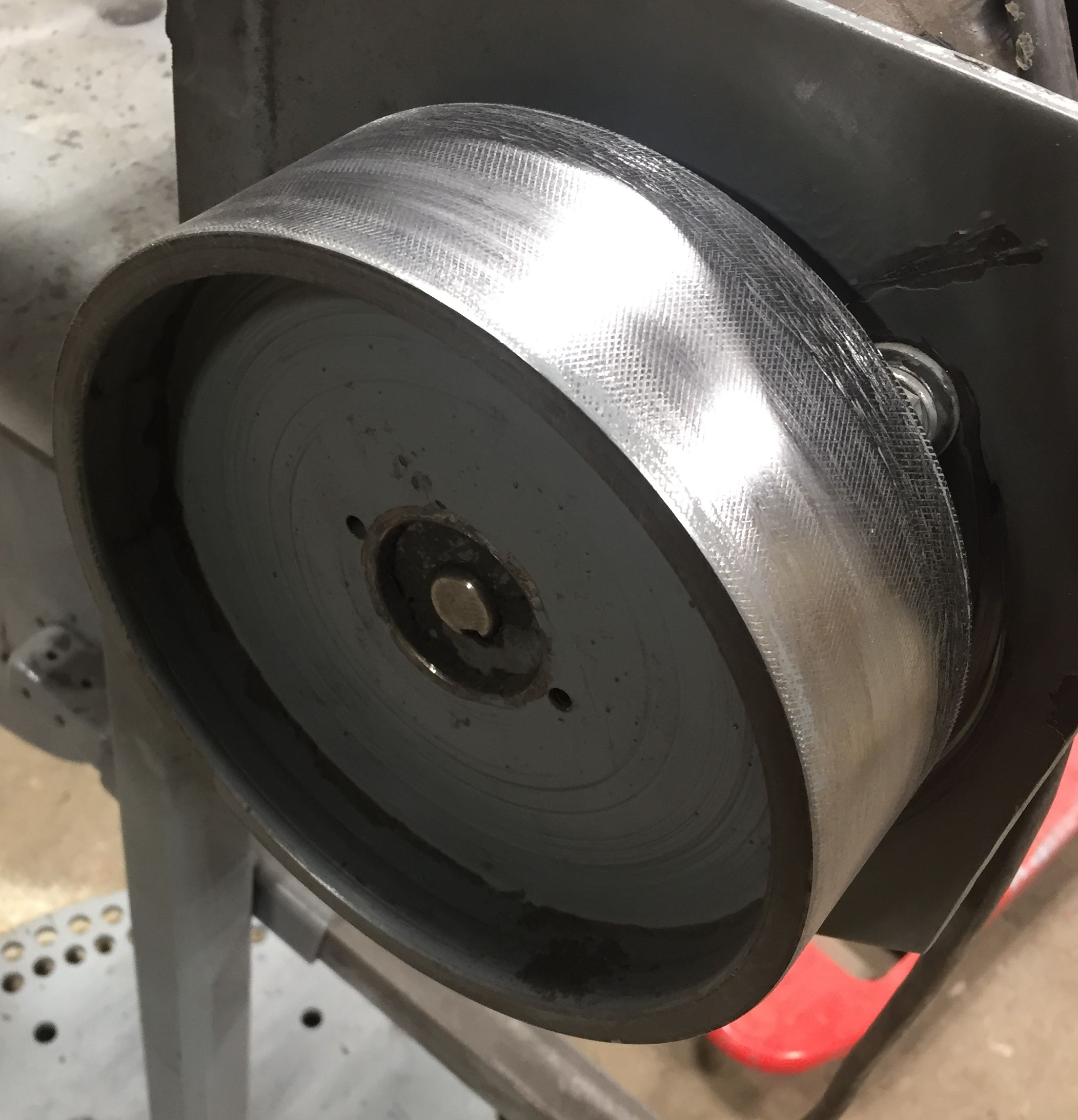

Machined and direct mounted a 6" Steel Drive Wheel
Attachment 16550

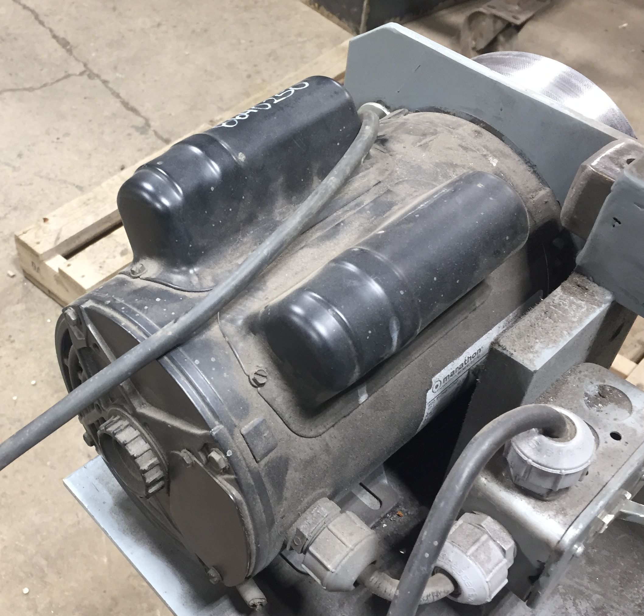

Used a 2hp 110Volt 3450 rpm Motor
Attachment 16551

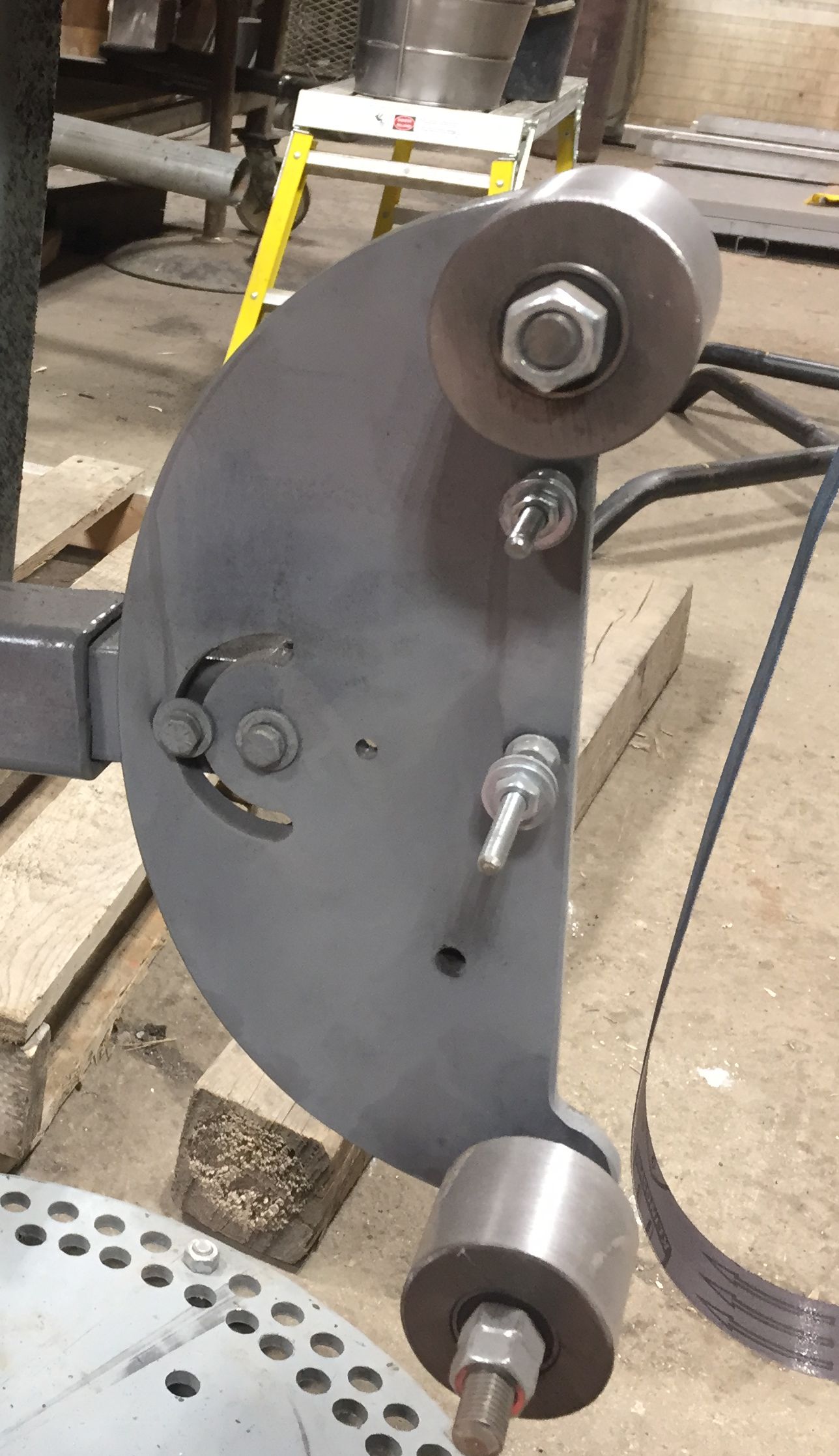

Made a adjustable degree Flat platen attachment
Attachment 16552

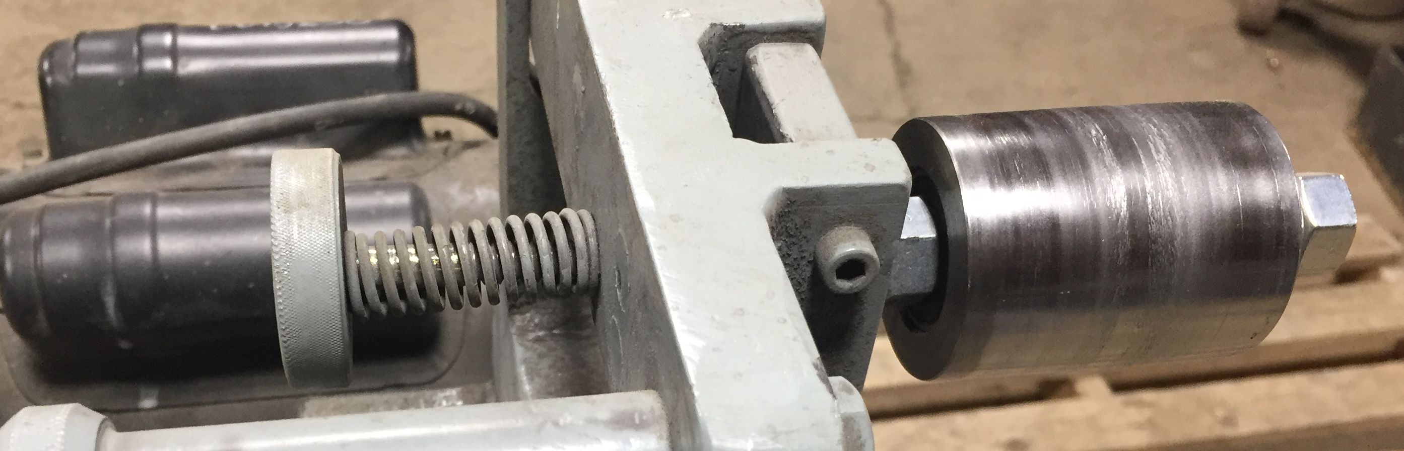

Machined a tapered Tracking Wheel for the tracking Mechanism
Attachment 16553

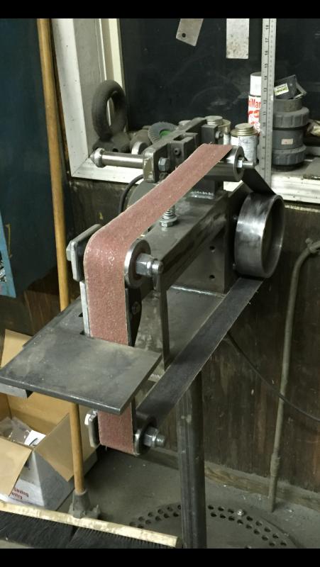

Yes, it is a KMG Clone!! LOVE IT!!:cool:
Is it completed?
Yes
Works awesome

Nice project. I have planned to make my own too. But im trying to find out how to make drive wheels etc. Without a metal lathe. Drill and angle grinder has been my solution so far. But its difficult to get balanced result.. I tried to make frame from the pipe and plate by welding them together, then machined with drill and angle grinder.
Works.. but result vibrates too much. Needs another try, but i think it might work.
Thanks for the pictures, got some usefull information from them.
Get a machine shop to do them for you
That is the critical part of these machines
