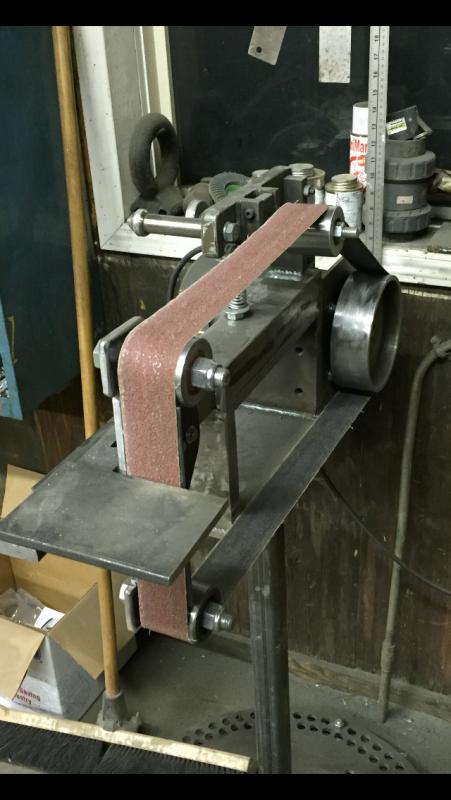

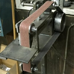

    2 by 72 belt grinder
    2 by 72 inch belt grinder

    Belt grinders are a favorite build around here. Do you have more pics or details you can upload?

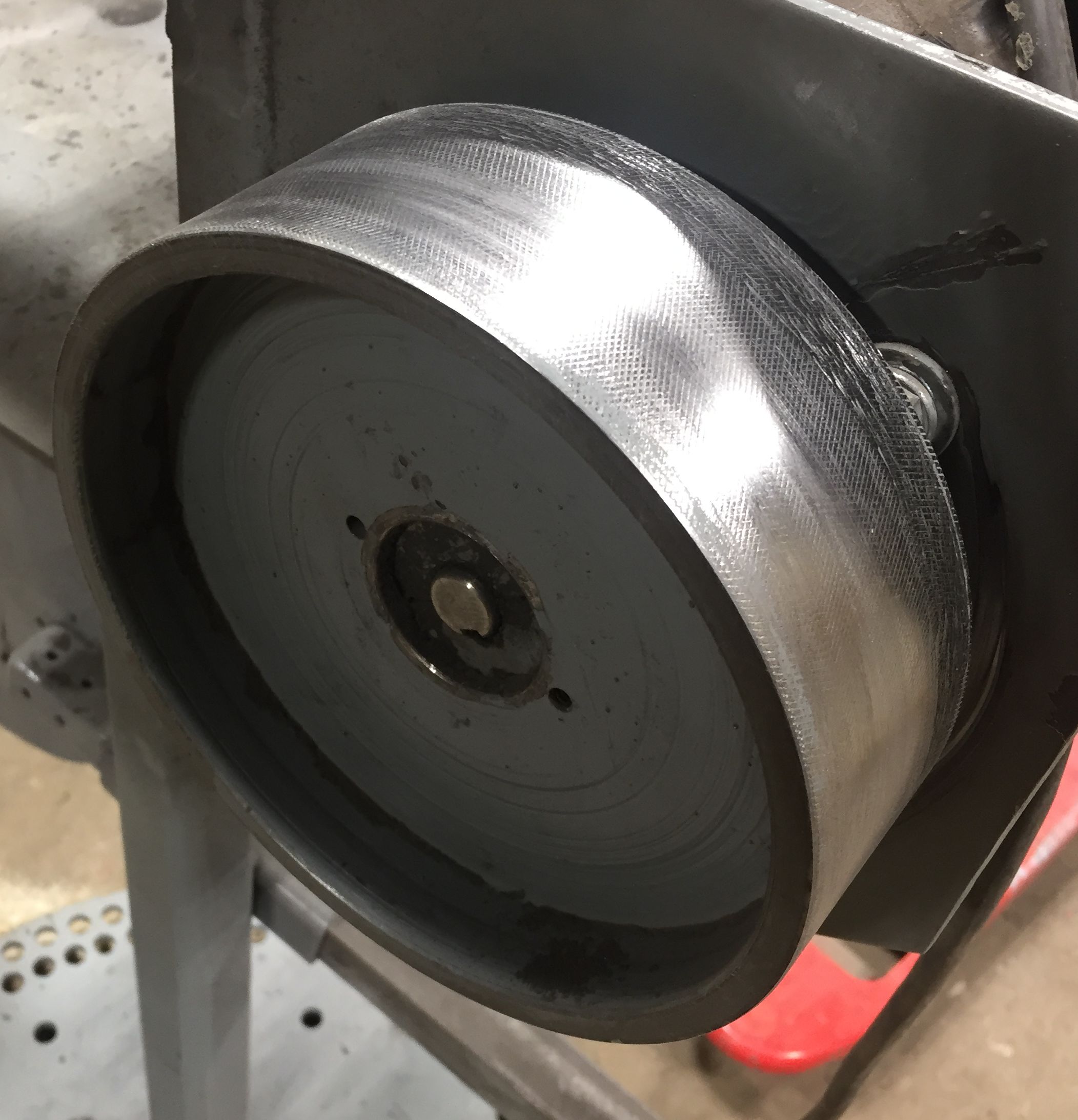

    More info on 2 by 72 Belt Grinder

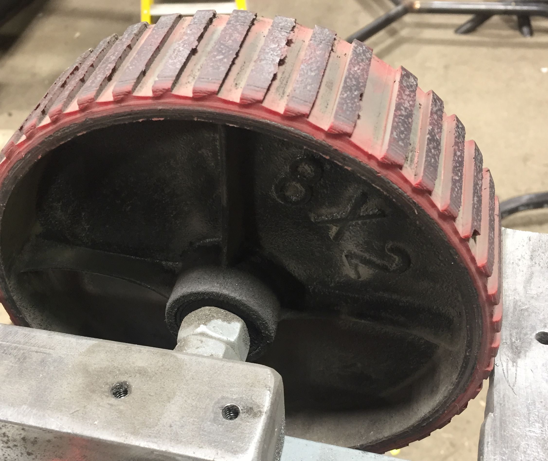

    Machined Bearings into 8" Castor contact wheel
    Machined and direct mounted a 6" Steel Drive Wheel

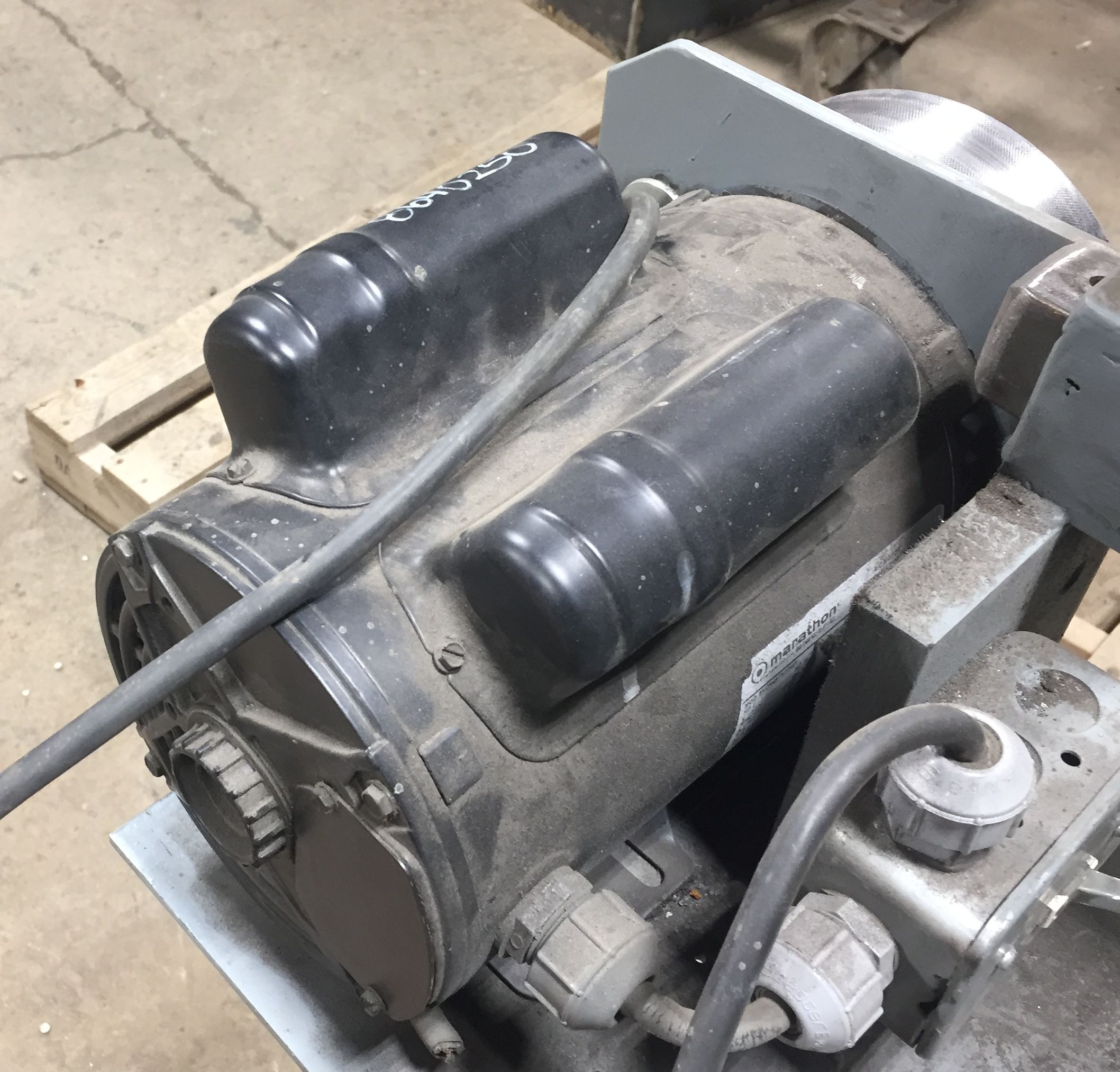

    Used a 2hp 110Volt 3450 rpm Motor
    Made a adjustable degree Flat platen attachment

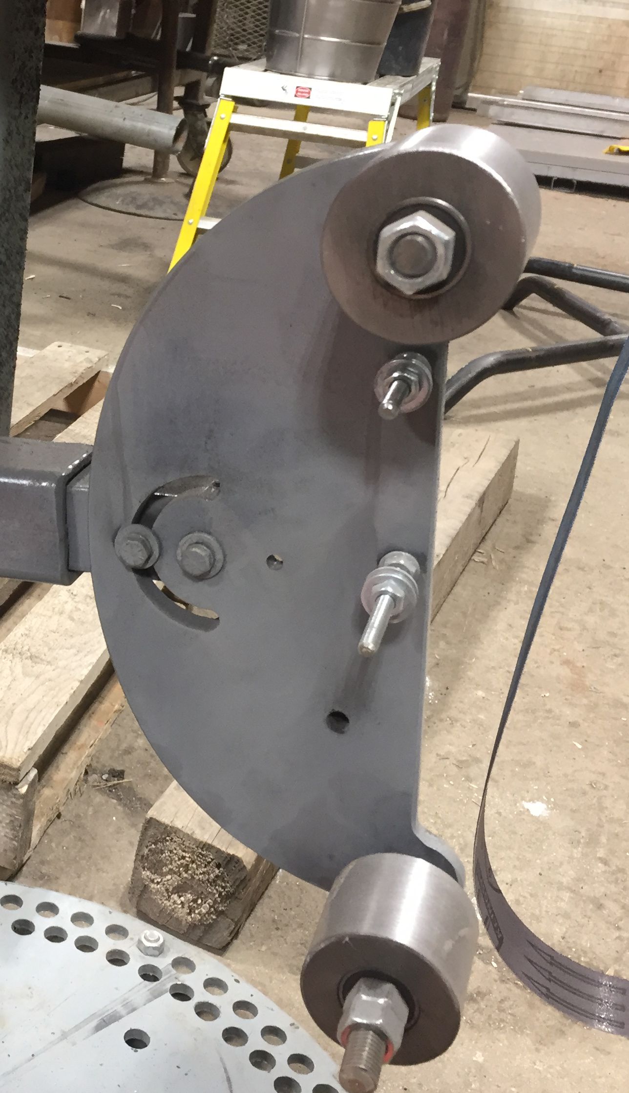

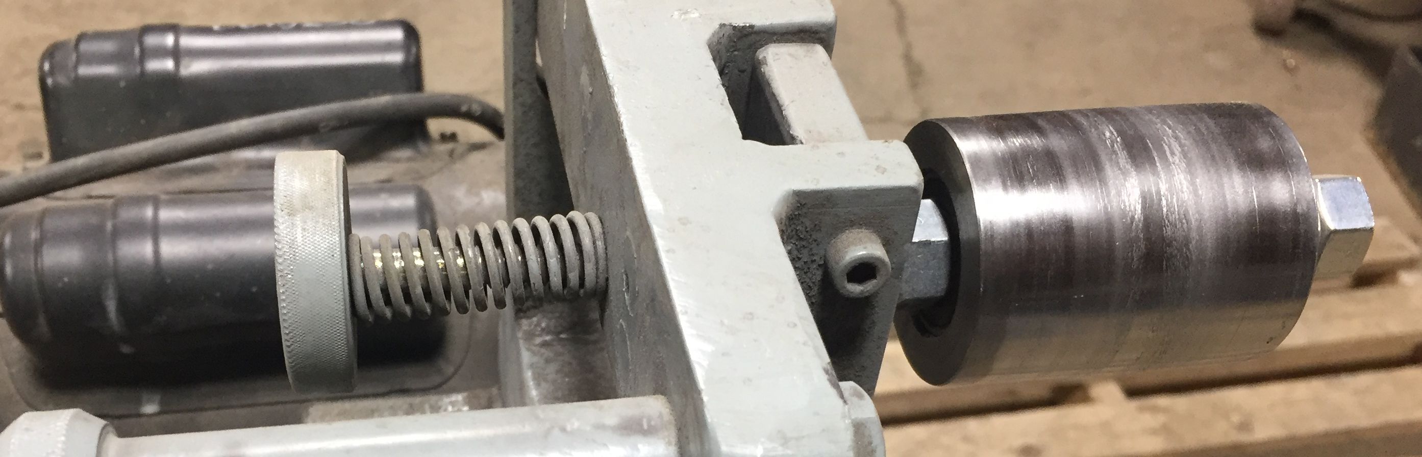

    Machined a tapered Tracking Wheel for the tracking Mechanism
    Yes, it is a KMG Clone!! LOVE IT!!

    Nice project. I have planned to make my own too. But im trying to find out how to make drive wheels etc. Without a metal lathe. Drill and angle grinder has been my solution so far. But its difficult to get balanced result.. I tried to make frame from the pipe and plate by welding them together, then machined with drill and angle grinder.
    Works.. but result vibrates too much. Needs another try, but i think it might work.
    Thanks for the pictures, got some usefull information from them.

    Get a machine shop to do them for you
    That is the critical part of these machines
