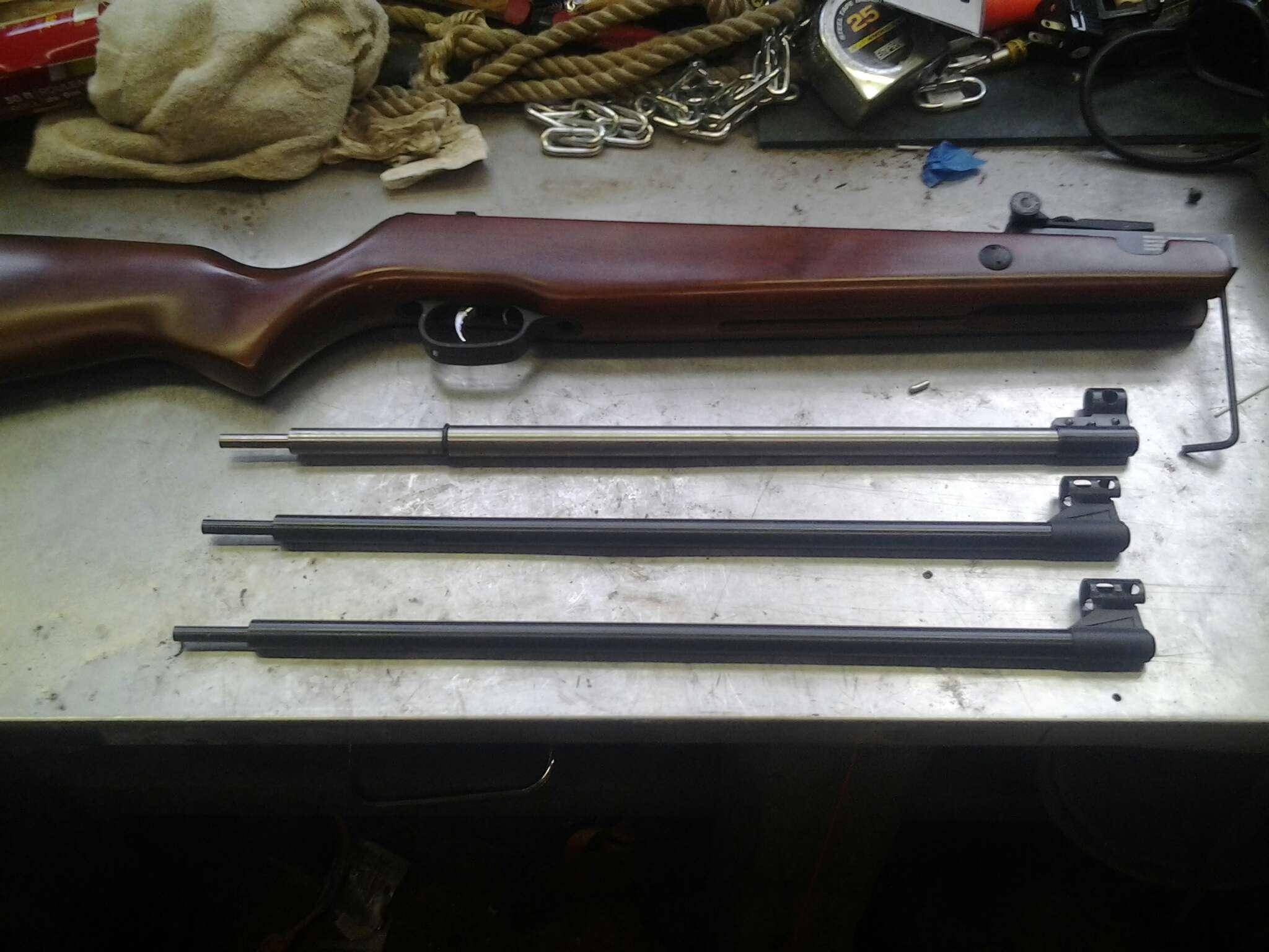

I have a Beeman Grizzly X2 pellet gun that I bought about 6 years ago at Wally World for $100. It has a .177 bb caliber pellet barrel and a .22 caliber pellet barrel. One allen set screw loosens up and you switch barrels. This would work good on the buggers if it was a shotgun.....
I had 3 Savage barrel blanks for the model 42 O/U 17 HMR/410. I've taken many squirrels for pot pies with the Beeman with the 22 barrel so this should work if I bore out the rifling from 17 to 22 cal and leave it smooth bore.
I cut off 5 inches of the fat end of the blank and chucked it up in the lathe. Then I turned it down to fit the barrel block and turned the spout that fits the seal. Then I turned the muzzle end to fit a front sight I had left over from a failed Chinese bb gun experiment(I'll never tell).Attachment 11441

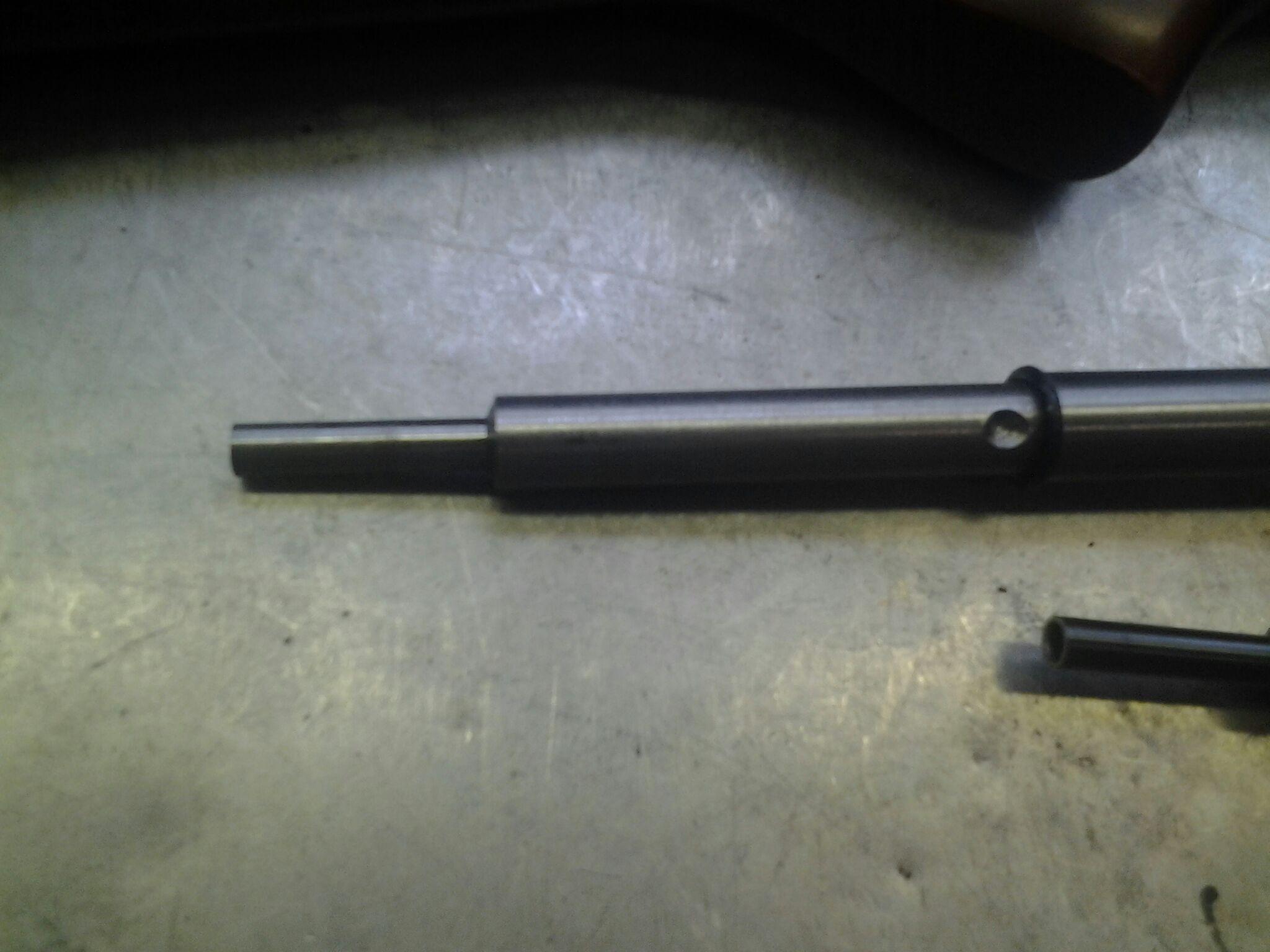

Next step was drilling the locking/aligning dent in the side.
I put an "O" ring in the barrel block and squeezed it tight and marked the barrel for the lock dent and pulled it out and drilled the dent.

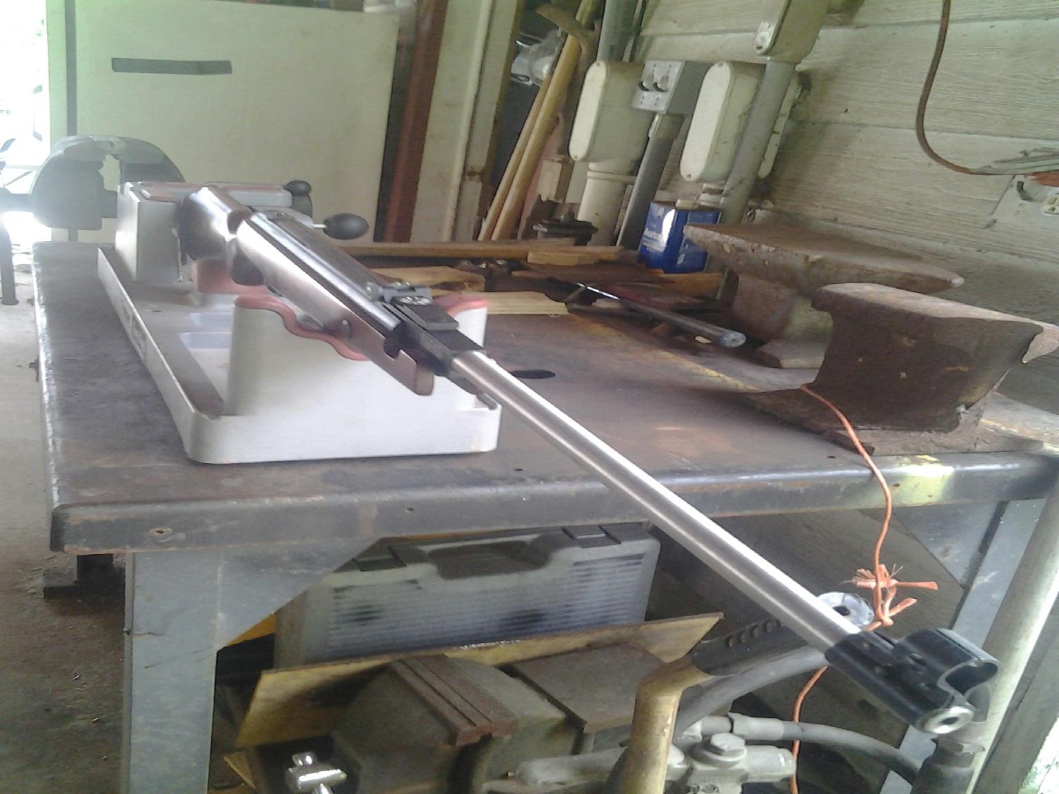

Next I bought a 16" drill bit from victor machinery for about $9.00 and drilled out the barrel. The bit is (I believe) .2184 and left me room to polish the bore.

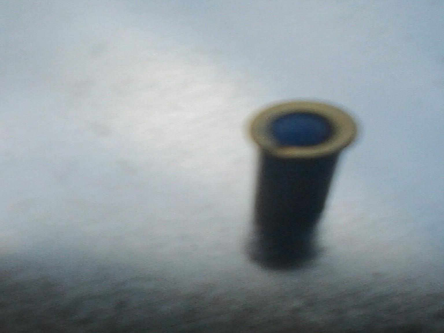

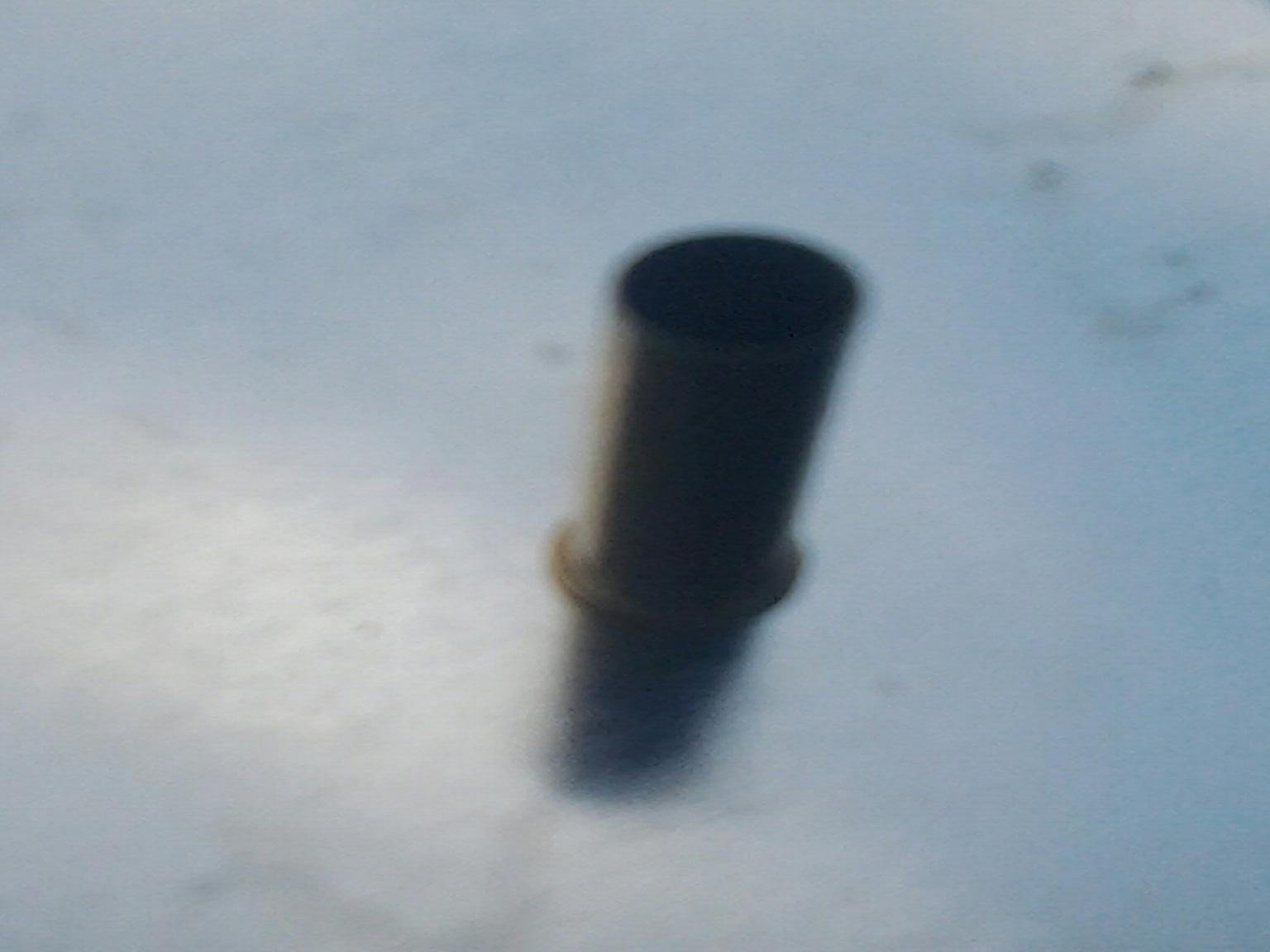

Next step was chambering it. I wasn't worried about the shell casing sealing as there are 2 O-rings to take care of that. I drilled it with a C bit to depth in the lathe and the barrel was done.Attachment 11442

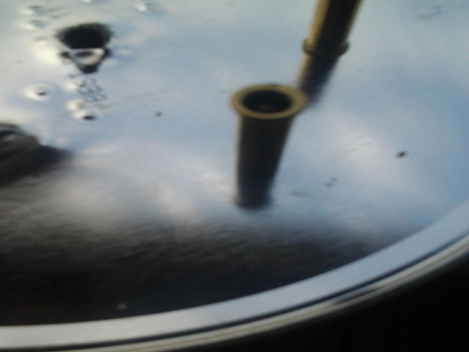

Time to make some shells and try it. I took a box of 22wmr empty cases(finally found a use for them) and drilled the back out with a center drill to get a flow channel. Coffee can plastic lids are the under and over shot wads and a 1/8" felt under shot wad seals the barrel. I use #9 shot and only use a 22lr case for a measure. 30 pellets per round.Attachment 11443Attachment 11444Attachment 11445Attachment 11446. The third pic is a slug(22 cal pellet).

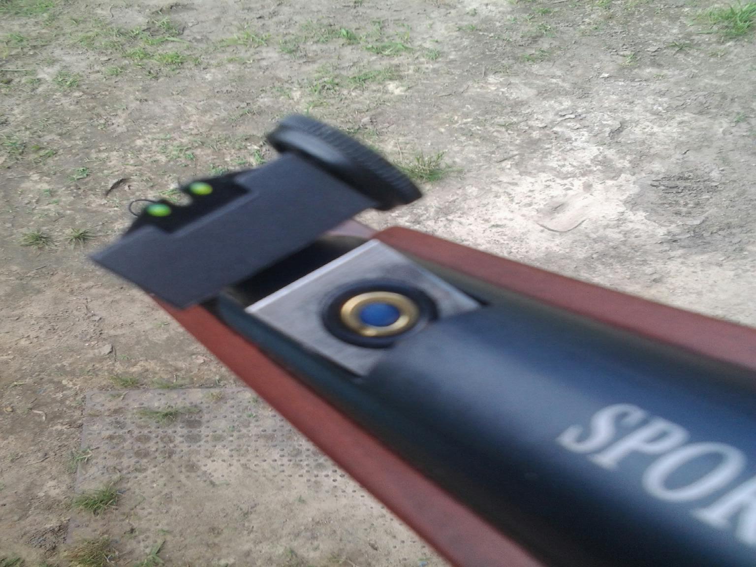

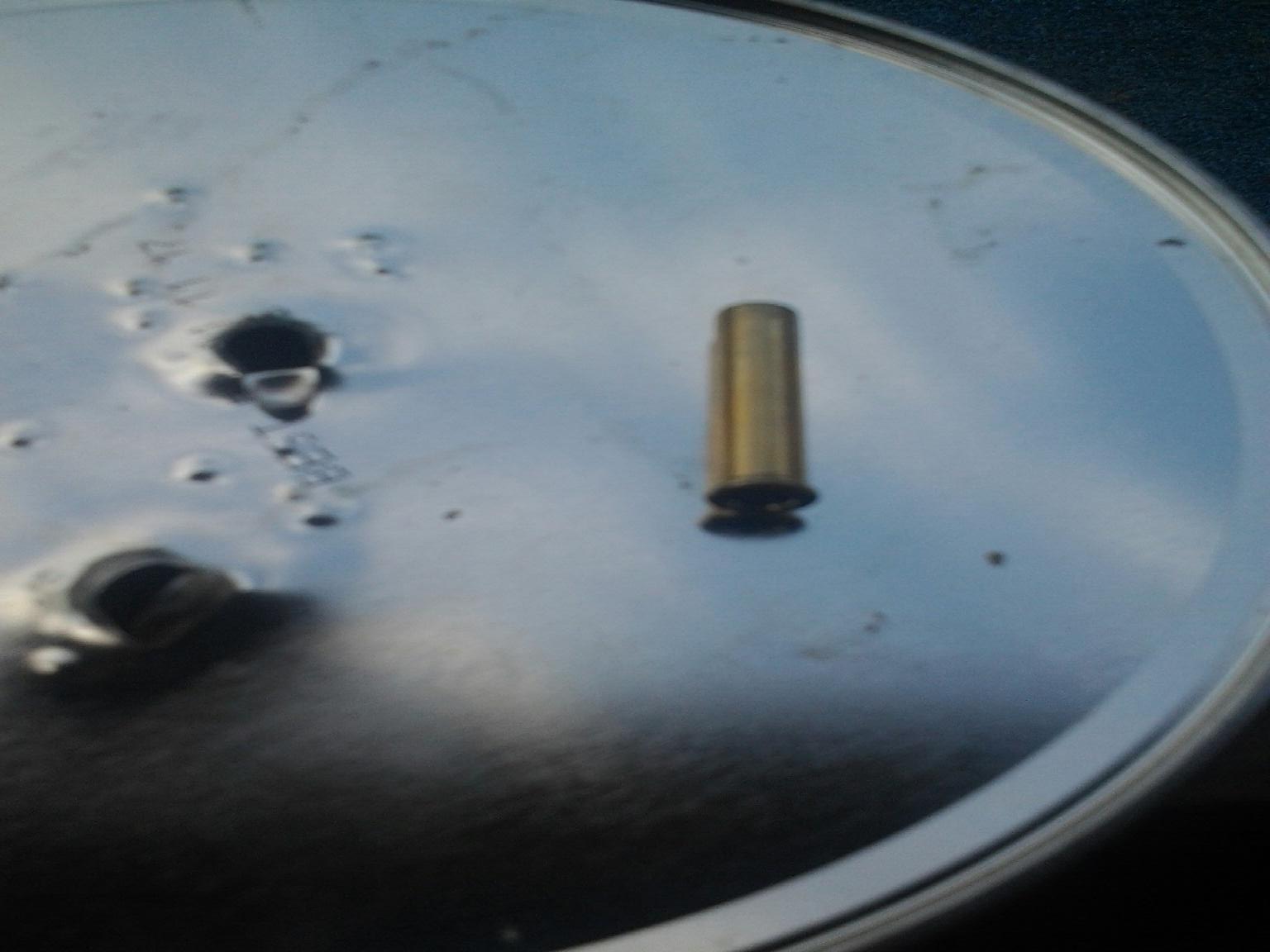

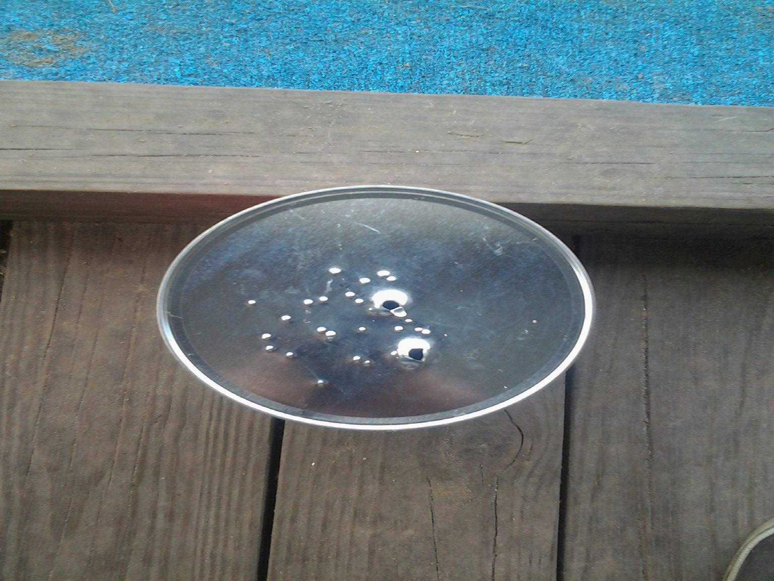

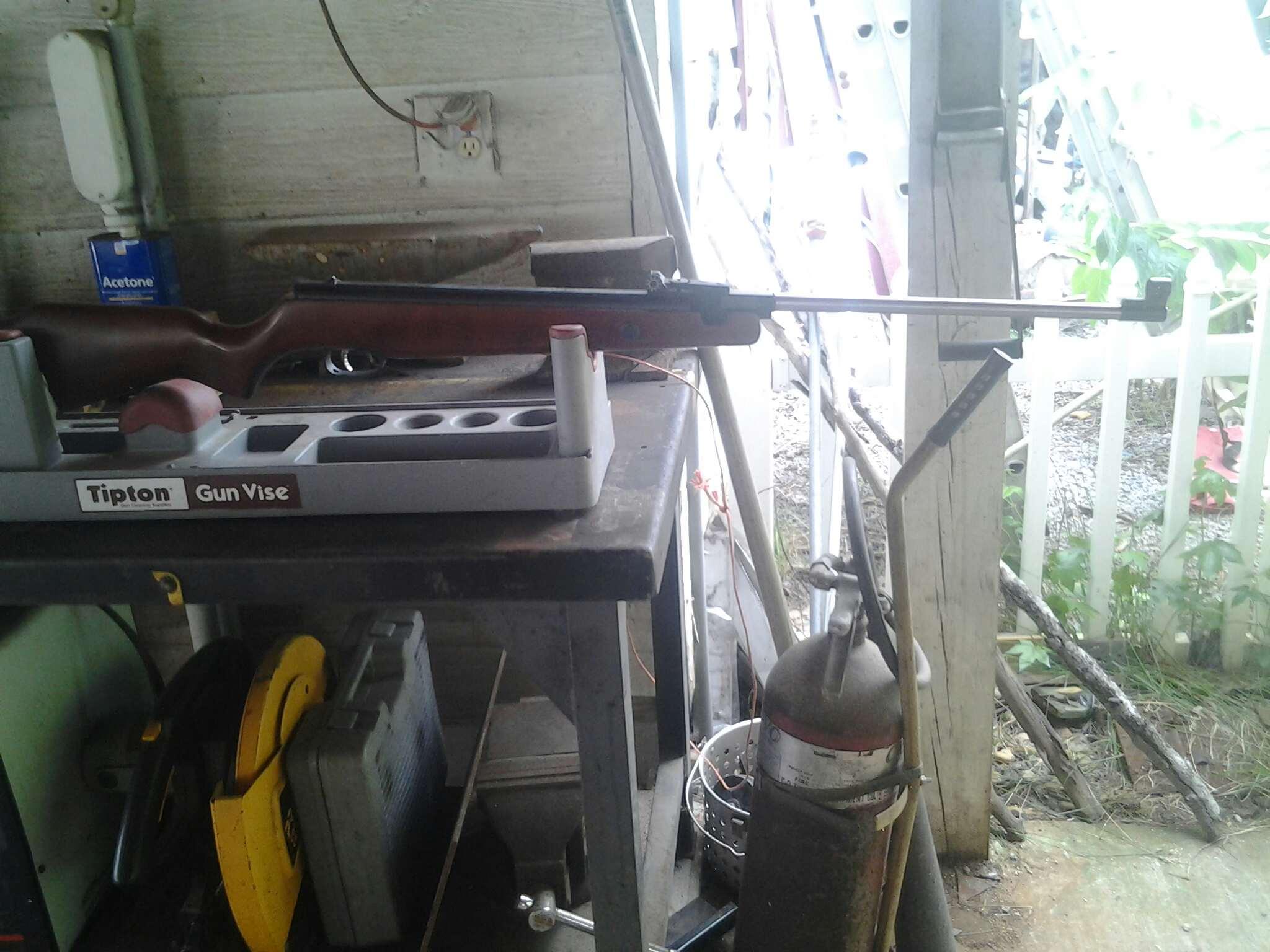

These destroy the big bees with the shot. No special reloading equipment needed. Here's the gun and a coffee can it was tested on.Attachment 11447Attachment 11448Attachment 11449Attachment 11450The 2 big holes were slugs. I have fun with the grand kids with this.
