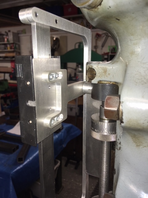

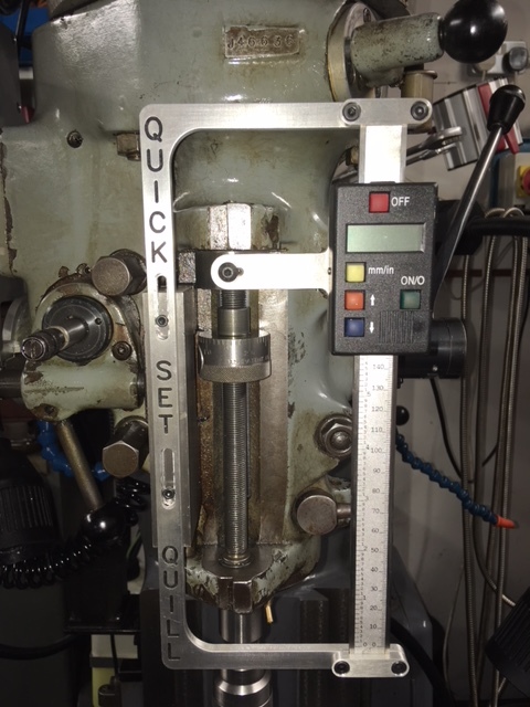

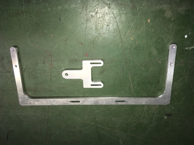

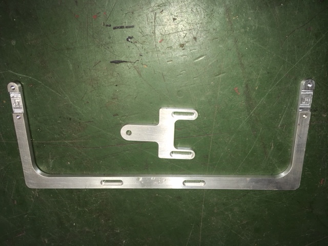

Hi All
I made this simple bracket to fit my Bridgeport Mill Quill. This is a very useful and quick setting tool. Yes, you can buy a commercially made one but at £200 plus they are not cheap. So, I decided to make one. The digital readout itself was an eBay buy at £34 and the aluminium was just some off cuts from another project. I also had to buy some longer UNC screw to attach the bracket to the mill. In total about £50 all in. (not taking in consideration my time, which I consider to be free as this is one of my hobbies) I did engrave the text on the bracket on a friends machine.
I am also going to fit one, to the lathe tailstock in the near future just need to decide how I want to mount it.
Attachment 21512Attachment 21514Attachment 21512Attachment 21515Attachment 21513
