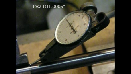

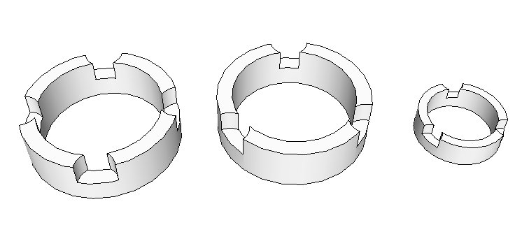

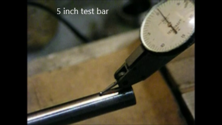

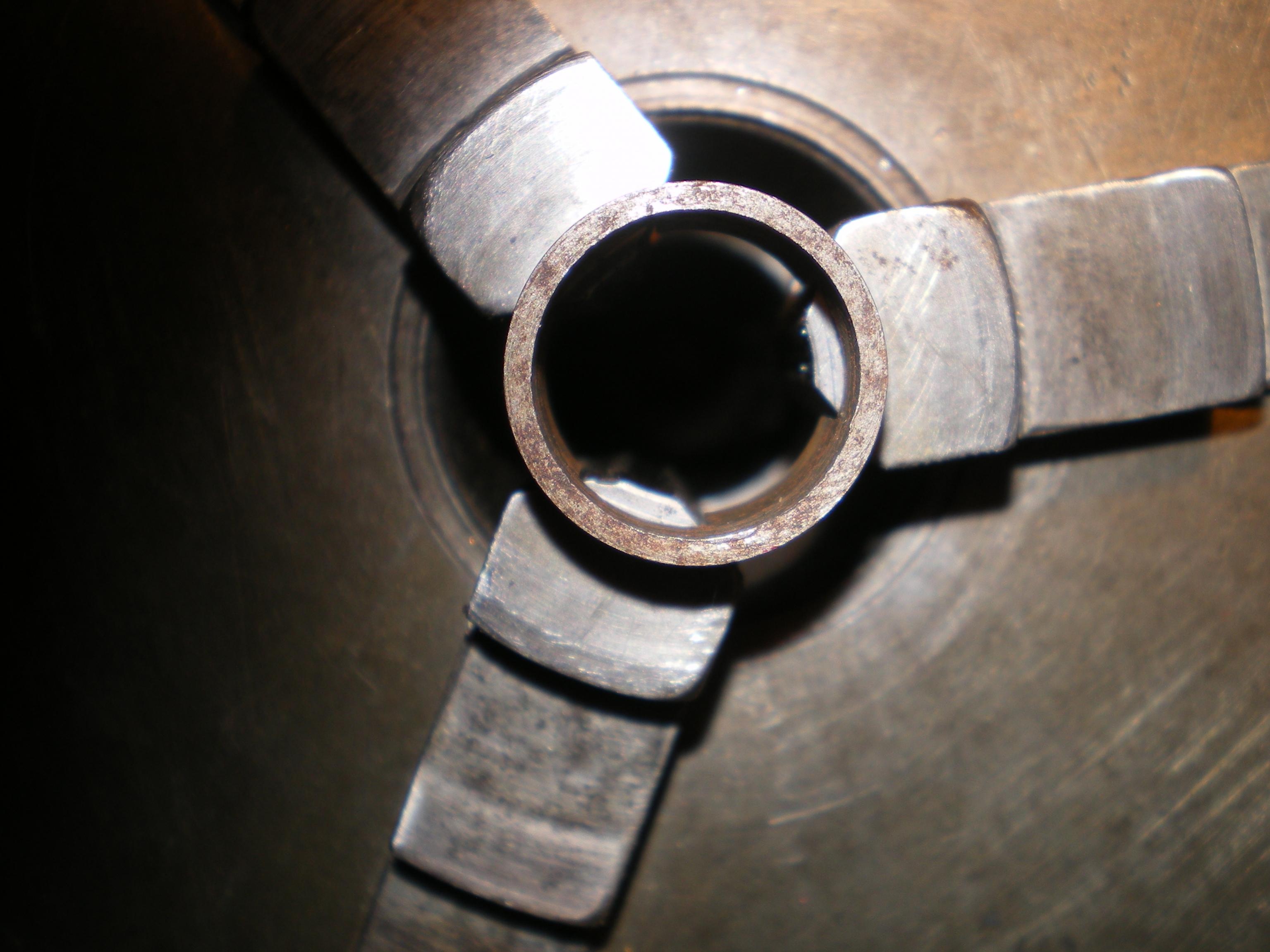

    Do you have a worn chuck that is only gripping on the back of the jaws, here is a way to fix it.
    This simple tool will do the job if your chuck has hardened jaws, by gripping the jaws by the front only (where most work is done) while allowing a grinding wheel access though the length of the chuck.
    My 50 year old 5 inch 3 jaw will grip a 5 inch long test bar with the same run out at the end as at the jaws (usually within a thou) after this treatment.

    Thanks olderdan for posting this. I'm not a trained machinist so there's no disapproval here. But my impression of being a machinist is not only a constant creative application of what you have to do the job at hand, but also to make the tooling to repair and improve your equipment.
    So this is to me a novel way to true the jaws. I saw Mr. Pete take a ring and put it on the outside of the jaws and open them to tighten then grind them. As a FNG/noob can you give details how to make your rings because they obviously need to be done accurately. Or is that going to be in your plans for sale?

    Thanks C-Bag, not a lot wrong with your definition of a machinist.
    No need for great precision in making the rings as they only have to stop the the jaws from moving and simulate gripping a diameter.
    You could at a pinch make one from tube with the cut outs sawn and filed, the accuracy comes from the chuck itself.
    You mention using a ring on the outside to do this, the problem with that is the jaws tilt inwards at the front whilst grinding, ending up with the condition you started with of only gripping on the back of the jaws when holding a shaft.
    Hope that makes sense.

    A register usually refers to a radial location diameter where a taper is not used I.E. screw on chucks, the thread hold it on, the register aligns it.
    The test bar can be anything you know to be parallel and straight, the one I use most often is a 1/2 inch dowel 5 inches long, these are centerless ground and case hardened and quite cheap
