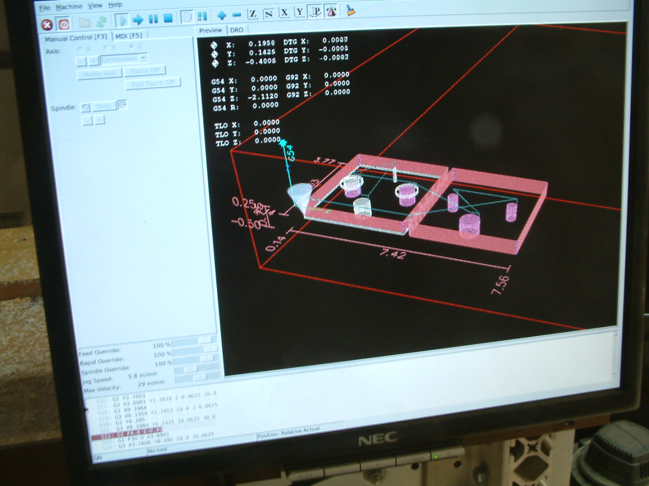

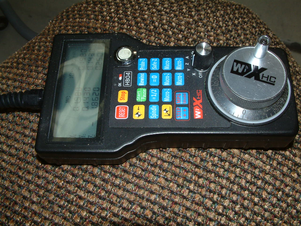

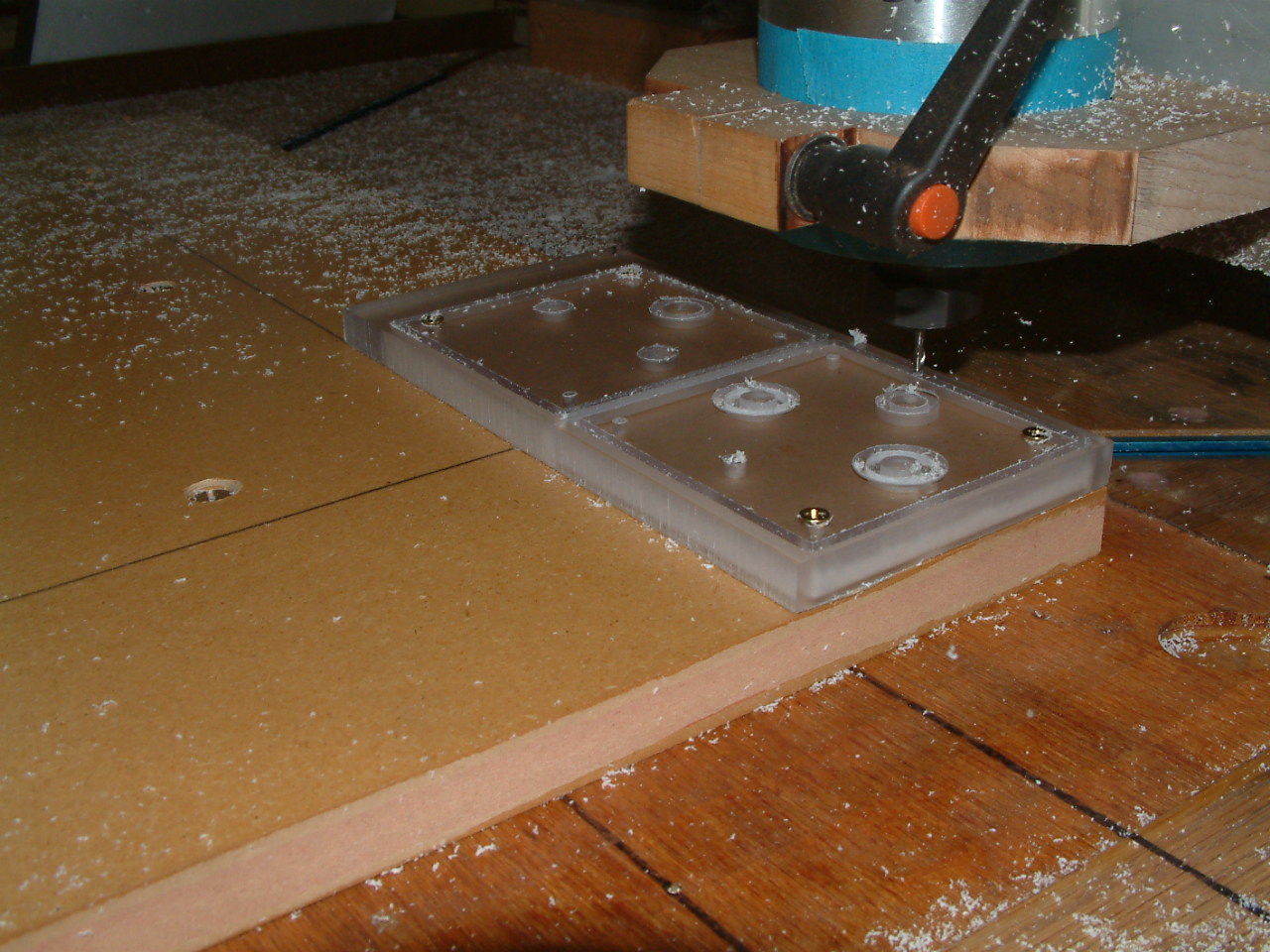

    I wanted to make startup a bit faster when setting up my CNC machine so I found this pendant on the bay and oh what a difference a pendant makes.
    I upgraded to Linuxcnc v 2.7.0 and after setting up to run my cnc I added the config changes to run the pendant.
    Now instead of having to make multiple trips to the control side of my machine I can quickly move all axis to the zero point and then easily home it and touch off the Z-axis. I can now control the speed of traverse, which axis to move, or even move all of them to zero with one click of a button.
    The panic button is right on the pendant also. I have not implemented all of the buttons available but I have what I need.
    Very nice upgrade. I ordered the HB04 wired unit USB not wireless. I like the direct connect and the cable does not cause me any difficulty.
    The rf version for the USB port is available in the WHB04 model.
    You will have some digging to do into Liniuxcnc to set it up. It takes a bit of time to get it running.
    Here are a few screen shots:

    MPG pendants are nice. The way I have my machine setup now the keyboard is right there. So jogging with it is not too bad for me. I made a remote box with the power switch in it too. So it is kind of my E stop. It is my on and off button really. I've never had an emergency, yet.
