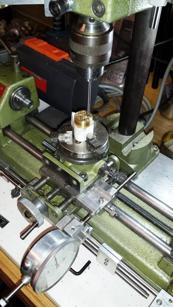

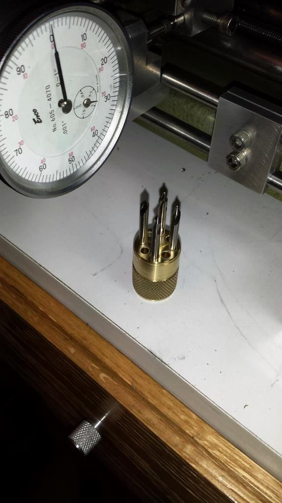

One of the website articles is for a brass stand for holding the very small Keo combination drill and countersinks which all have body diameters of 0.125". I made my stand from 3/4" dia. C360 brass rod and performed the knurling on my 7" swing mini lathe. The brass part is 0.740" dia. by 1" tall and drilled with eight 0.125" dia. and evenly spaced holes that are 0.4" deep.
Attachment 19029
The brass stand is photographed on my Unimat SL 1000 where I used a small Unimat dividing head to drill the evenly spaced holes. The drilling used a homemade depth stop on the milling head to consistently drill to 0.400" deep (the end of the depth stop can be seen in the upper right of the middle photo).
