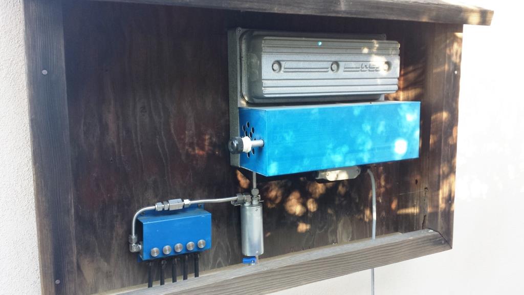

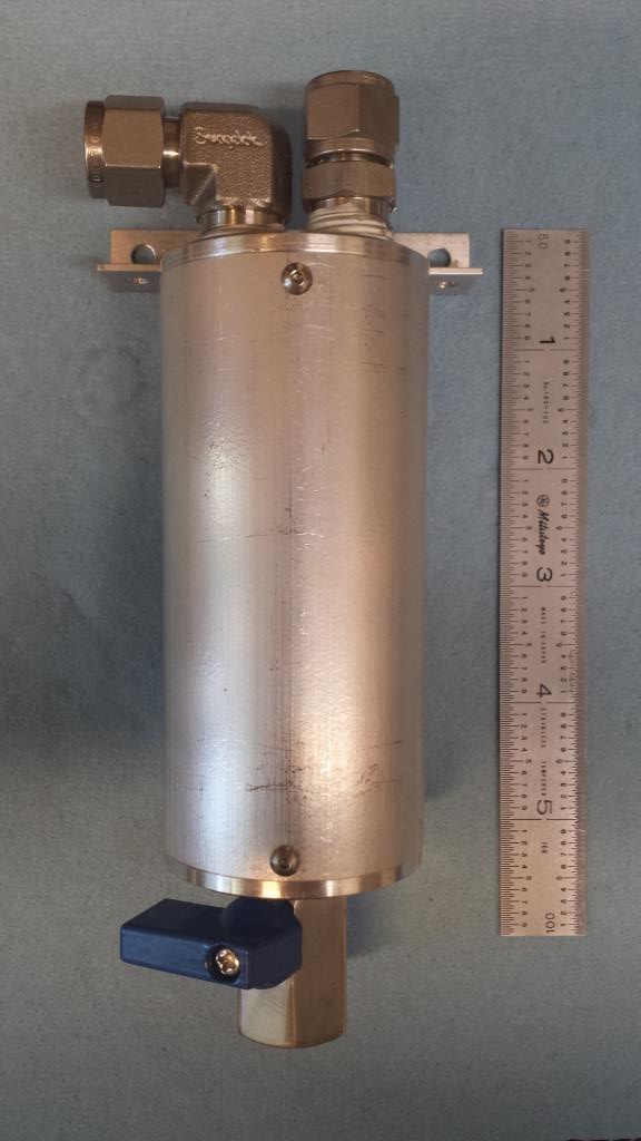

    In addition to the normal pool chlorination, my pool uses an ozone generator and injection system originally manufactured by Del Ozone but has been modified over almost twenty years with improvements of my own (for examples of ozone systems for pools see Residential Pool Sanitation | Pool Ozone Generators by DEL ).
    The system has been in use for many years but over time it has problems with clogging the needle valves on the ozone distribution manifold. The needle valves become clogged over time due to too much water in the compressed air and ozone mixture. We live in Southern California where the relative humidity is low but the accumulation of water occurs on the days with foggy mornings.
    I solved the problem by building a small water trap similar to those used for air compressors. The ozone version uses stainless steel and silicone o-rings that are far less reactive with the ozone. The design used a double set of o-rings where the first o-ring blocks the o-zone from coming into direct contact with the second o-ring. The silicone o-rings are better suited for exposure to o-zone than the ordinary Buna o-rings. The 316 stainless steel fittings are made by Swagelok.
    Below are photos of the complete installation and construction.
    Compressor water trap and drain for pool ozone system-pool-ozone-system-water-trap-drain-installed.jpg
    The ozone generation system uses a u-shaped high intensity UV lamp (housed in the aluminum housing with three bolts) and a small Gast compressor (housed in the blue powered coated enclosure ) to activate the compressed air with ozone.

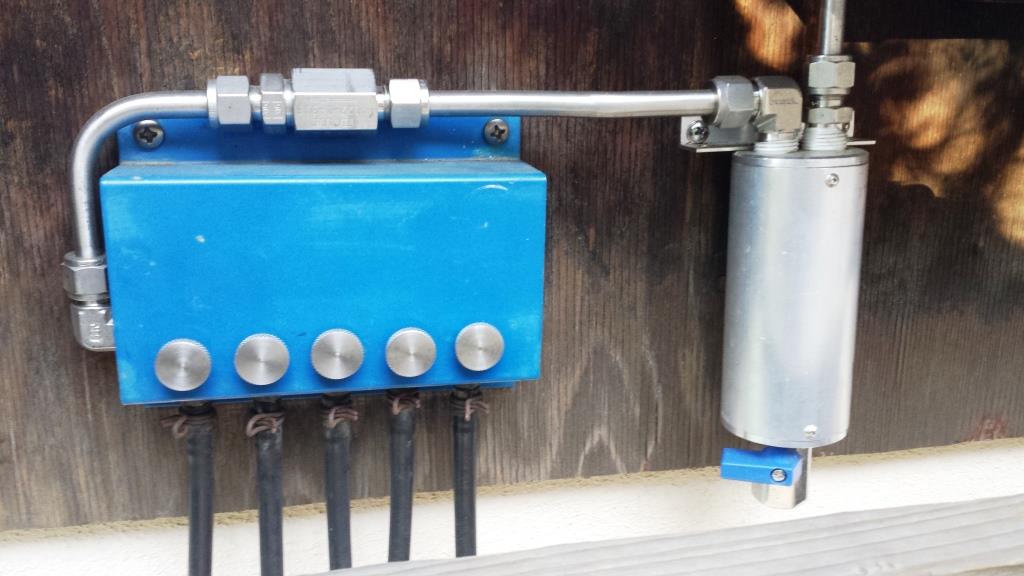

    Compressor water trap and drain for pool ozone system-pool-ozone-system-water-trap-drain-attached-ozone-distribution-valves.jpg
    On the right is the water trap and on the left a manifold with five stainless steel needle valves. I replaced the plastic needle valve knobs by making knurled stainless 303 knobs press fit onto the needle valve stems. The check valve above the manifold ensures the compress ozone can build-up pressure in the pool and spa injection pipes, and the piping is connected to bubble diffusers at the bottom of the pool ans spa water for generating very fine bubbles into the water columns of the pool and spa.
    Compressor water trap and drain for pool ozone system-compressed-air-ozone-water-trap-drain.-assembly.jpg
    Assembled trap for the compressed ozone and air mixture. The 316 stainless steel fittings are from Swagelok.

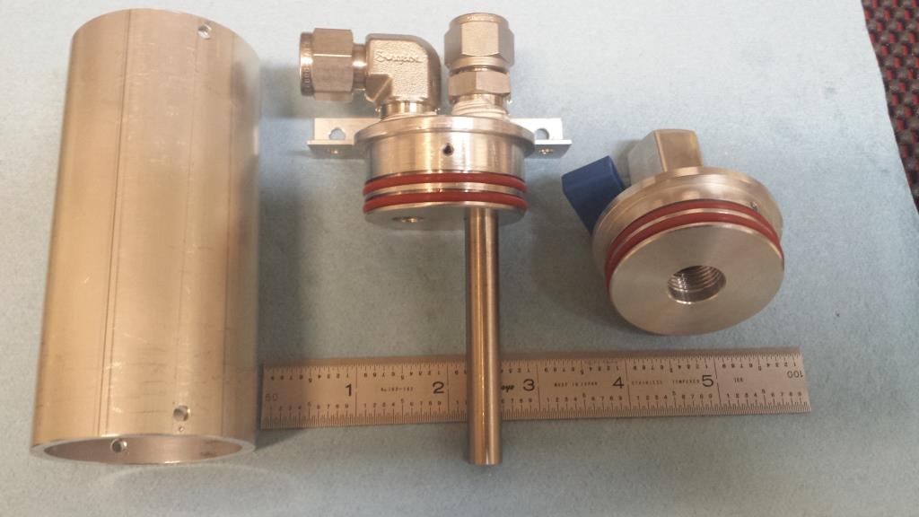

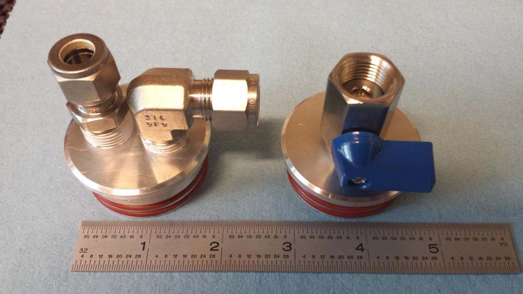

    Compressor water trap and drain for pool ozone system-compressed-air-ozone-water-trap-drain.jpg
    Parts of the water trap are machined from 6061-T5 aluminum and 3/8" 316 stainless steel tubing. The end caps use silicone o-rings and held in place with 4-40 stainless steel button head screws. With 20-20 hindsight, I should have placed the button head screws on the right and left sides of the trap so I could remove the trap without having to disconnect the compressed tubing fittings to access the button head screws at the rear.
    Compressor water trap and drain for pool ozone system-compressed-ozone-water-trap-drain-end-caps.jpg
    Detailed view of the end caps with 3/8-18 NPT to 3/8" compressed tubing 316 stainless fittings.

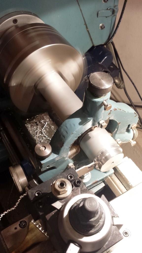

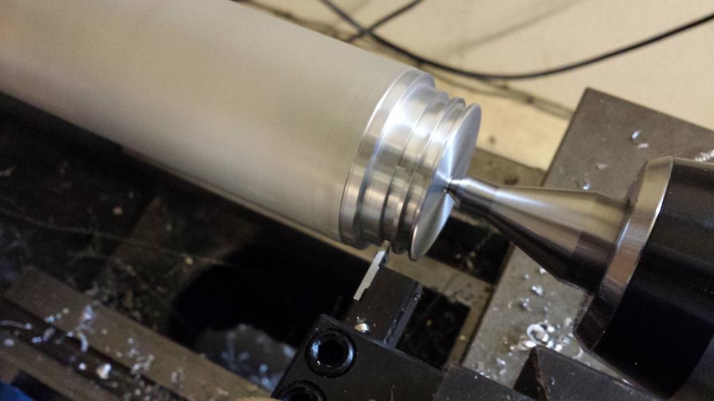

    Compressor water trap and drain for pool ozone system-iscar-parting-off-end-cap-support.jpg
    Parting off the end cap after machining the o-ring grooves with a Nikcole insert grooving tool.

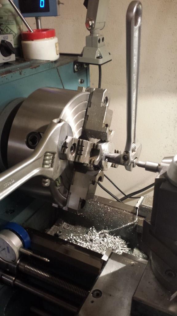

    Compressor water trap and drain for pool ozone system-hand-taping-pipe-threads-into-end-cap.jpg
    Hand tapping the 3/8-18 NPT threads in the lathe chuck with the end cap held in an aluminum ring to prevent damage to the o-ring grooves. If I did this again, I would have pre-machined the taper in the pipe thread hole using the lathe compound to make taping easier and machined the end in the other direction.

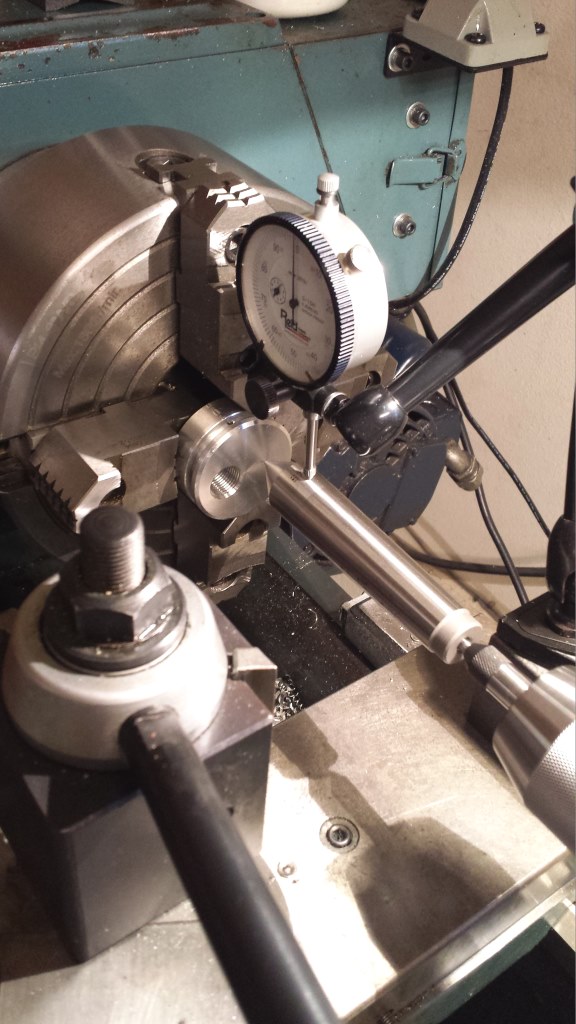

    Compressor water trap and drain for pool ozone system-locating-second-hole-pipe-thread-end-cap.jpg
    Setting up the hole offset for drilling and boring the second 3/8-18 NPT thread hole.

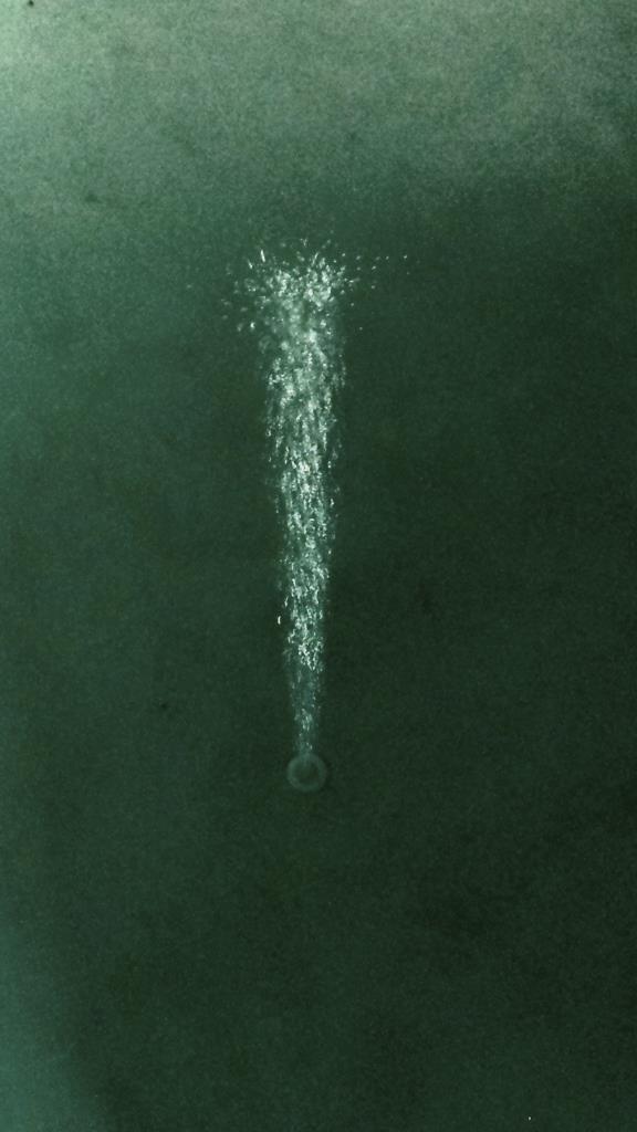

    Compressor water trap and drain for pool ozone system-ozone-dispersion-head-pool-deep-end-night-time.jpg
    Nighttime view of one of the ozone diffusers bubbling the ozone into the water column. The ozone is very active and bounds with organic impurities before reaching the water surface. The pool bottom is pure white plaster and very clean but in the night photo appears with a gray-green tone.

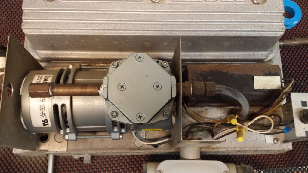

    There is a logical order in the way the older style Del Ozone systems generate ozone. I have a fine stainless steel mesh covering the air intake tube (made from a drip watering irrigation filter) to the left of the Gast compressor to prevent insects from being sucked-in and eventually having the bug parts clog the needle valves. The air goes into the small compressor and out the compressor at 30 psi and into the first check valve before entering the 16"x4" chamber with the U-shaped very high intensity UV lamp (the first photo above shows a small lavender glowing dot on the the UV chamber wall and that is a small quartz window showing the UV lamp is turned on and not burned out).
    The downstream back pressure from the ozone slowly going through the diffusion blubbers at the bottom of the pool causes the compressed air to remain long enough in the UV chamber to help generate ozone. The ultra-violet (UV) light creates ozone when a wavelength at 254 nm hits an oxygen atom. The molecule [O2] splits into two atoms [O], which combine with another oxygen molecule [O2] to form ozone [O3]. The O3 Ozone is a powerful oxidant and reacts well with heavy metals and organic materials in solution in the pool water column and causes chemical bonding by taking the materials out of solution permanently and trapped by pool filtration.
    Today almost all ozone systems use corona discharge to produce ozone (similar to why you smell ozone after a lightening strike or a short circuit with an flash arc discharge). The active ozone never goes through the compressor because the UV lamp is downstream from the compressor and a check valve prevents the ozone from backing up into the compressor when the compressor is running or shut down. Below is a photo of the small Gast MOA compressor before I replaced all the tubing with 316 stainless steel 3/8" tubing. The rusty rectangular box to the right is the high voltage transformer for the UV lamp.
    Compressor water trap and drain for pool ozone system-gast-moa-compressor-del-ozone-system.jpg
    I hope this helps to explain how the system works.
