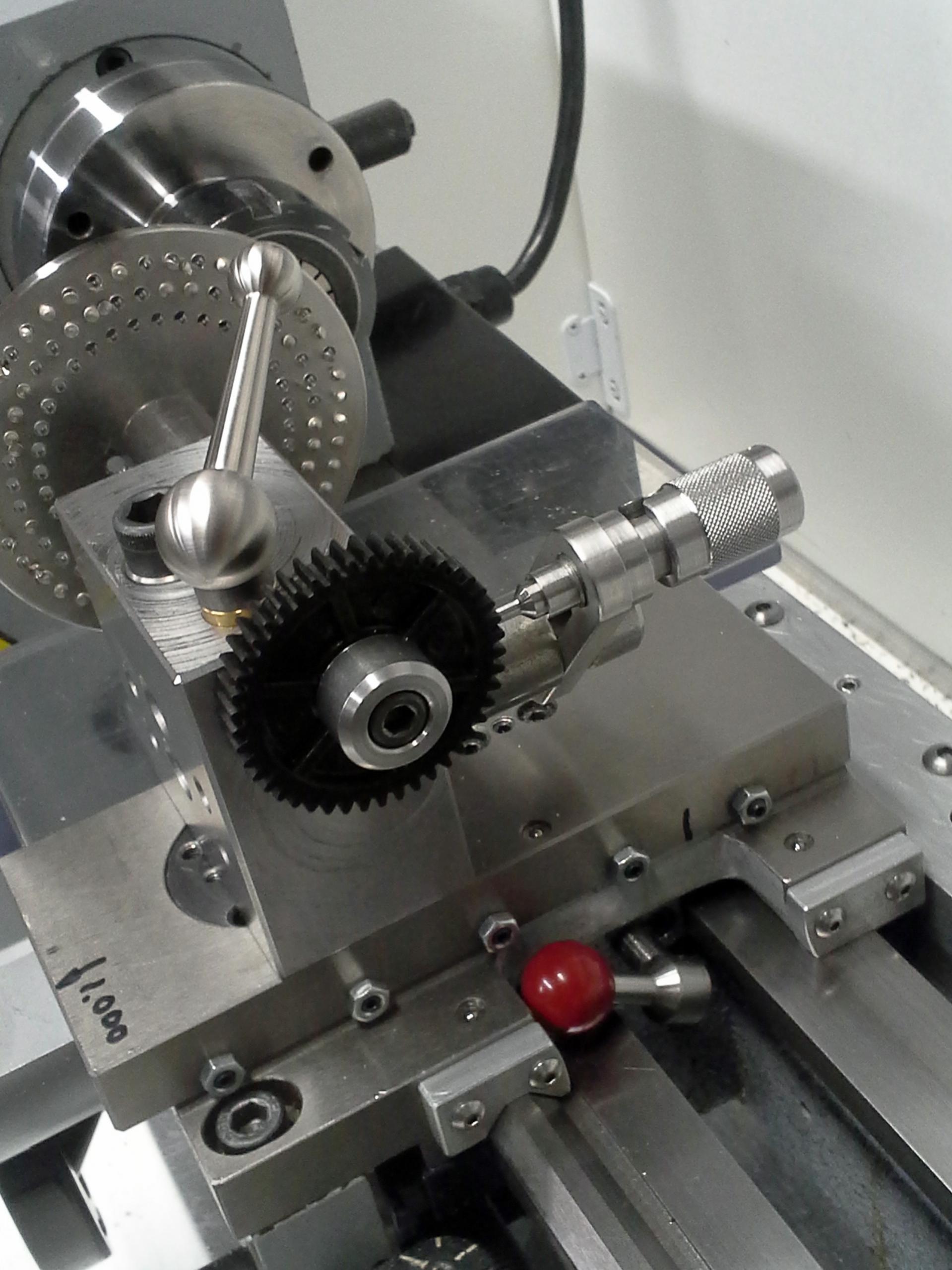

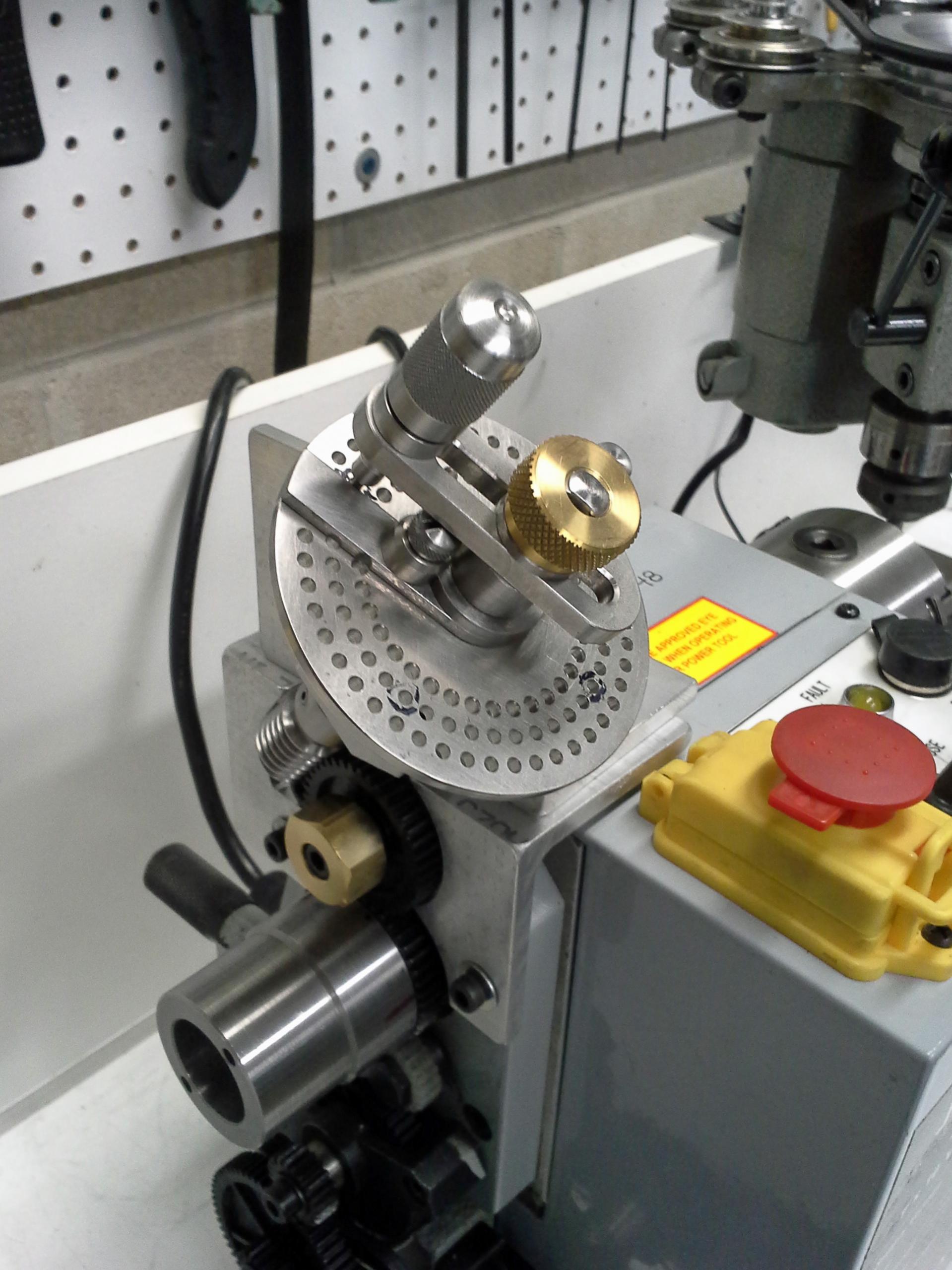

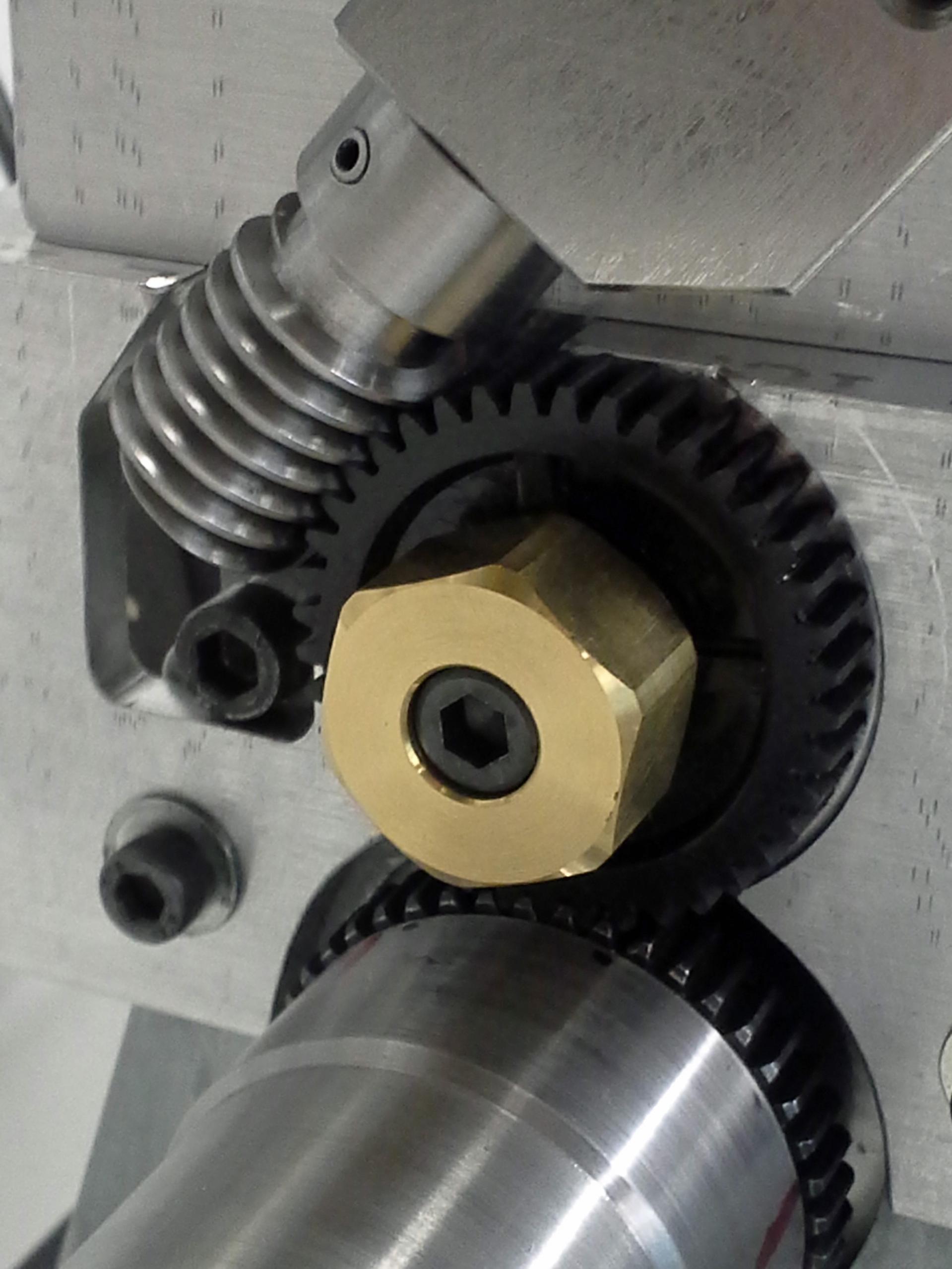

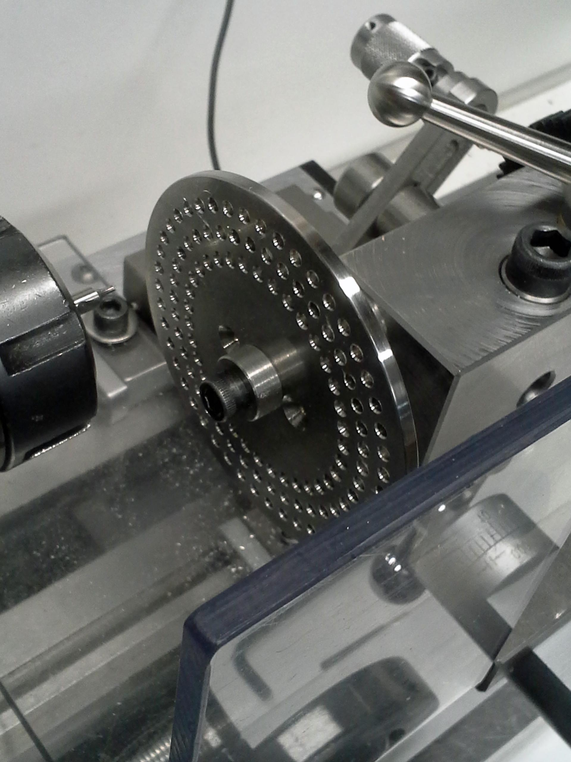

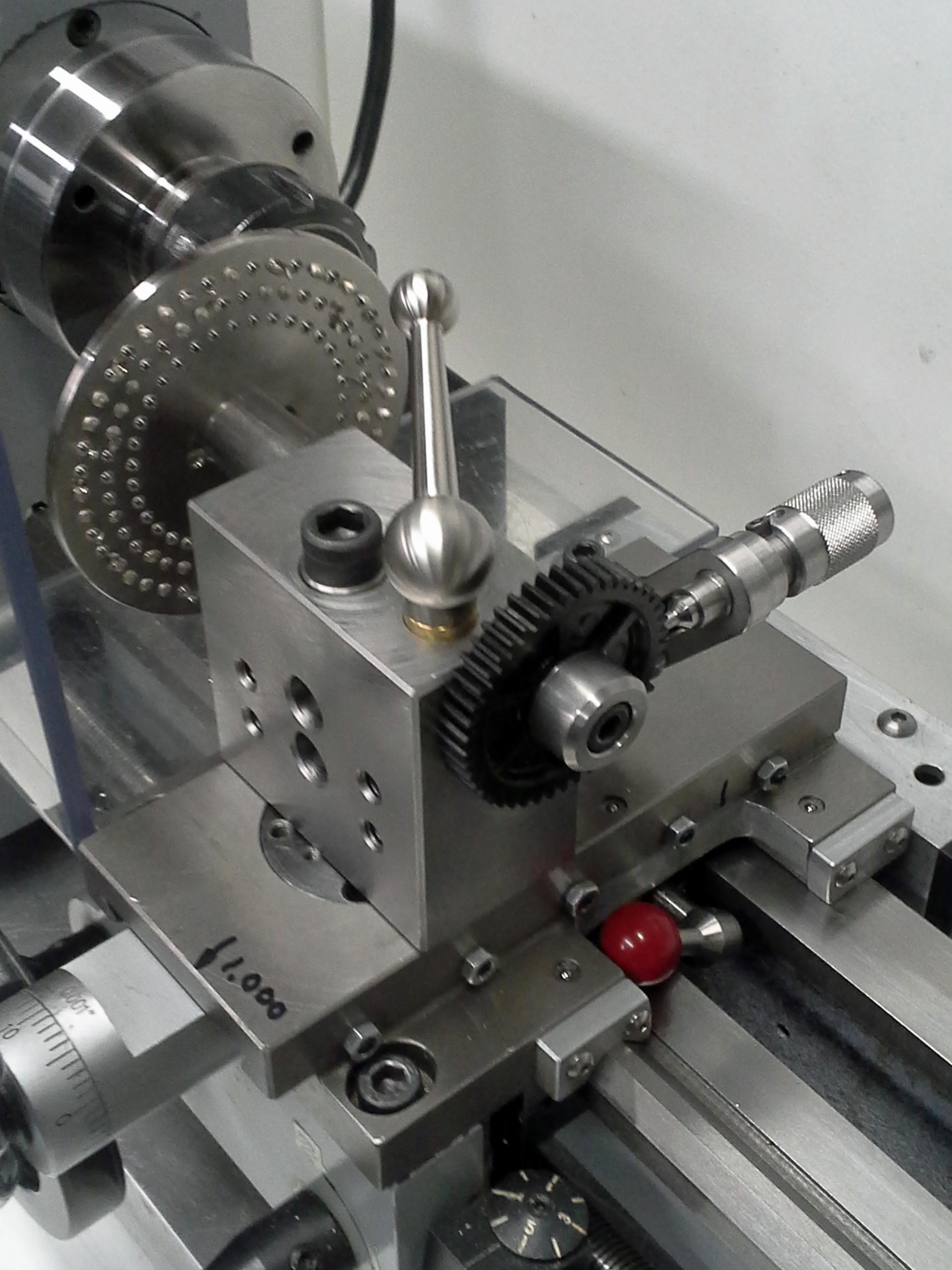

I built this dividing attachment to fit my 7 X 16 mini lathe due to a project I had involving the engraving and stamping of micrometer dials and 360 degree angular setting dials for the cutter grinder I built. I have used it for other projects since such as engraving the lines on other micrometer dials, drilling holes in dividing plates, gear cutting and cutting splines in a shaft. It has come in very handy and I don't know how I ever got along without it.
