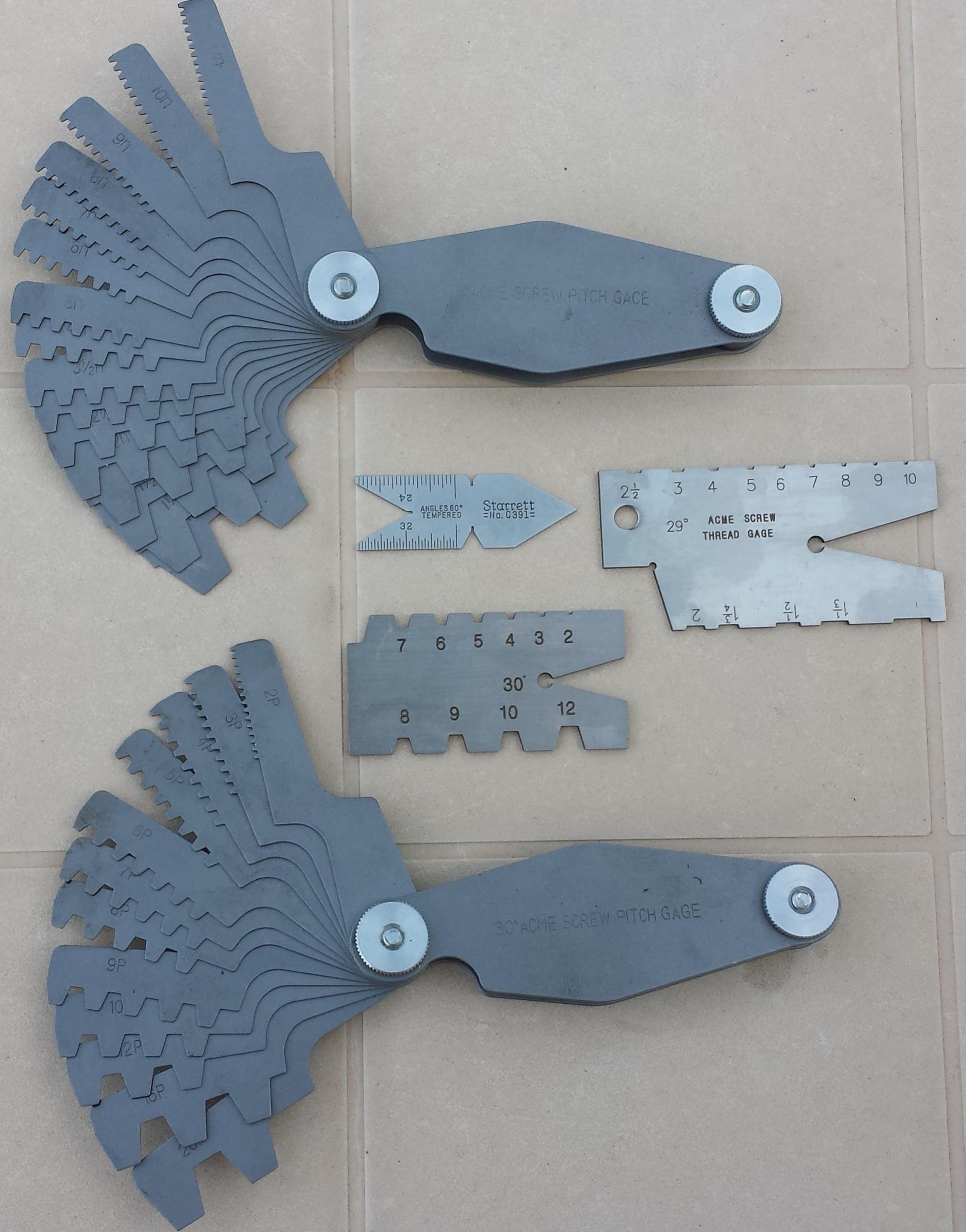

    Hello Rgsparber,
    As I can see you are talking about acme threads and in order to find out which thread you have,
    you will need acme screw thread gages. In order to grind threading tool you will need acme thread grinding gauge,
    not 55 or 60 degrees thread gages. Attached is picture of my gages.
    Good luck / Best regards
    LMMM

    Hi Rick,
    Both threads are trapezoidal (not square) threads and the main difference is the angle. 29 degrees for SAE and 30 degrees for metric.
    SAE thread is called ACME and metric is called Trapezoidal even recently both of them are called acme threads.
    Check here: Acme screw pitch gauges metric - Duchy Fasteners
    They call these gages: Acme screw pitch gauges metric and Acme screw pitch gauges imperial
    On my gages is written: 29 ACME SCREW PITCH GAGE and 30 ACME SCREW PITCH GAGE.
    I needed them to find out thread of my lathe lead screw and found that my lathe is
    full metric with 20 mm dia x 2mm trapezoidal thread lead screw, not 3/4" x 12 TPI as I was
    thinking before.
    Hope this helped.
    Regards
    LMMM
