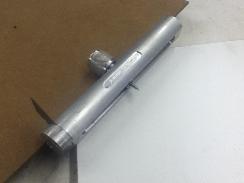

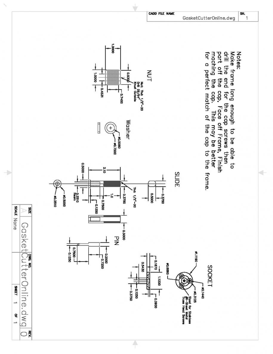

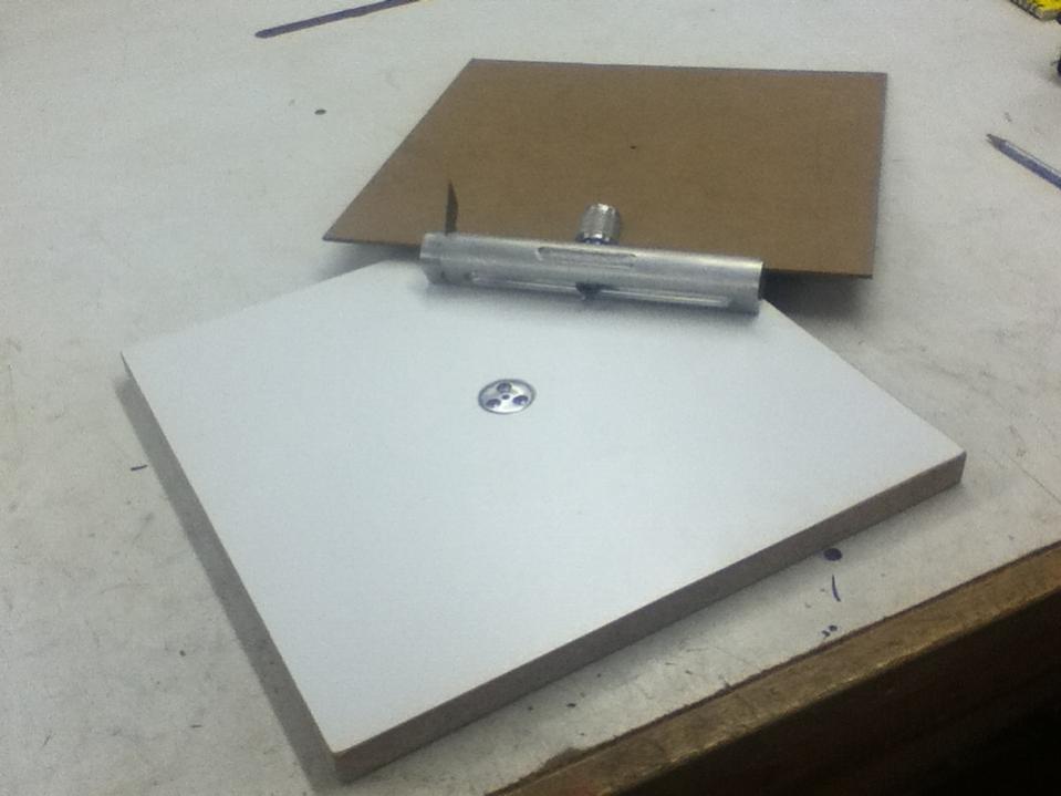

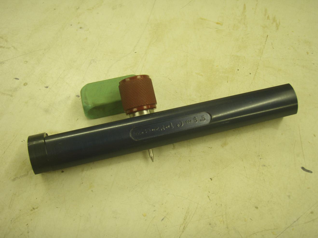

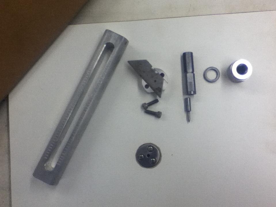

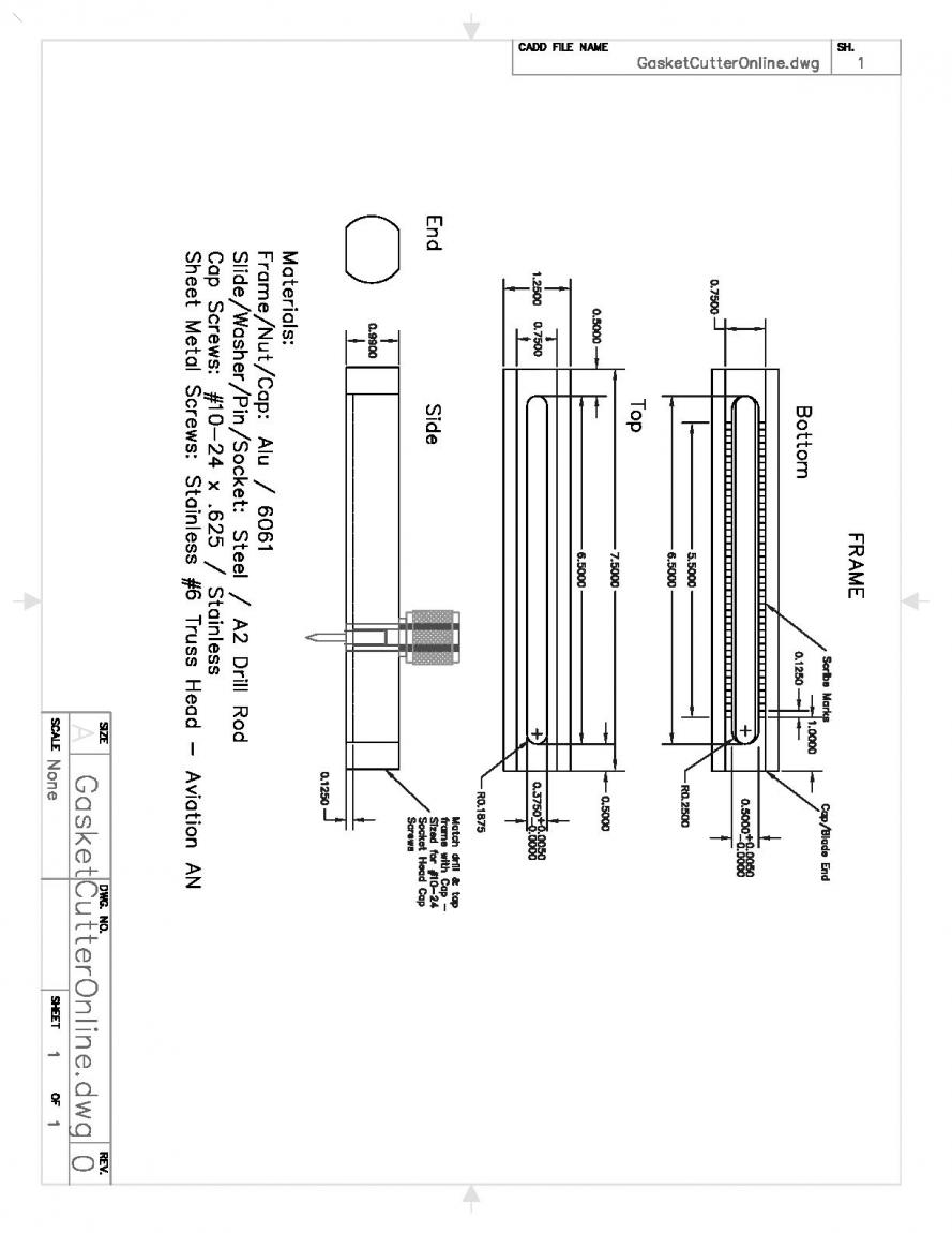

New Gasket Cutter I designed & made one for my son and myself. I will update post with CAD drawings soon.Attachment 977Attachment 978Attachment 979
If anyone would like a copy of the actual CAD .dwg file, contact me and I would be happy to e-mail it.
Attachment 981Attachment 982Attachment 983

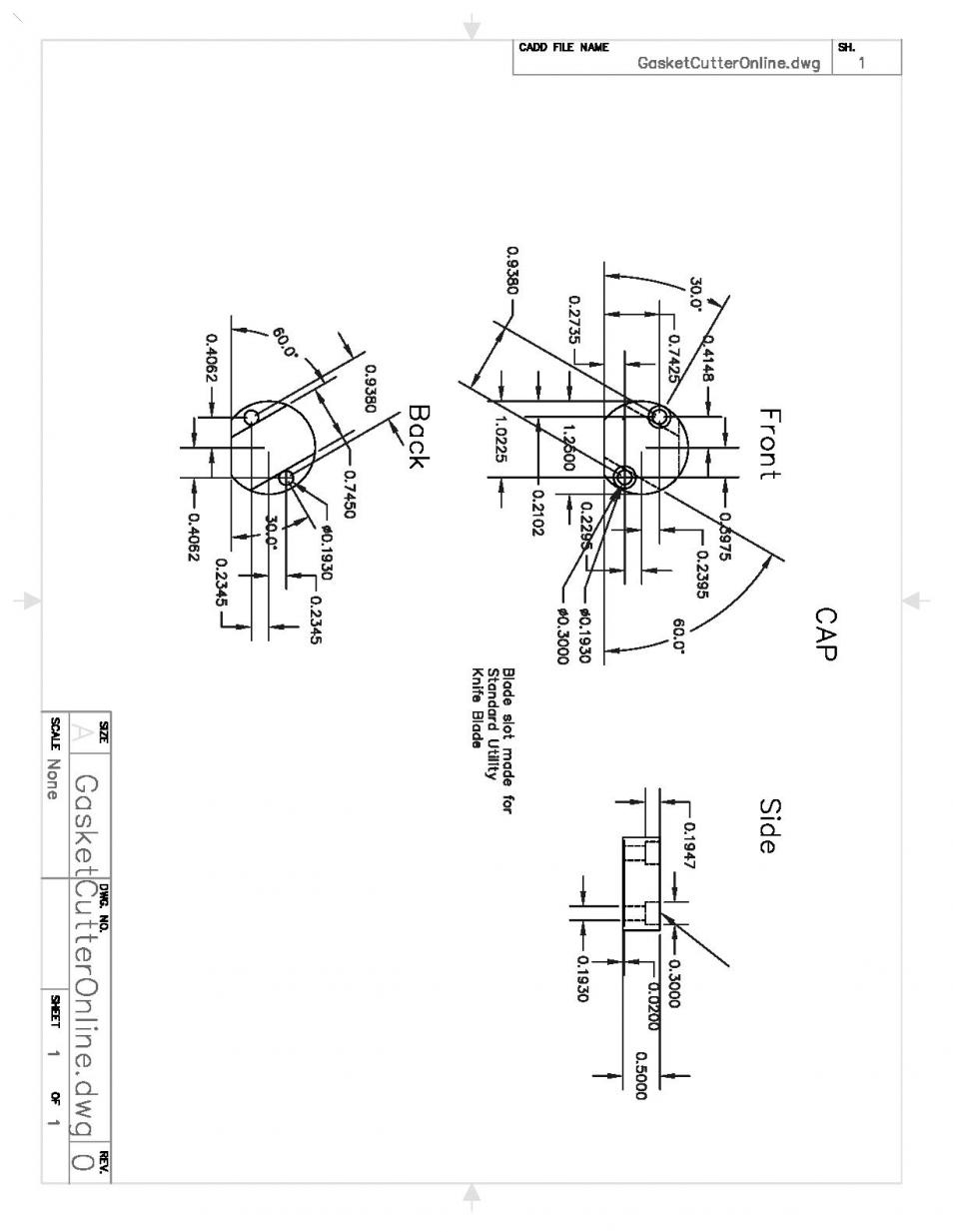

Attachment 1035

Thank you. How can I post the CAD drawing or attach it to a post?

Interesting. Any pics or vids of the tool in action?
I will put a short video together and add it to the post. Thank you for your interest.
