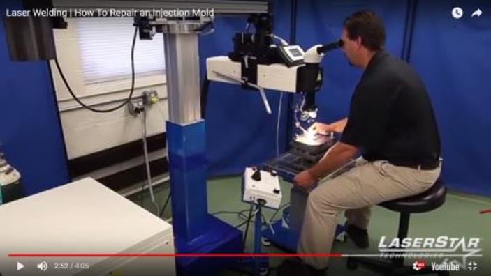

    Came across this in an industry E-mail and I would dearly love to have a play with it.
    https://www.laserstar.net/laserstar-..._hsmi=56121633

    I want one. when I think back at all of the tedious hours spent tig welding up tiny little scratches with the smallest cup a very sharp pointed 1/16" tungsten .o23 wire while trying to balance the right amount of heat and filler applied to them so machining would be minimal.
    I really appreciated the near perfect flow lines created along the beads in the video.

    It's not only rebuilding a worn edge but the ability to build sections also leads to picking the right metallurgy for the job exactly where it is needed. What really got my attention was the apparent lack of heat. Pretty sure the operator would have been wearing gloves if there was radiation and judging by how close he was holding that filler rod the heat was minimal at least.

    Does this technology have some kind of tracking ability, to follow the filler wire and bead? I didn't see any method of the operator knowing where the laser was going to be applying the heat, yet the welds, and subsequent smoothing of imperfections (jealous!!) in some of them, were awesome!

    Note the operator sitting and viewing the weld area through and optic viewer his left hand is on the dial like that of a milling machine

    You know, I did see that, but then got so engrossed in the beautiful welding I totally forgot about it. Thanks for explaining. So does he see like a red dot or something in the viewer, or maybe crosshairs? I'm not certain, but from the video I got the impression that a dark welding shield is not needed? Or was the camera dealing with the flash?
    After welding for years (home use) with a stick welder, I sprung for a MIG, and was totally amazed at how there is no smoke or spatter when gas and solid core wire is used. I still wear gloves and protective gear though. But I've noticed on some of the TV shows these guys MIG weld in tee shirts without even wearing gloves. To me, this laser welding is the same kind of huge leap forward in making welding a pleasant experience, not to mention much more accurately controlled. I did notice, though, that the laser welding technique is rather like "dragging" the MIG wire instead of "pushing", which I read was the best way to do it. Maybe laser welding is more akin to how gas welding works, albeit much finer and prettier?
