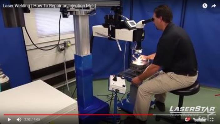

I want one. when I think back at all of the tedious hours spent tig welding up tiny little scratches with the smallest cup a very sharp pointed 1/16" tungsten .o23 wire while trying to balance the right amount of heat and filler applied to them so machining would be minimal.
I really appreciated the near perfect flow lines created along the beads in the video.
It's not only rebuilding a worn edge but the ability to build sections also leads to picking the right metallurgy for the job exactly where it is needed. What really got my attention was the apparent lack of heat. Pretty sure the operator would have been wearing gloves if there was radiation and judging by how close he was holding that filler rod the heat was minimal at least.
One is on my list of things to buy when I win Lotto.:drool:
Does this technology have some kind of tracking ability, to follow the filler wire and bead? I didn't see any method of the operator knowing where the laser was going to be applying the heat, yet the welds, and subsequent smoothing of imperfections (jealous!!) in some of them, were awesome!

Note the operator sitting and viewing the weld area through and optic viewer his left hand is on the dial like that of a milling machine
Attachment 19782
https://youtu.be/YNGuALnRQe0?t=171

You know, I did see that, but then got so engrossed in the beautiful welding I totally forgot about it. :) Thanks for explaining. :) So does he see like a red dot or something in the viewer, or maybe crosshairs? I'm not certain, but from the video I got the impression that a dark welding shield is not needed? Or was the camera dealing with the flash?
