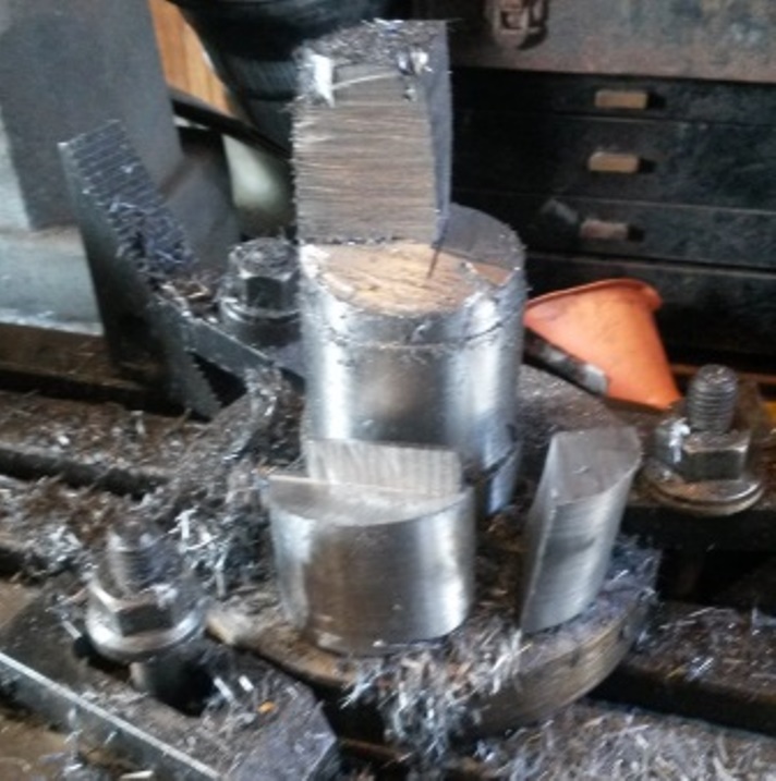

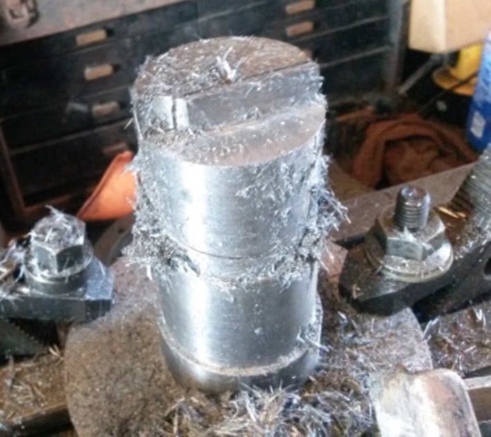

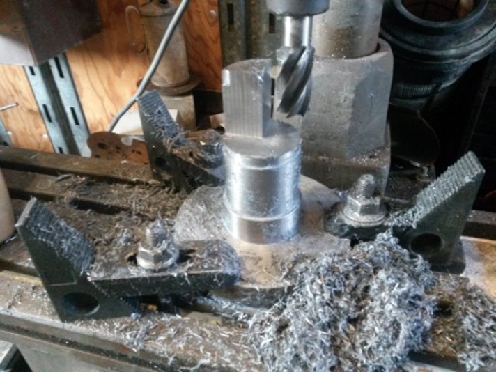

Make chunks not chips now where have I heard that before? OH yes TM51 said it
after welding the pivots shafts the next step was to machine them
after turning I put them in the mill to form the tang
after a couple of passes I decided this is going no where fast
Attachment 19361
I didn't want to take it to the band saw so I brought my porta band to do the job
Attachment 19362
after removing the chunks it only took a single pass down the sides to get to this point
one more pass to get the size I need
Attachment 19363

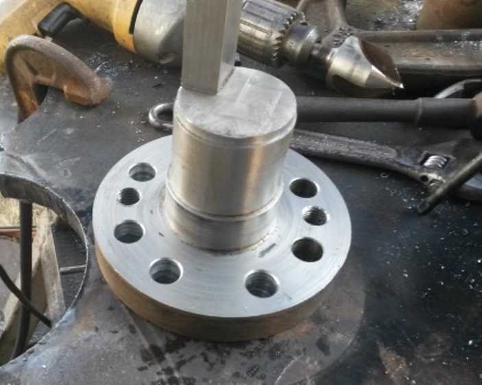

This project is soon to become a tool in progress I just about have enough parts made
here is the swing beam pivot shaft after completion.
After I had fir it in place to determine the locations of the holes I realized this is going to be one of those impossible to remove parts si I decided to drill and tap to jack holes also I have a deep issue with parts that have jack holes that are of a different size than the bolts used to mount them. Hence my jack holes are threaded for 5/8-11 since the part will be mounted with that size
Attachment 19369

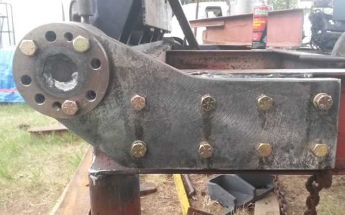

1 Attachment(s)
the part that started this thread is finally completely mounted now to finish the other side I'll have to borrow some of the bolts to fit up the other side as I have used up my entire inventory or 5/8 11 by 2" grade 8 bolts and these are actually borrowed from another project. so next time I go to tractor supply I will have to buy another 5 pounds of these
Attachment 19383
I have to tell you though drilling and taping in 3/4" thick caterpillar steel is a day's work in it self
the steel is the same as that which I used to make my fork carriage out of
http://www.homemadetools.net/forum/f...70-3#post84156
