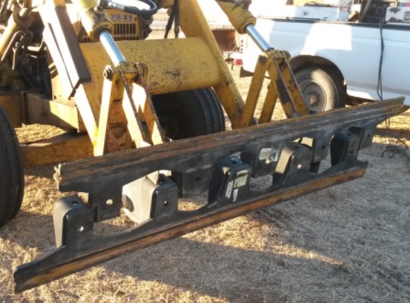

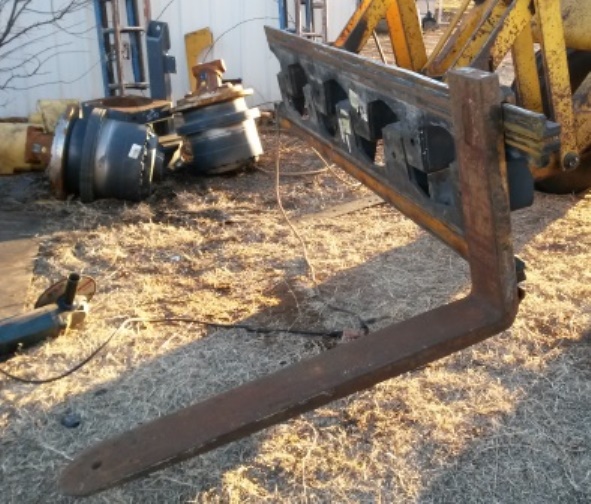

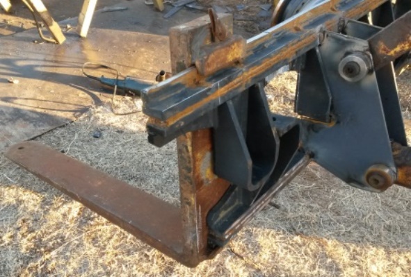

    Well after 3 days of near freezing temperatures and rain I finally got back the the fork carriage today around noon.
    All I can say is this one is ready for the Home made tools sub forum.
    because now instead of a backhoe with a loader I have a backhoe that can double as a rough terrain fork lift

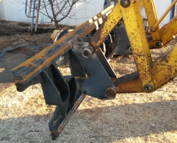

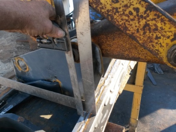

    After checking both sides for alignment it was time to weld it on
    I had thought of making a fixture to hold the mount plates then use a long shaft for a bore alignment bar but decided that the wasted and best way was just use the machine itself
    Now this is a carriage not one of those wimpy store bought things

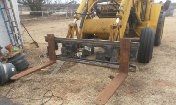

    Too tired to put the second fork on besides they weigh 250 lb each and 1 was all that I wanted to wrestle and lift onto teh carriage today

    Lookin good Mad Frank. Heavy duty as usual. Looks like you could play chicken with a semi, no problem.
    Two questions,
    are you going to square up the rails or just leave them staggered just to mess with bozo's like me?
    Is there blocks, tabs whatever they are called on the back of the upper rail to help lock the forks in place or you don need no stinkin locks? just curious......

    I will probably square up the ends for looks for the locks the forks have a cam operated protrusion that would fit in a notch in the top rail since I won't be spinning around doing doughnuts in a warehouse in front of some stupid-visor of a safety cop I really don't need or want them. Usually the first thing I have always disabled on my own forklifts were the fork locks the only thing I will put on will be end caps so the forks cannot be accidentally slid off
    they are heavy enough and there is more than enough friction to keep them in place.
    I especially like the frontal look of the carriage the way the rock guards are joined together it kind of says go ahead and make a frontal assault I'll ruin your day
    Looking at it I think it would make a heck of a back drop of a dozer blade
    Now where did I put that 7 ft cutting edge

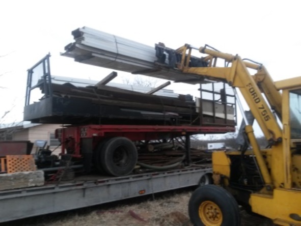

    While the big lumbering backhoe may not be as quick or maneuverable as a warehouse forklift. it will hold its own in the lifting department
    I still think it carriage would make a good dozer blade
