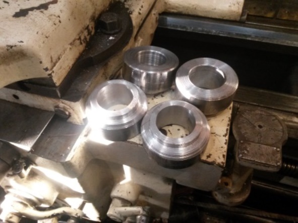

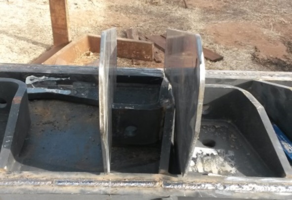

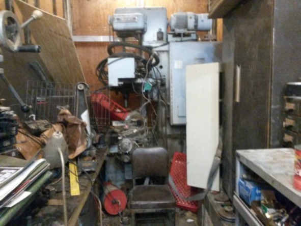

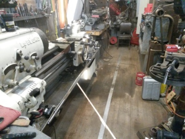

    The whole day was spent trying to straighten up enough so I wouldn't feel like I was having to walk over dead bodies while running the lathe but I sis manage to get half of the bushings made
    Fork carriage for my Ford 755-20170104_171012a.jpg Fork carriage for my Ford 755-20170104_171039a.jpg Fork carriage for my Ford 755-20170104_171046a.jpg

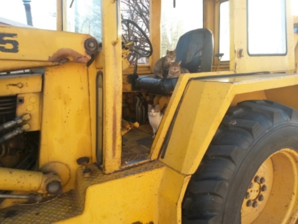

    It probably doesn't matter now since the cats decided they now own the tractor

    I'm a little dismayed with mu progress on this simple project. the main part of the carriage only needs some grinding done to the top and bottom edges then notches cut in for the fork position locks.

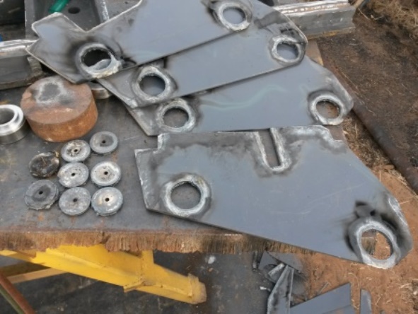

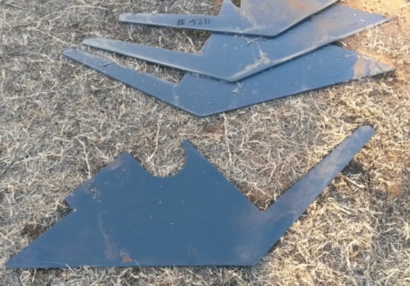

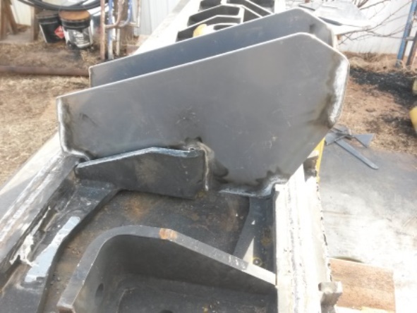

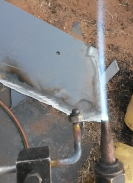

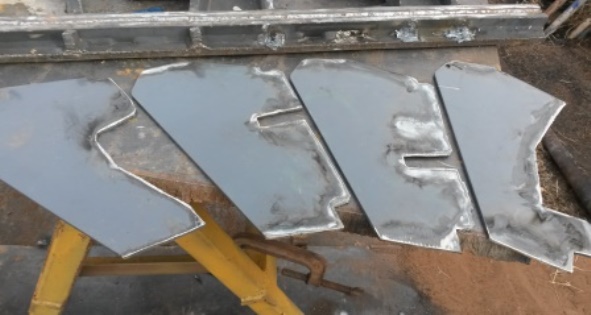

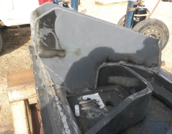

    Back home last night so today first I unloaded all of those 10.00/20 tires & wheels and stacked them where I wouldn't need to move them until I start the roller project then the wife and I unloaded the rest of the trailer and the truck then She wanted some low hanging limbs trimmed from one of the trees so I finally got started working on my fork carriage sometime around 2 this afternoon.

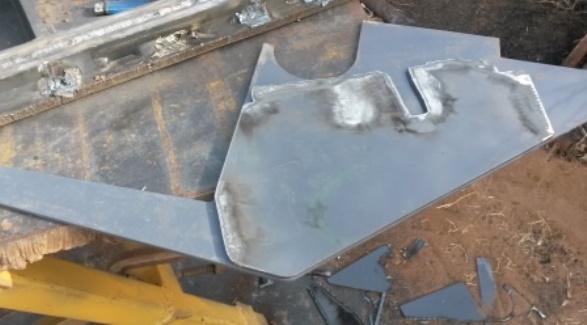

    First off I must have spent half an hour just trying figure how I was going to uses the parts I had for the mount plates then I had to make the 4 of them and no 2 could be cut just alike
    Fork carriage for my Ford 755-20170102_162532a.jpg Fork carriage for my Ford 755-20170112_145610a.jpg Fork carriage for my Ford 755-20170112_145636a.jpg Fork carriage for my Ford 755-20170112_145652a.jpg Fork carriage for my Ford 755-20170112_145703a.jpg Fork carriage for my Ford 755-20170112_153019a.jpg

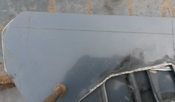

    Then lay out for the holes the position was not critical but I wanted them close to the same as the bucket mount is.

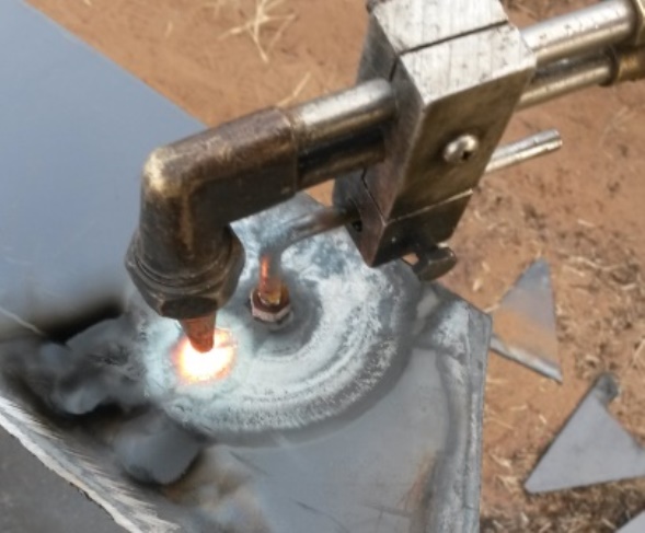

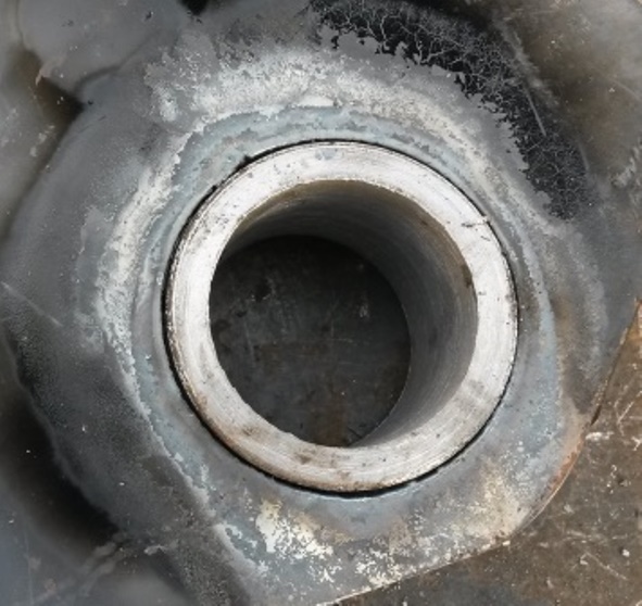

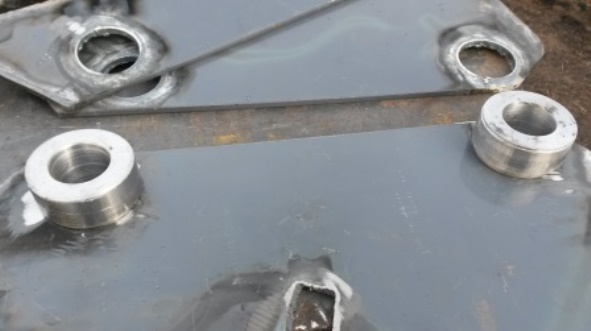

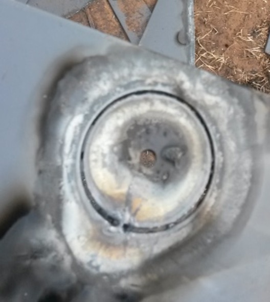

    I stacked all 4 and drilled a pilot hole for the bushing hole locations
    I also had to make a different stylus for my circle burning attachment that would fir in the pilot hole so the torch could not slip

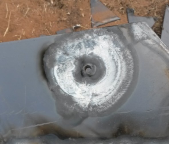

    Thye powder coat had to be burned off before cutting the holes

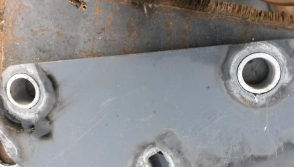

    I probably could have cut the holes about .020" smaller but the fit turned out just fine for a weldement
    Fork carriage for my Ford 755-20170112_164440c.jpg Fork carriage for my Ford 755-20170112_164449a.jpg
    Before I can weld these in I will have to fit everything up with an aligning bar so the bores will all be in near perfect alignment

    Whew, what a lot of work! Are you still glad you didn't buy that other carriage for $600? I would think your usual hourly wage and the time you've got into this thing makes it waaaaaay more expensive than that. But what do I know?

    Yeah I couldn't have got anywhere near the carriage like the one I am making for any price. And I would have still had to modify the other one to fit the loader
