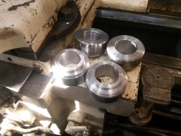

I'll have enough work area around the lathe and enough tooling sorted out by sometime tomorrow so I can at least get the bushings made

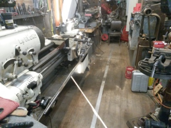

The whole day was spent trying to straighten up enough so I wouldn't feel like I was having to walk over dead bodies while running the lathe but I sis manage to get half of the bushings made

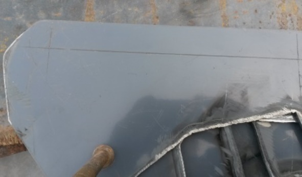

I'm a little dismayed with mu progress on this simple project. the main part of the carriage only needs some grinding done to the top and bottom edges then notches cut in for the fork position locks.
I have the 8 bushings made the weather from Thurs. through Sat. was less than cooperative for working outside so other than to finish up the bushings in the machine shop van. Then I got a call from a friend of mine that I have been repairing his equipment since before Ronald Reagan was running for President. He said that he needed me to come to Ft.Worth and do some repairs for him. Now I am not in a habit anymore of wanting to make 450 mile round trip service calls anymore, well 2 years ago the wife and I did make a 5000 mile round trip service call to repair and add safety upgrades to a 20 year old elevator that I built. so I do make them for a fee. Anyway here I am in FT.Worth hoping to finish up the repairs tomorrow

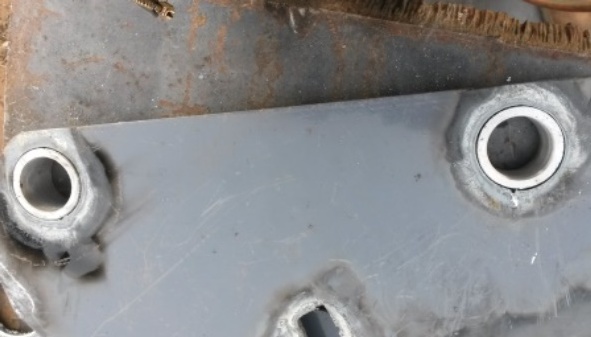

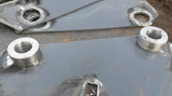

15 Attachment(s)

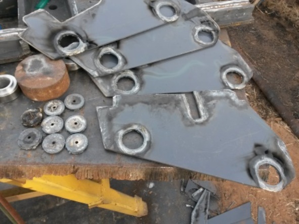

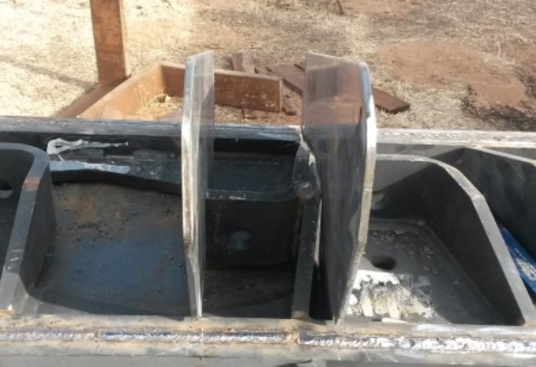

Back home last night so today first I unloaded all of those 10.00/20 tires & wheels and stacked them where I wouldn't need to move them until I start the roller project then the wife and I unloaded the rest of the trailer and the truck then She wanted some low hanging limbs trimmed from one of the trees so I finally got started working on my fork carriage sometime around 2 this afternoon.

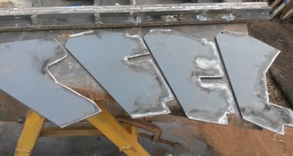

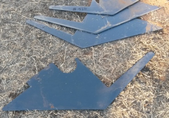

First off I must have spent half an hour just trying figure how I was going to uses the parts I had for the mount plates then I had to make the 4 of them and no 2 could be cut just alike
Attachment 16006 Attachment 16007 Attachment 16008 Attachment 16009 Attachment 16010 Attachment 16011

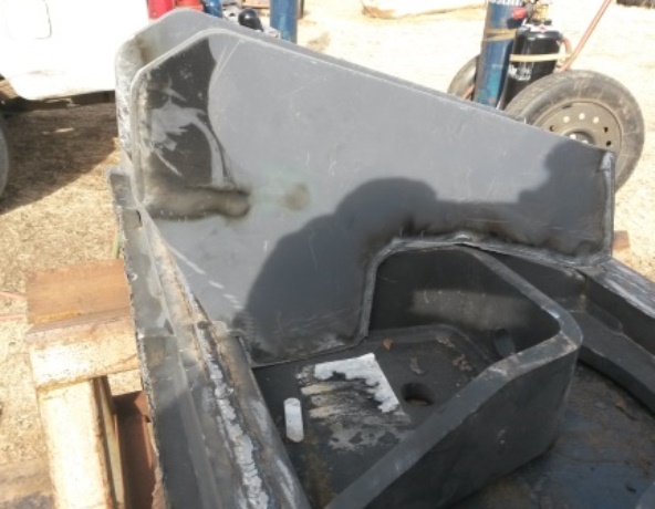

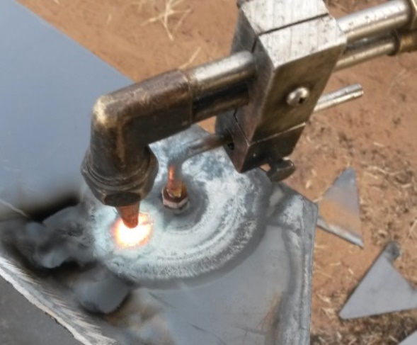

Then lay out for the holes the position was not critical but I wanted them close to the same as the bucket mount is.
Attachment 16012
I stacked all 4 and drilled a pilot hole for the bushing hole locations
I also had to make a different stylus for my circle burning attachment that would fir in the pilot hole so the torch could not slip

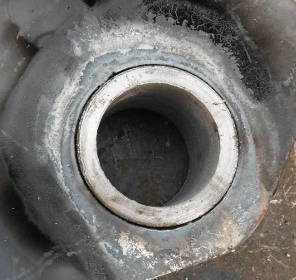

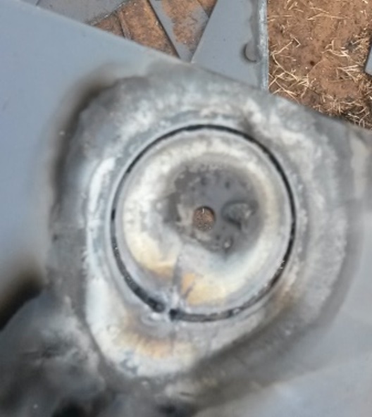

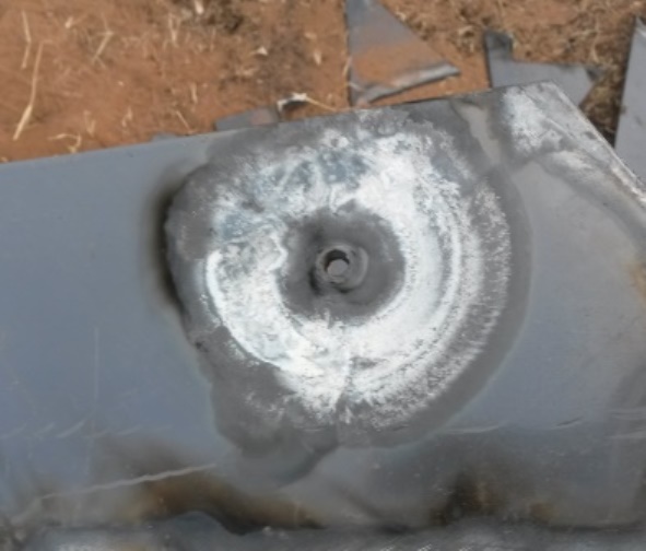

Attachment 16013

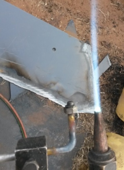

Thye powder coat had to be burned off before cutting the holes

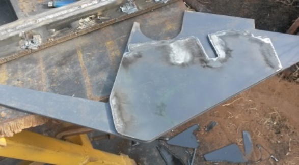

Attachment 16014
Attachment 16015
Attachment 16016
Attachment 16017
I probably could have cut the holes about .020" smaller but the fit turned out just fine for a weldement
Attachment 16018 Attachment 16019

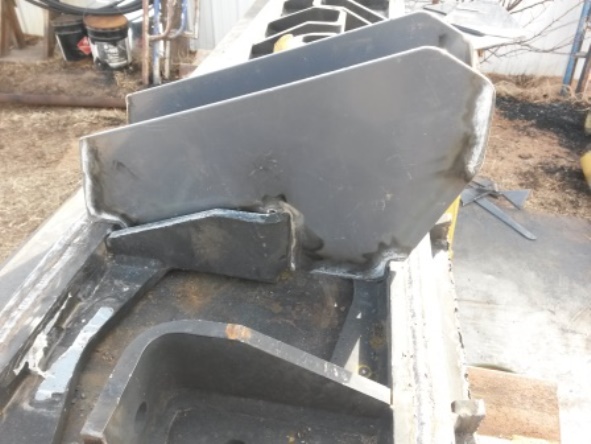

Before I can weld these in I will have to fit everything up with an aligning bar so the bores will all be in near perfect alignment
Attachment 16020

Yeah I couldn't have got anywhere near the carriage like the one I am making for any price. And I would have still had to modify the other one to fit the loader
