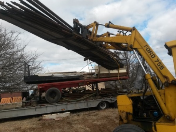

True dat! It's really nice to have the equipment to take advantage deals when they come up. There have been times when just the fact that it is so heavy/long/high up that it's either penny's on the dollar or free. A foundry closed down in the valley and they were giving away the electric 5ton overhead hoist to whomever could safely take it down. I think it was 20' up. A guy I knew had a portable crane and got it and all the I-beam frame he could could cart away for free after they had tried for over a year to sell it.
And to have the trailers, trucks, loader and most of all, the space to be able to store it is just the best. You've got a helluva set up Mad Frank. Seems like the only limititaions are time and effort.

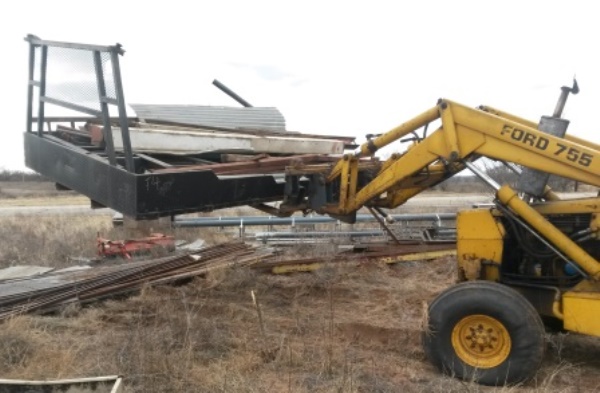

the forks and carriage are strong enough that I can slide 1 fork all the way over to one side and at 2 ft out from the hock confidently lift anything the 755's loader hydraulics has the power to lift but to do that I would have to rotate and extend the hoe as far back as it will go with a bucket full of dirt. for an old machine it still has a lot of life left in it.
