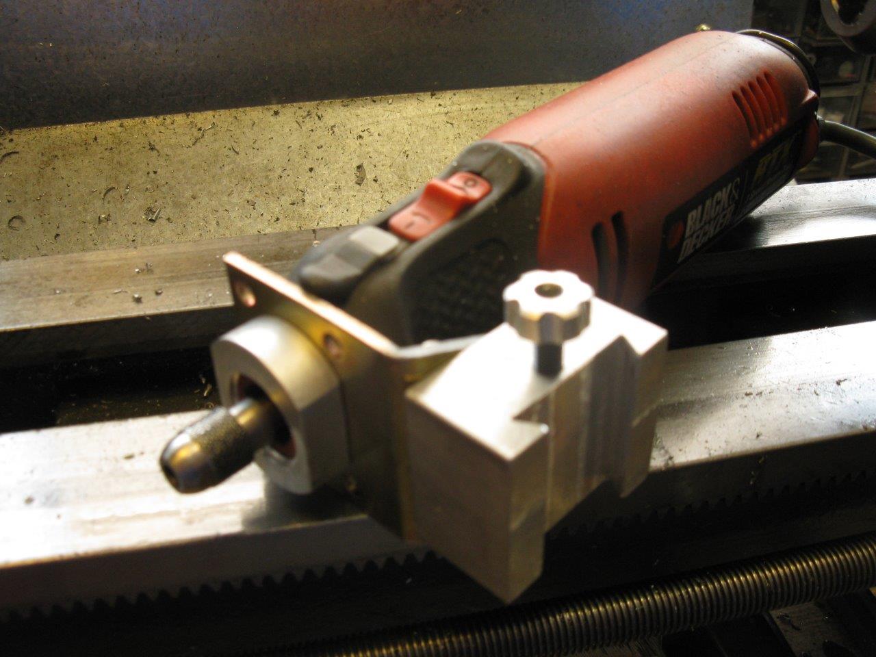

    Finished some more holders last night, this time out of aluminium. Did power tapping in the DP and used a roll form tap, both for the 1st time, which saved me a HUGE amount of time. These holders are all for smaller or more rarely used tools - couple of form tools, threading tool, 8mm SCLR turning/ facing tool and a 6mm boring bar. Need to make a holder to hang them up on the wall and finish the tool holder for my dremel then I should be done with tool holders for a while. Then it's onto the next project!

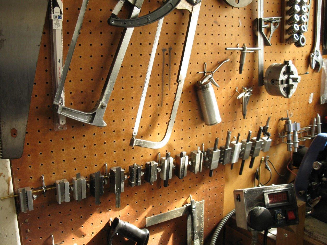

    last holder for now
    QCTP holders for a Phase 2 0XA tool post-img_5242.jpgQCTP holders for a Phase 2 0XA tool post-img_5243.jpg
    and all the holders, old and new, hung up on the wall
    already developing the muscle memory for the more commonly used holders! Tried my new SCLR turning tool with CCGT insert yesterday, when I was making the rotary tool holder nut, and I was seriously impressed. Lovely finish. The CCGT insert that I put in my 3/8in boring bar also gave a much nicer finish than the CCMT insert that it came with.

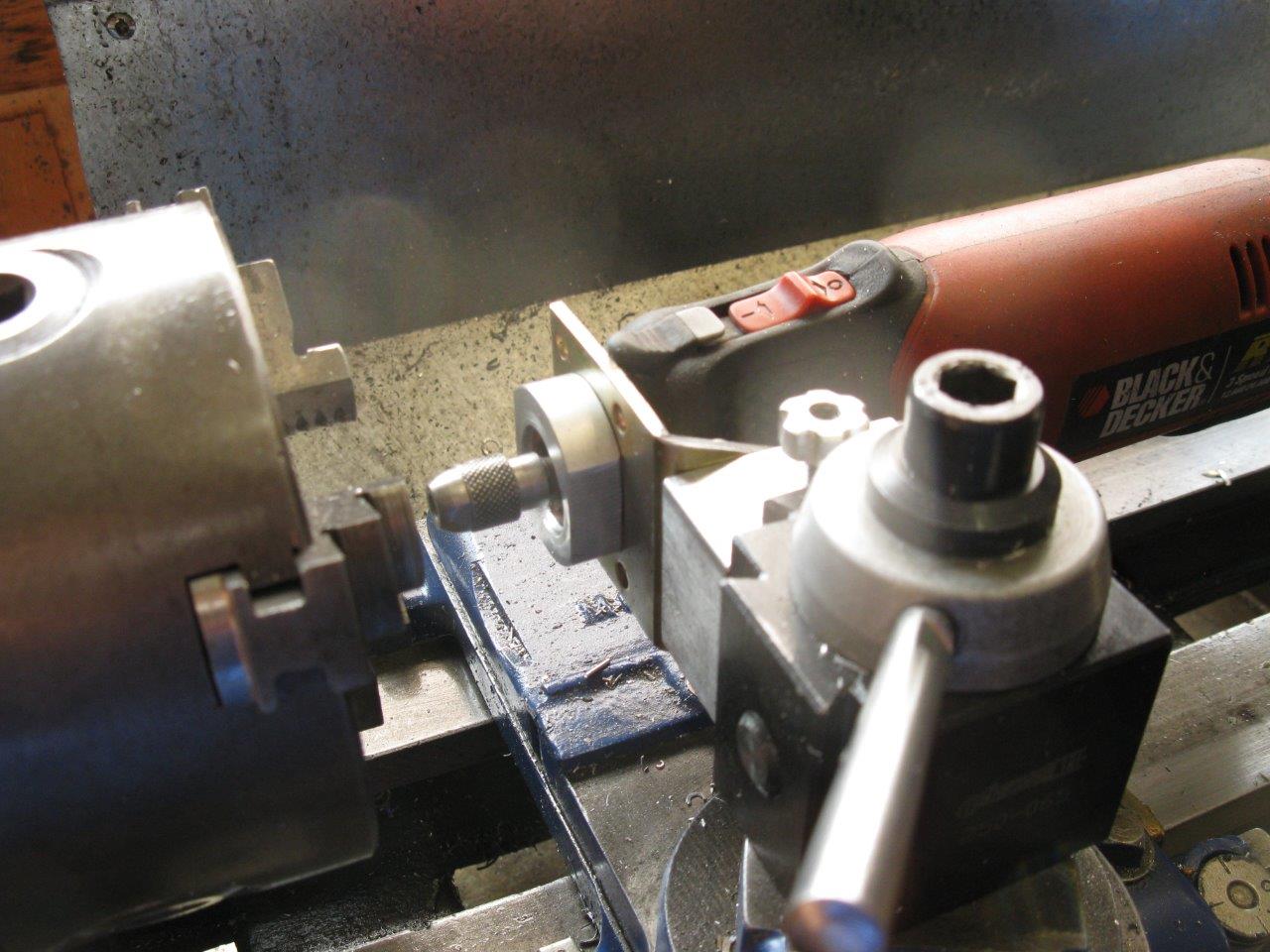

    that's very kind PJ, thank you. I'm looking forward to trying out the grinder - the last time I used an extension zip tied to a boring bar, which wasn't the most rigid set up. I need to grind the taper in my homemade ER25 collet chuck, the jaws on my 3 jaw and the tip of a live center, so I should get a good feel if it works well or not.
