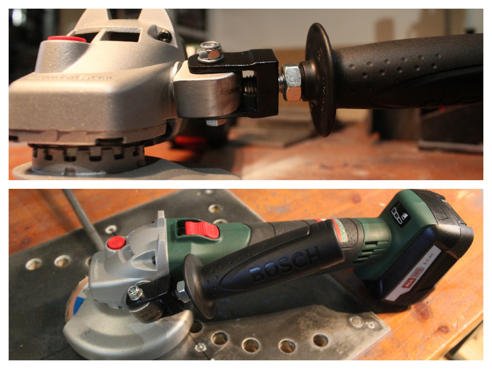

Hi
This is very simple, but usefull "tool" for your angle grinder.
It allows to adjust the angle of the handle of it.
Takes less space when stored.. gives more ergonomical hold from the grinder in different task..
when cutting, grinding, in different positions or workpiece down or high.

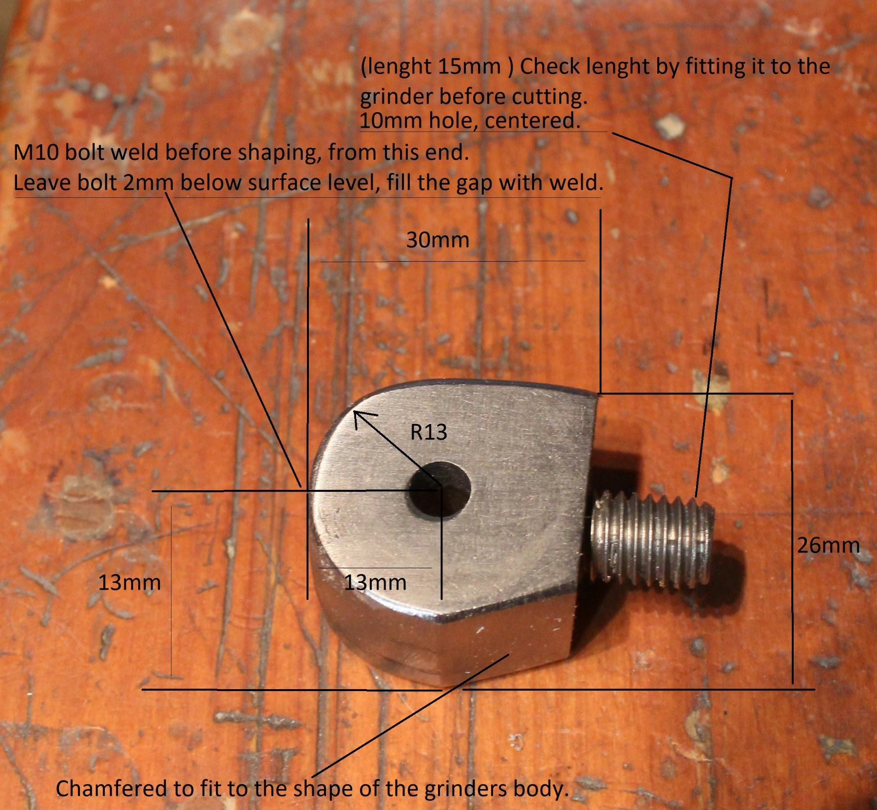

Edit, plans:
Structure is very simple, but here's the plans. So you don't need to think whole system by yourself.

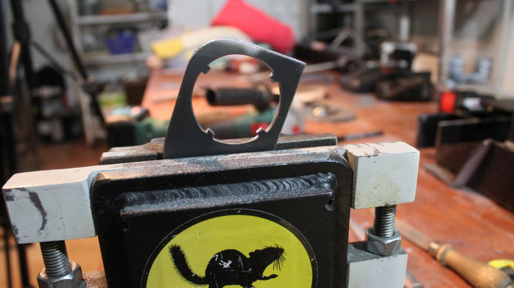

First picture is the part 1.
Its made from three parts. 2pcs 30mm x 20mm x 3mm flat bar.( part 1.1 ) And one 20mm x 26mm piece of 10mm thick flat bar. (part 1.2 )
Parts 1.1 are weld to parts 1.2 so that gap between parts 1.1 is 20mm ( same as the thickness of part 2 )
Attachment 23867

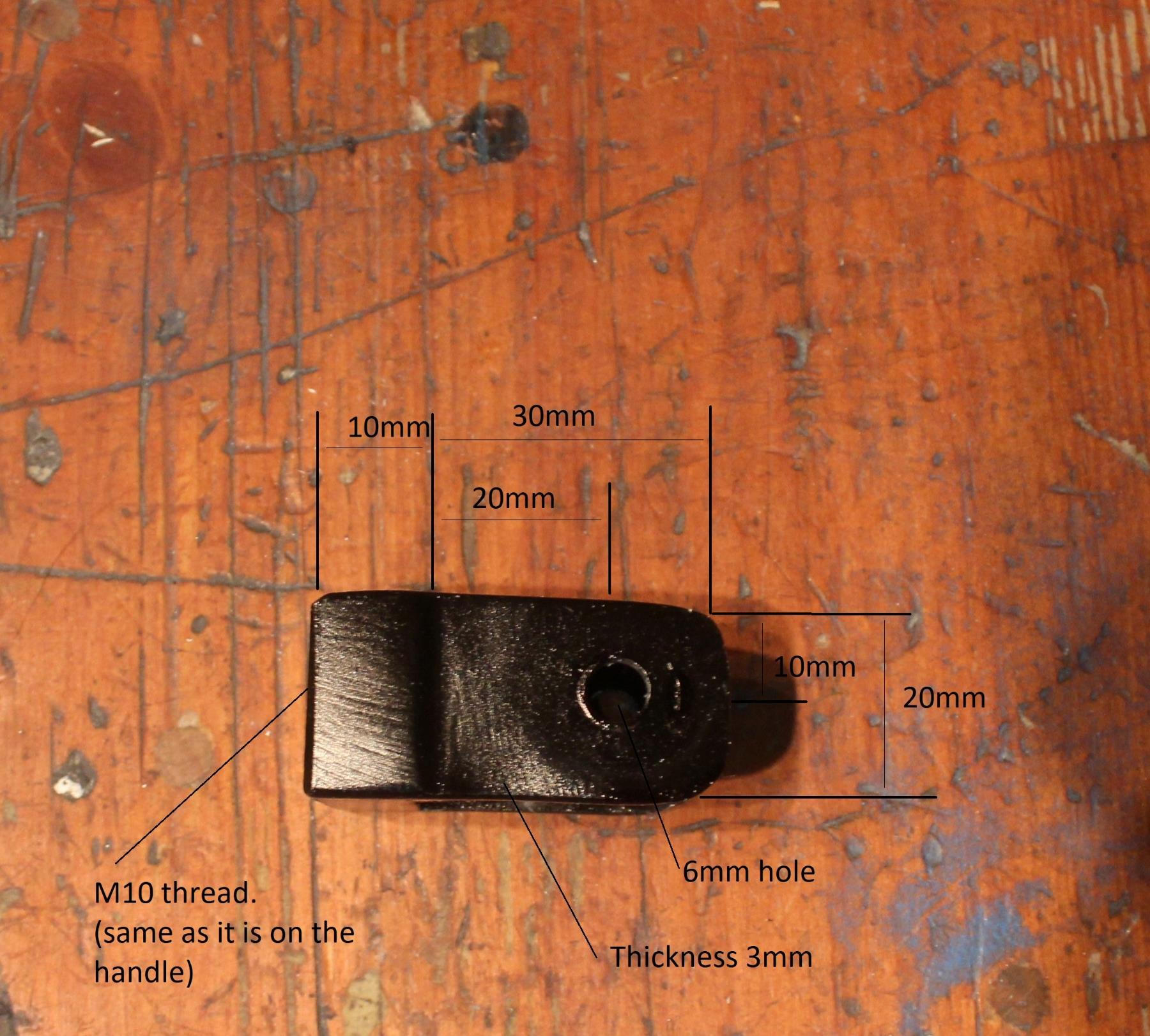

Second picture is the part 2.
Its made from 30mm x 20mm flat bar. Cut to size 30mm x 20mm x 26mm
20mm thick side goes between parts 1.1 in the part 1.

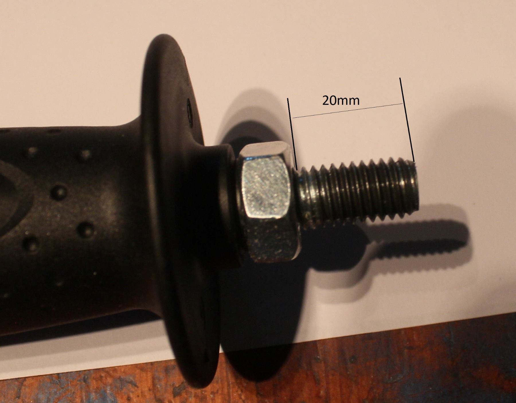

Third picture is from the handle.
I changed the srew from it to longer one. So that the lenght after locking nut is 20mm

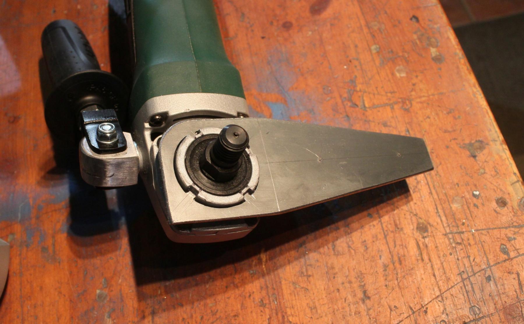

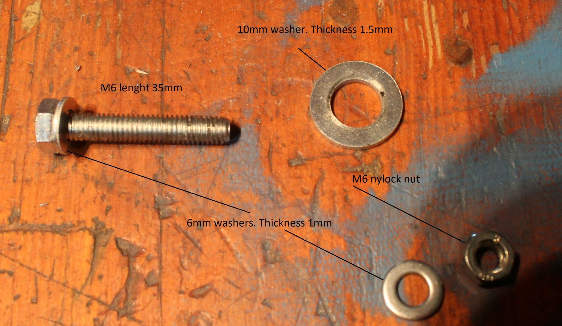

Fourth picture shows the screws used for assembling.
M6 screw. Lenght 35mm. Two 6mm washers and nylock nut to connect parts 1 and 2 together.
10mm washer goes between part 2 and the grinder.
Attachment 23870

Simple idea, but works
