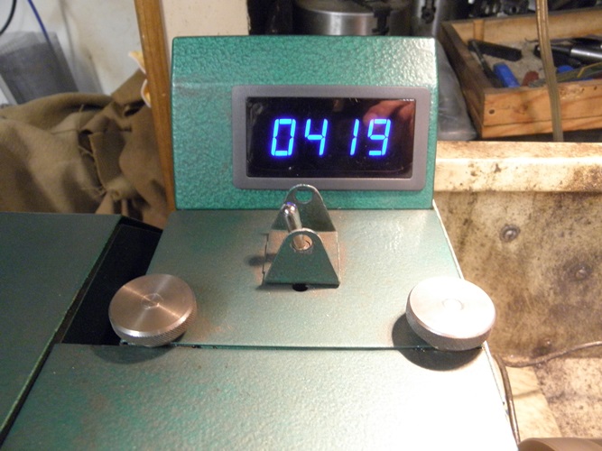

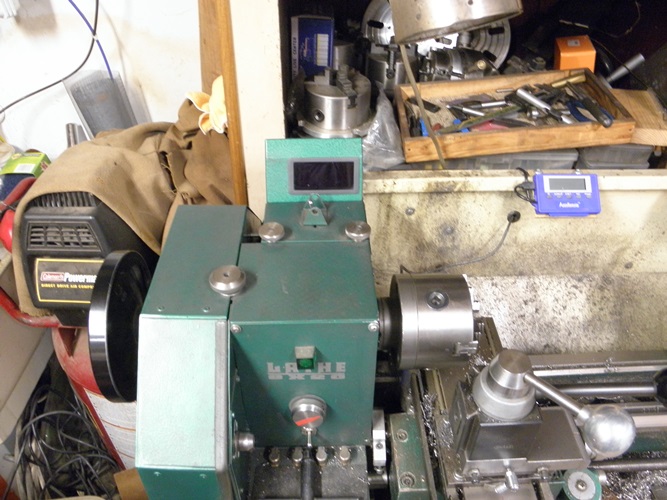

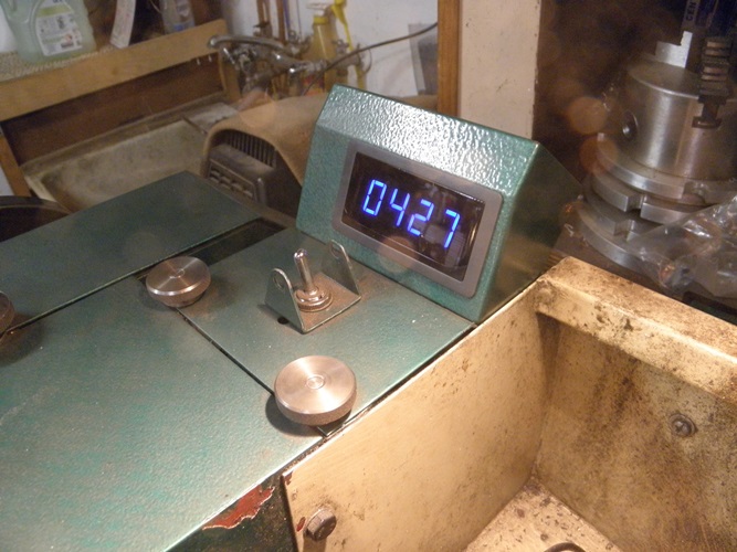

I like tachometers in lathes, even more on a varispeed mill. My lathe is geared, RPM is assured with voltage. Does the tach monitor spindle or motor, and indicate when cuts bog down?

Yes they do indicate when the spindle bogs down. shows lower rpm.
I drilled a hole in the pulley and put a magnet with a hole in the middle (ebay) and screwed it on work real good.
however the magnent had to be flipped over for it to work.
Here is one that I got, UK eBay but I am sure that the US eBay has them too. I was going to make my own but at that price that would have been folly beyond imagination. ebay tacho
Here is a pic from the listing Attachment 28052
You need no knowledge of electronics, it will measure the rpm of whatever device you put the pickup on.
