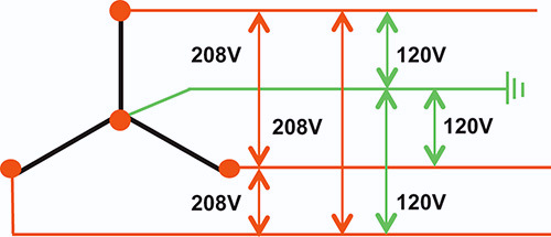

A three phase motor will NOT rotate on single phase. At least no three phase motor I've ever used would. None would even rotate on two phases without a pony motor to start it up. Where are you getting that from Terry?
By the way, 208 is a product of a 3-phase "Y" generator.
Attachment 16773
If you have 208V, it is unlikely that you have 240V too and the converse it also true. It has nothing to do with the location being home, office or shop. It is what your local electric company is producing.
