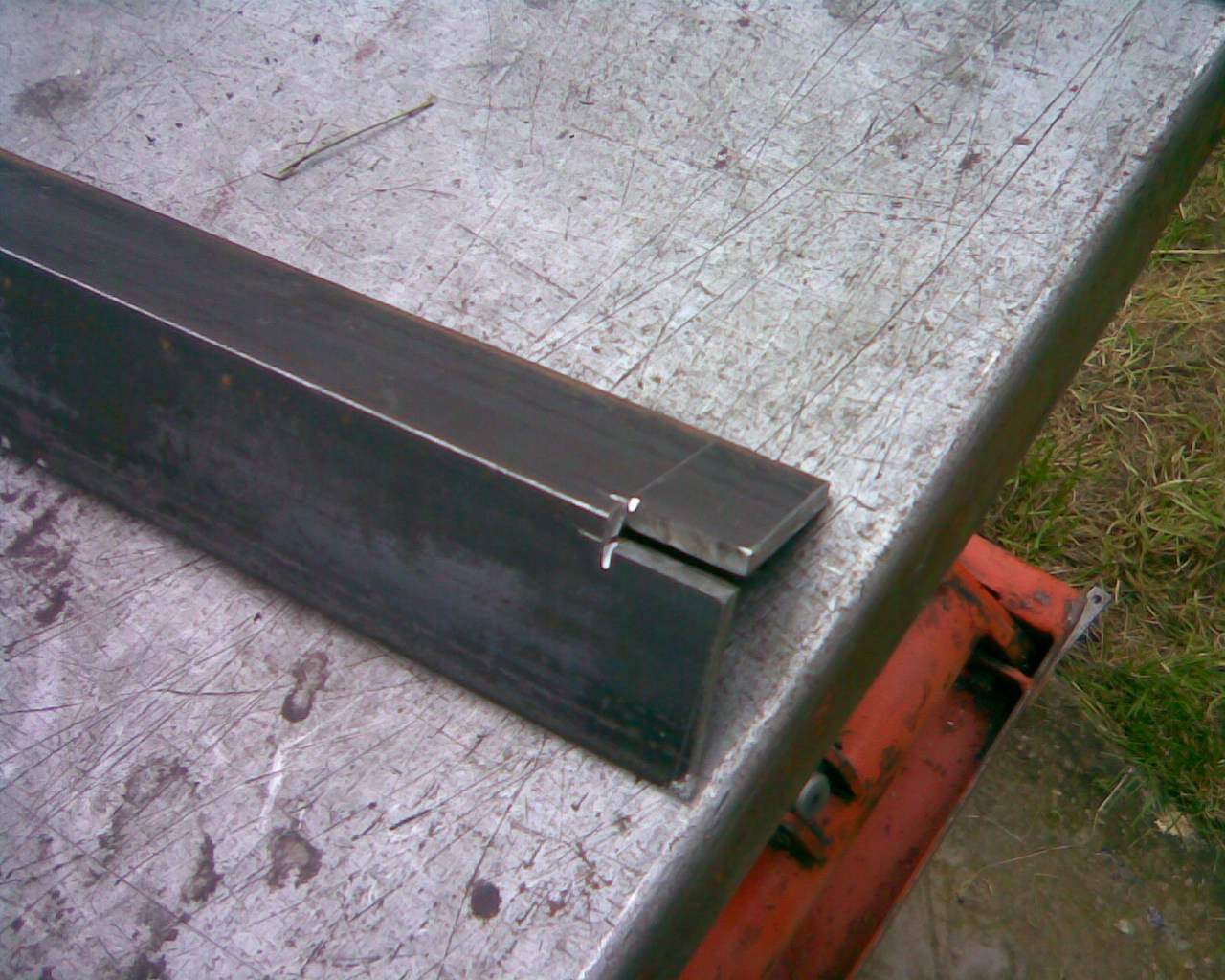

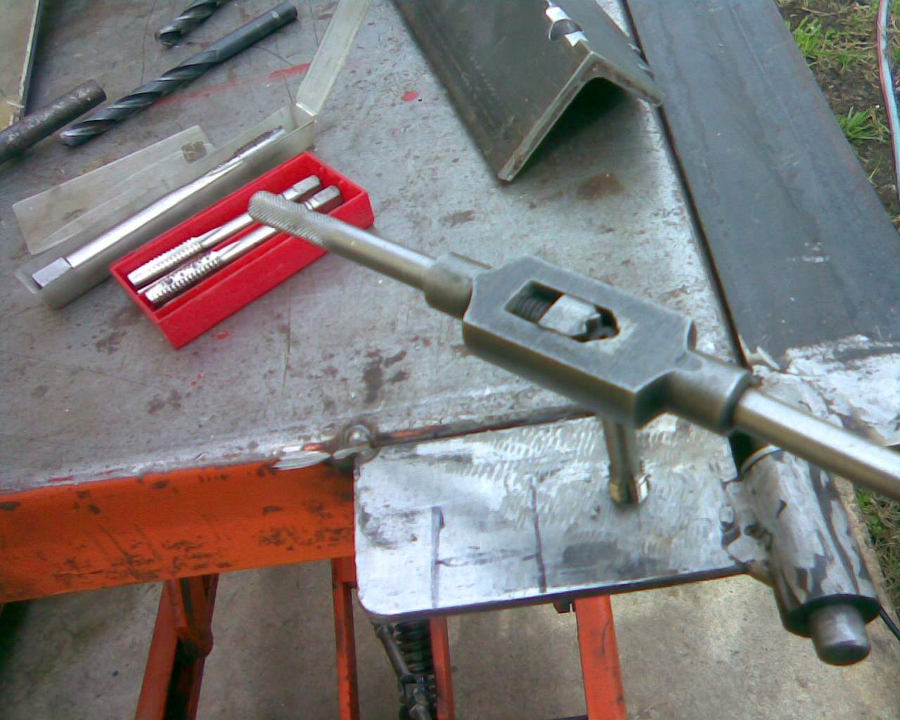

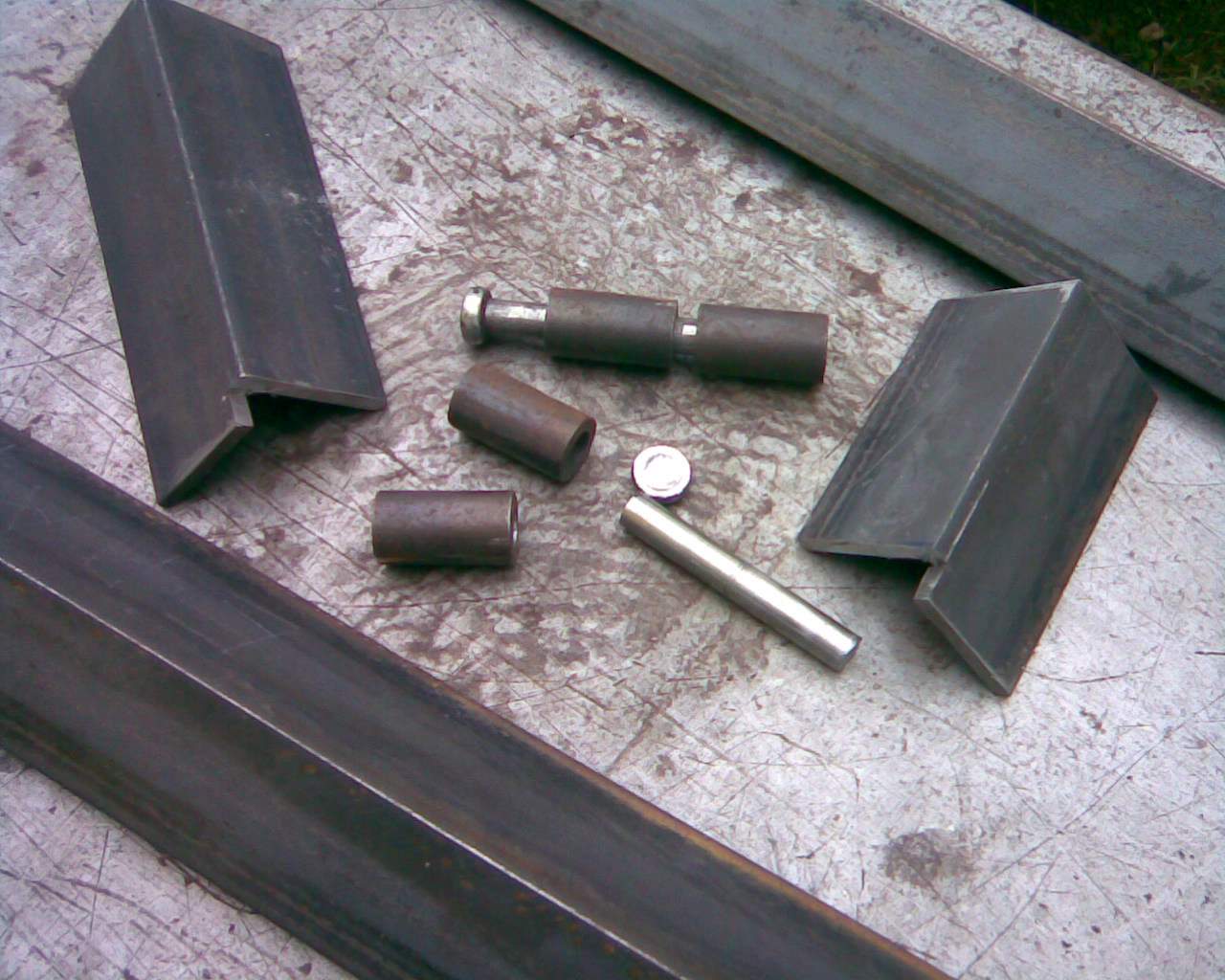

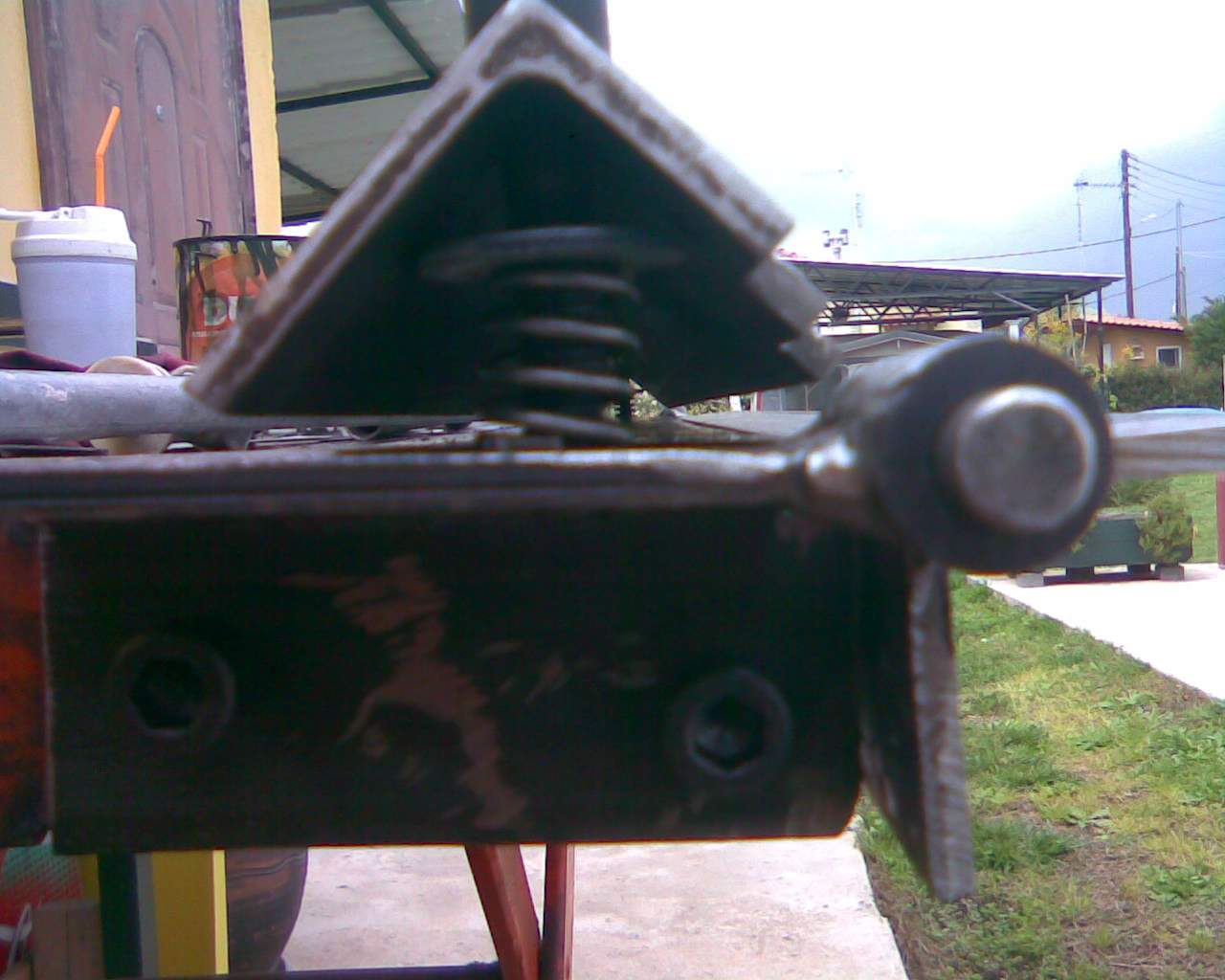

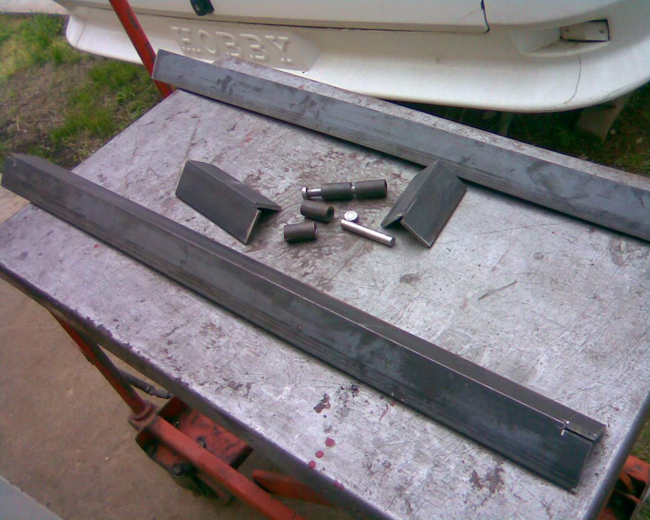

Sheet Metal Bender Brake The Make (DIY) & First Use Stainless Steel BBQ
Homemade sheet metal bender brake 805 mm length.
Step by step guide, materials, dimensions.

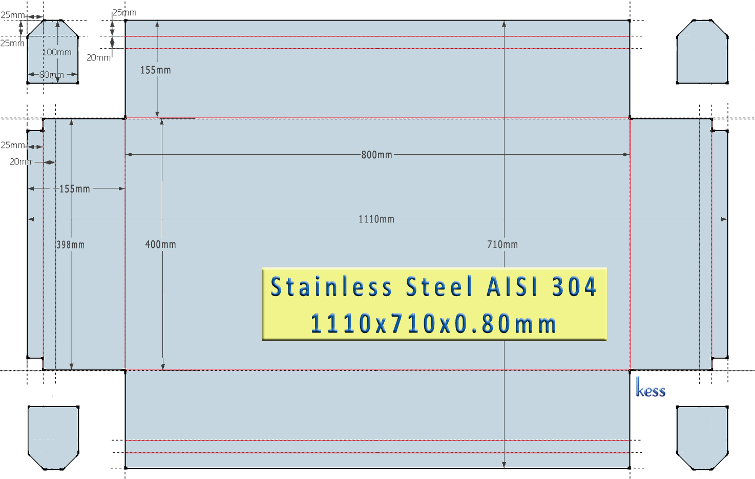

First use and testing with stainless steel sheet (AISI 304)
0.80mm thickness for the making of a BBQ 800x400mm.
This is the first part of a series of three videos.
https://youtu.be/FOYczH-yiWI
