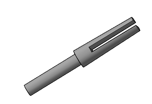

Attachment 26902
A £16 price tag was a bit to steep for me

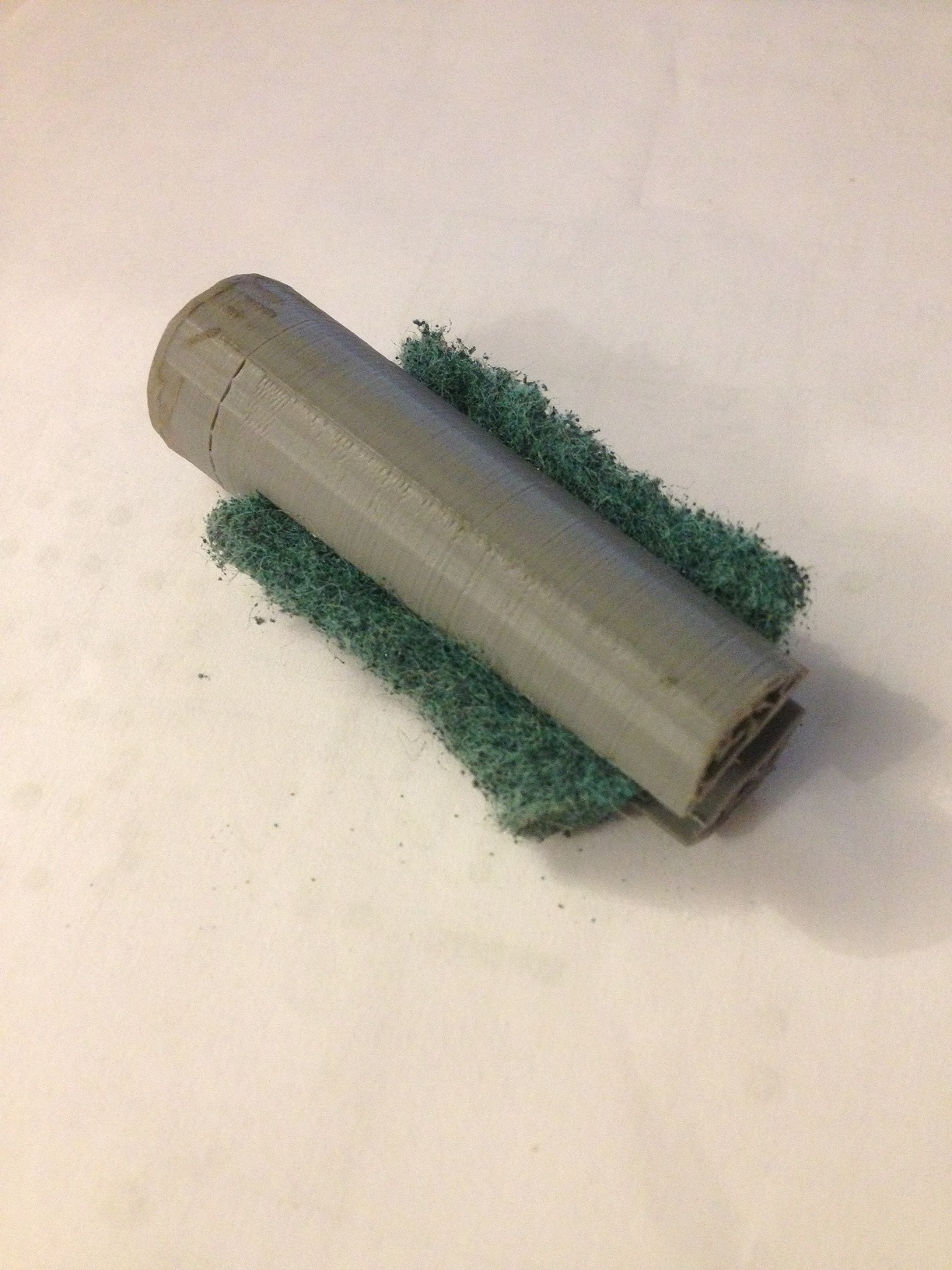

So in the true tradition of homemadetools - I made my own
Attachment 26903
The wiper is made from cutting strips of scotchbrite scouring pad and inserting it into the fork.
Then simply twist it inside your MT3 Taper sleeves to remove debris & contamination.
