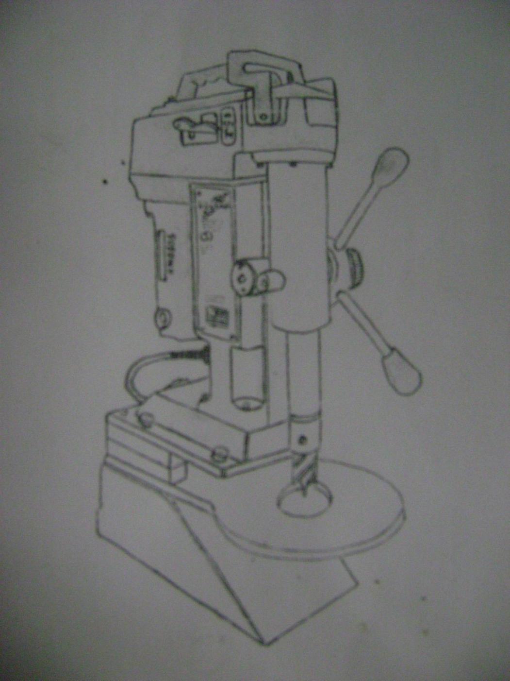

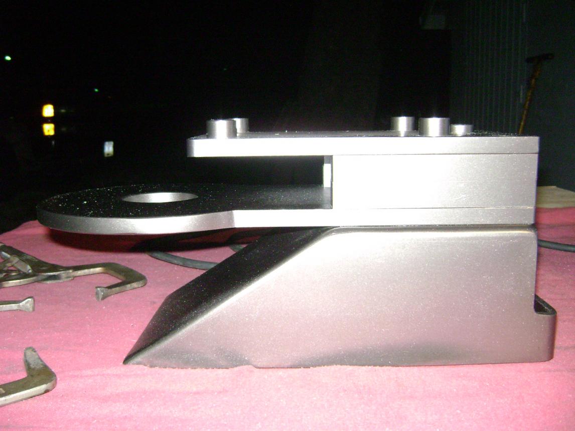

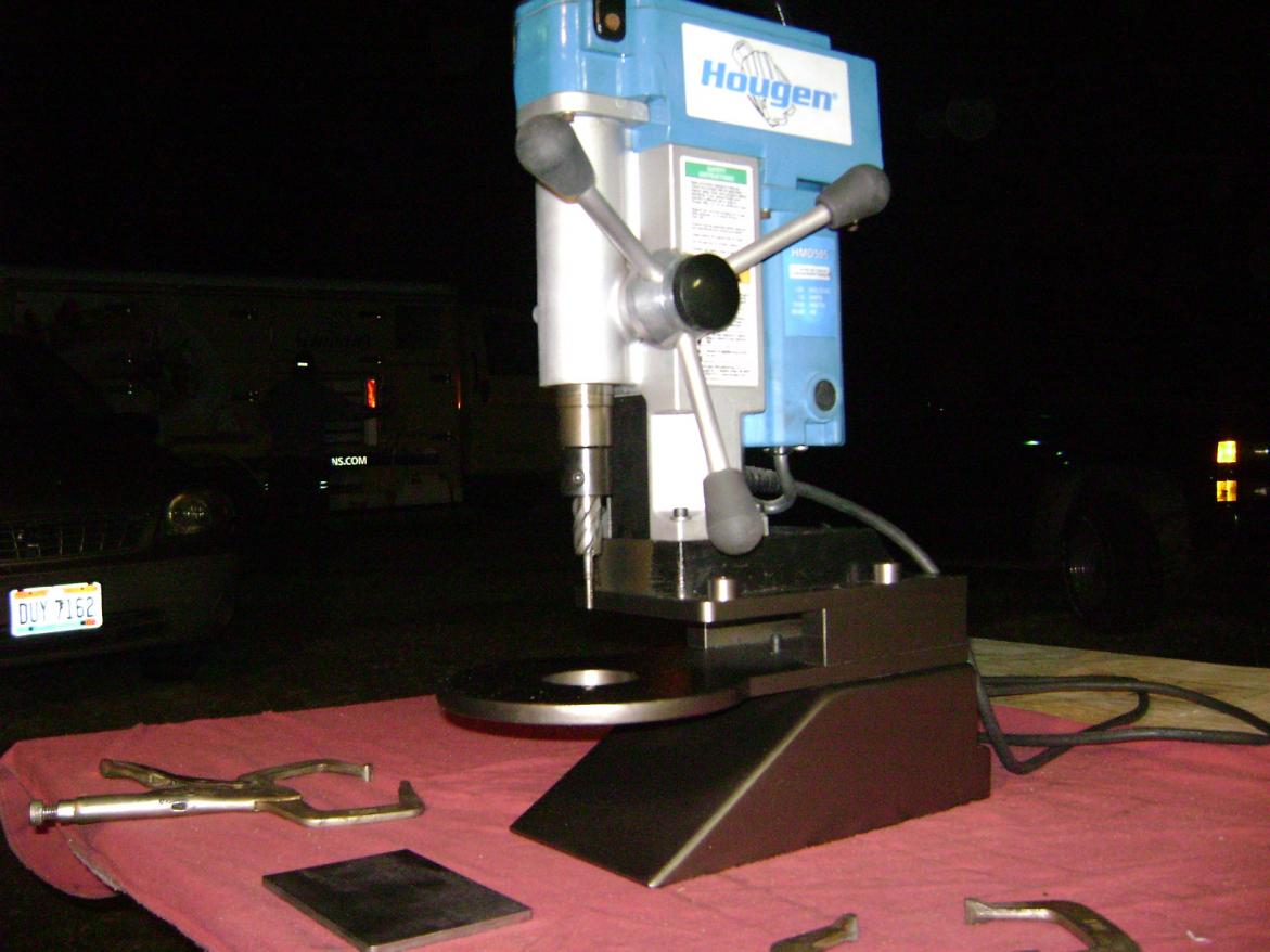

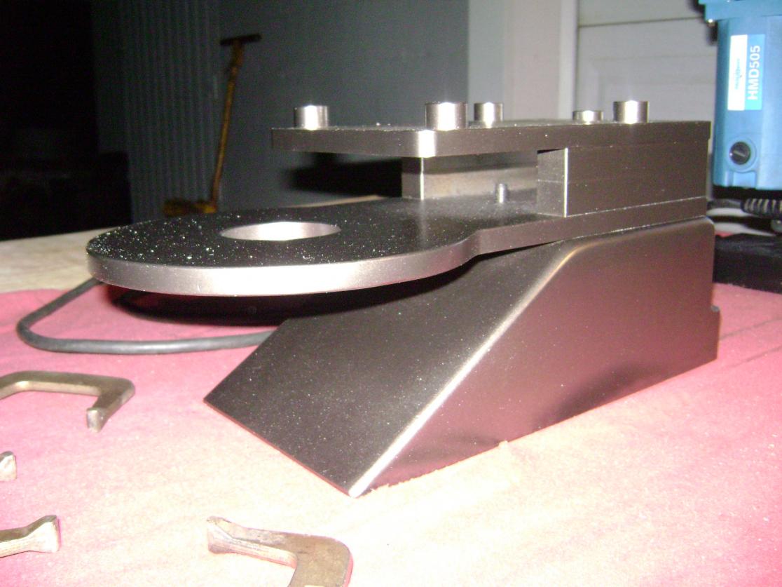

    Picture's of the Magnetic Drill and base
    Here are some picture's to go along with video. And My draft drawing.
