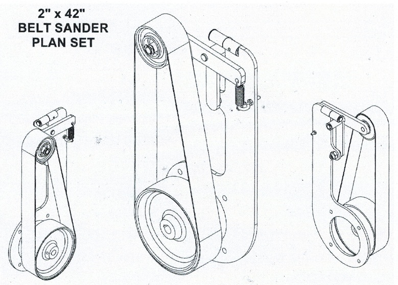

Yes I understand most people don't have the equipment to cast. I got my inspiration for this project from a George Barnes plan which he has made free for distribution. A full plan set is available on the "Projects In Metal" site. His plan is all steel construction and is for a 2"X42" sander/grinder. 42" belts are hard to source some builders have redesigned to 48". For my design I went with a main casting and 30" dual belts so many changes were needed. I also modified the tension and tilt assembly. So a non caster should be able to produce a similar machine.

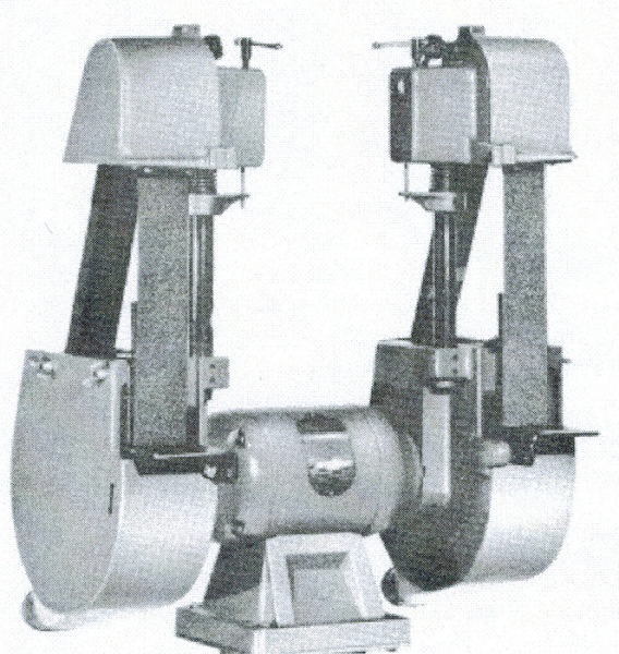

I started Nov.14th and finished Dec.4th, I worked 3 or 4 hrs. per day on it, take out 4 or 5 days where I didn't do anything on it and my hourly rate doesn't look very good but if money is your only consideration then you are missing the point. This is a hobby for me and its about the journey not the end point, you can't put a price on that. A few further points, I may have overlooked something but you can't get a double belt design in this size (though if there is enough interest the Chinese will change that with something cheap).You can get something for heavy work like this:
Attachment 17005
But the price will break the bank.Another benefit is the design process which I find as enjoyable as the build.
