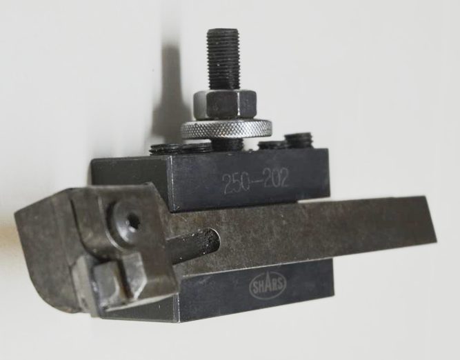

    The previous photo shows a HSS bit and these are great for materials like Aluminium because of their sharp edge. For steel though I prefer flat topped carbide inserts of the type which can take a keen edge. I was going to make an insert holding tool but then I remembered that I had a large standard facing one that I hadn't used in years (3 decades actually) because it was too large to fit my current tool post carriers. It occurred to me that with a bit of milling it would fit the bill with the minimum of work.
    This was the base tool that I started with.
    With a little milling it turned into a tool which would fit my tool post carriers and present the insert at a 15 deg shear angle.
    Shear tools for lathe work.-sheartool-02.jpg Shear tools for lathe work.-sheartool-03.jpg
    Here are a couple more views,
    Used to finish 4140 it gives close to a ground finish.
