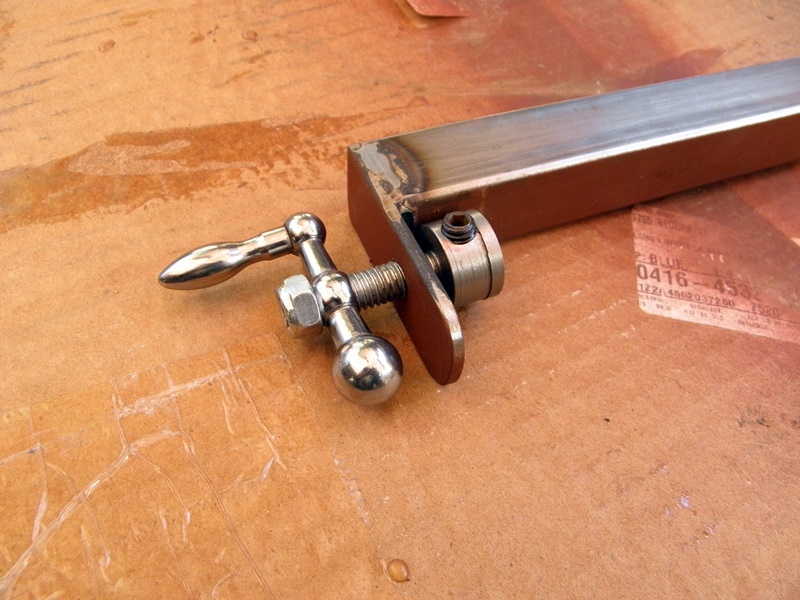

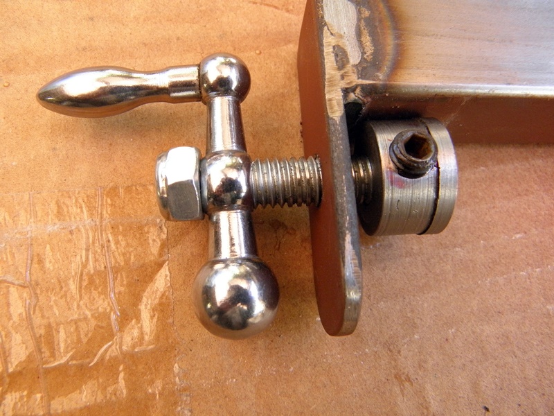

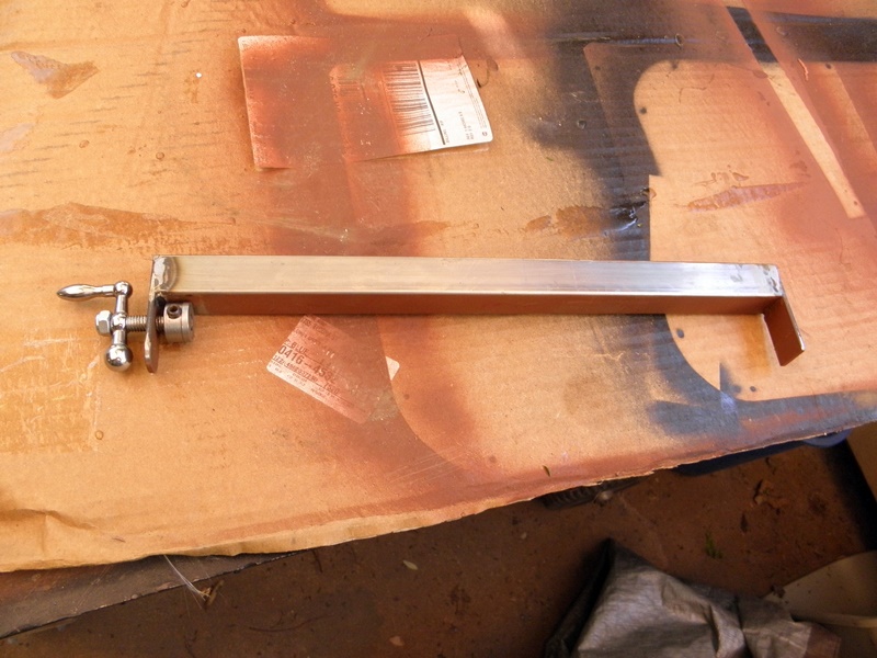

Universal fence lock Modification. Made from cold rolled steel and used handle with threaded rod.
Attachment 6235Attachment 6236Attachment 6237
The grub screw stops the foot from moving whiling turning the handle.
I like this - it is simple and effective
