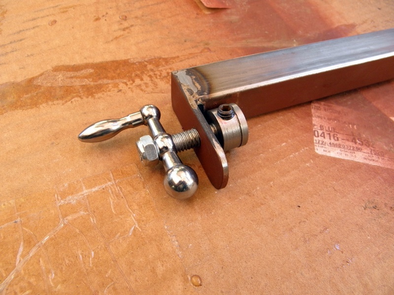

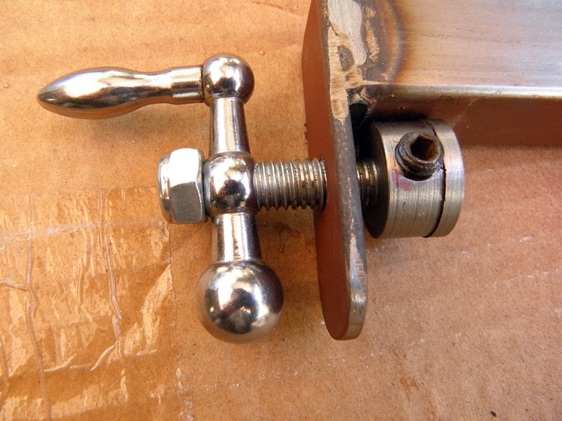

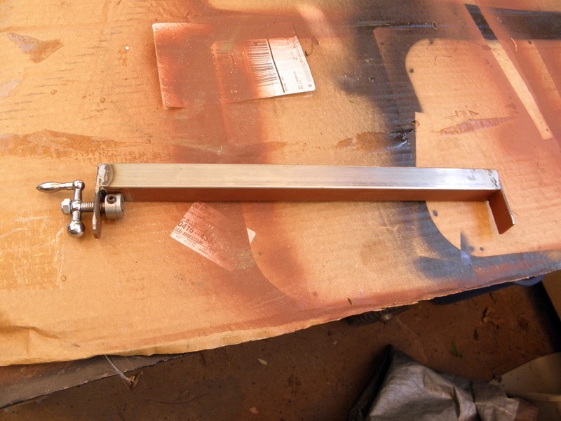

    Universal fence lock Modification. Made from cold rolled steel and used handle with threaded rod.
    Universal fence lock Modification-003.jpgUniversal fence lock Modification-001.jpgUniversal fence lock Modification-002.jpg
    The grub screw stops the foot from moving whiling turning the handle.

    I like this - it is simple and effective
