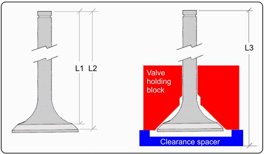

The sealing face of engine valves is not flat but is usually angled at 45 deg. (although in some cases between 30 and 55deg) and that can lead to difficulties measuring the length from face to the end of the stem, and similarly to the retaining collet groove. At times it becomes important to match these dimensions on multiple valves. This morning I decided that I needed to make a holding gadget to make valve matching easy. This post shows the result.

This sketch shows the problem and a possible solution. On the left we have two extremes of length between L1 and L2 and these can vary depending on the diameter and width of the sealing surface. in other words we have no reference surface or line for an accurate measurement. However, if we mount the valve in a block as shown on the right, which is machined at the valve seat angle and has a good fitting hole for the stem, we can see that L3 will be a stable dimension.

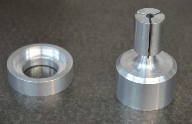

Attachment 16662 Attachment 16663 Attachment 16664

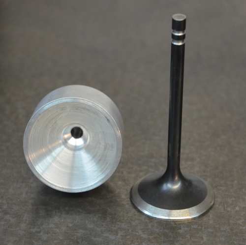

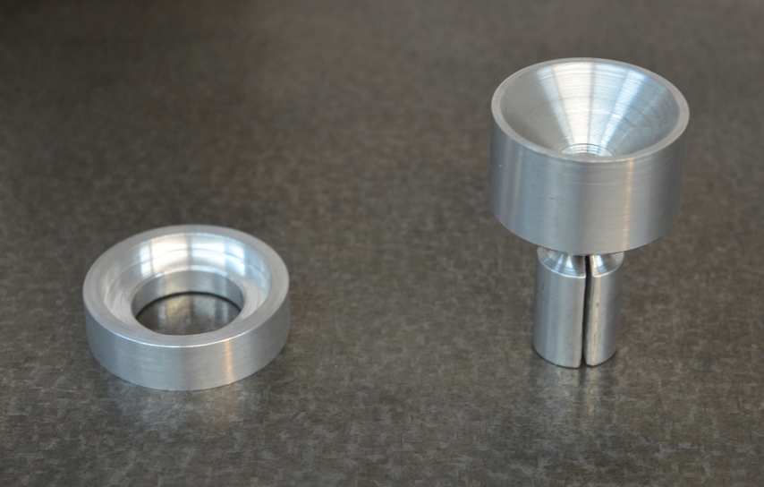

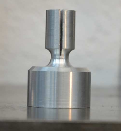

Here is the physical implementation. The ring on the left is simply a spacer to ensure that a valve head which protrudes from the bottom of the block has clearance and doesn't mess up the length measurement. The other piece is the valve holding block. The large end has the 45 deg. taper which allows a large range of valve head sizes to be accommodated. The smaller end is slotted to form a collet to grip the valve stem. The last photo shows a relieving groove to allow the flexibility needed for the collet to work properly.

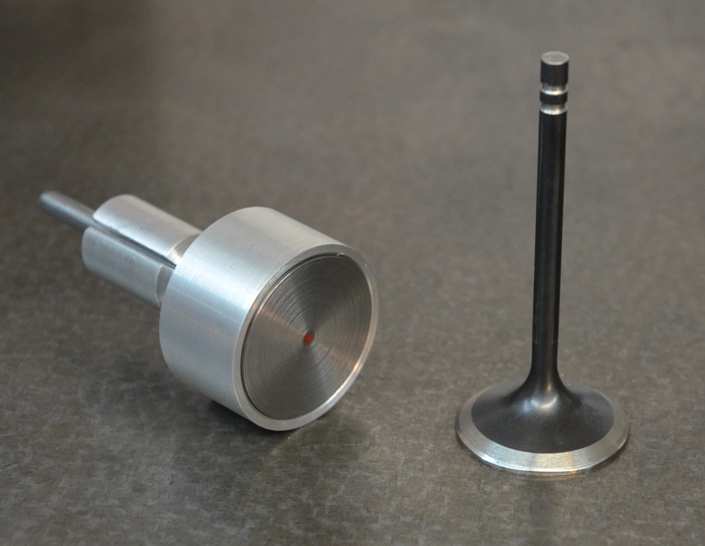

Attachment 16665 Attachment 16666
On the left we can see the block and a valve, on the right a valve is loaded.

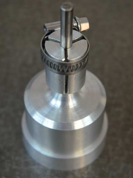

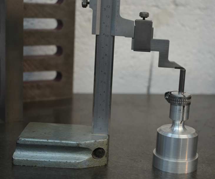

A jubilee clip is an easy way to clamp the collet on to the valve stem. Note the spacer under the valve holder to ensure clearance of the valve head off the surface plate. A vernier height gauge is used to get a stable reference dimension. This tool makes it very quick and easy to check a number of valves for consistency.

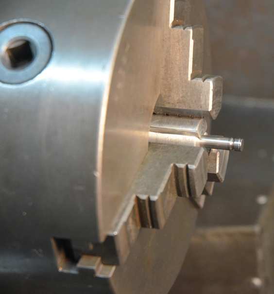

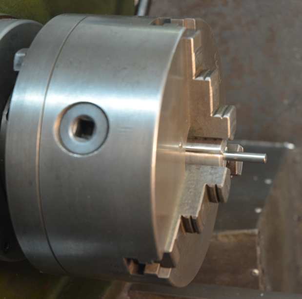

Attachment 16668 Attachment 16670

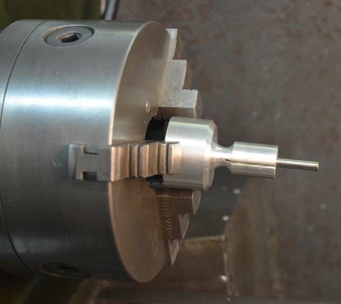

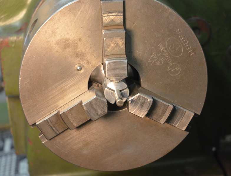

Fitting the valve holder in a 3 jaw chuck. The large end is placed inside the chuck beyond the back of the jaws and closed down. Just prior to clamping on the collet the assembly is pulled forward such that the large end is located by the back of the jaws. This gives a repeatable axial location.
Attachment 16671 Attachment 16672
On the left is a clear view of the collet clamping, on the right we can see the valve retaining collet groove as machined with this holding fixture.
