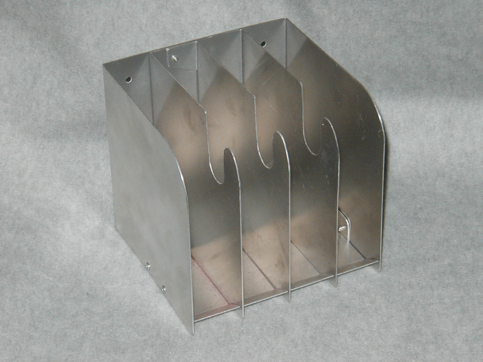

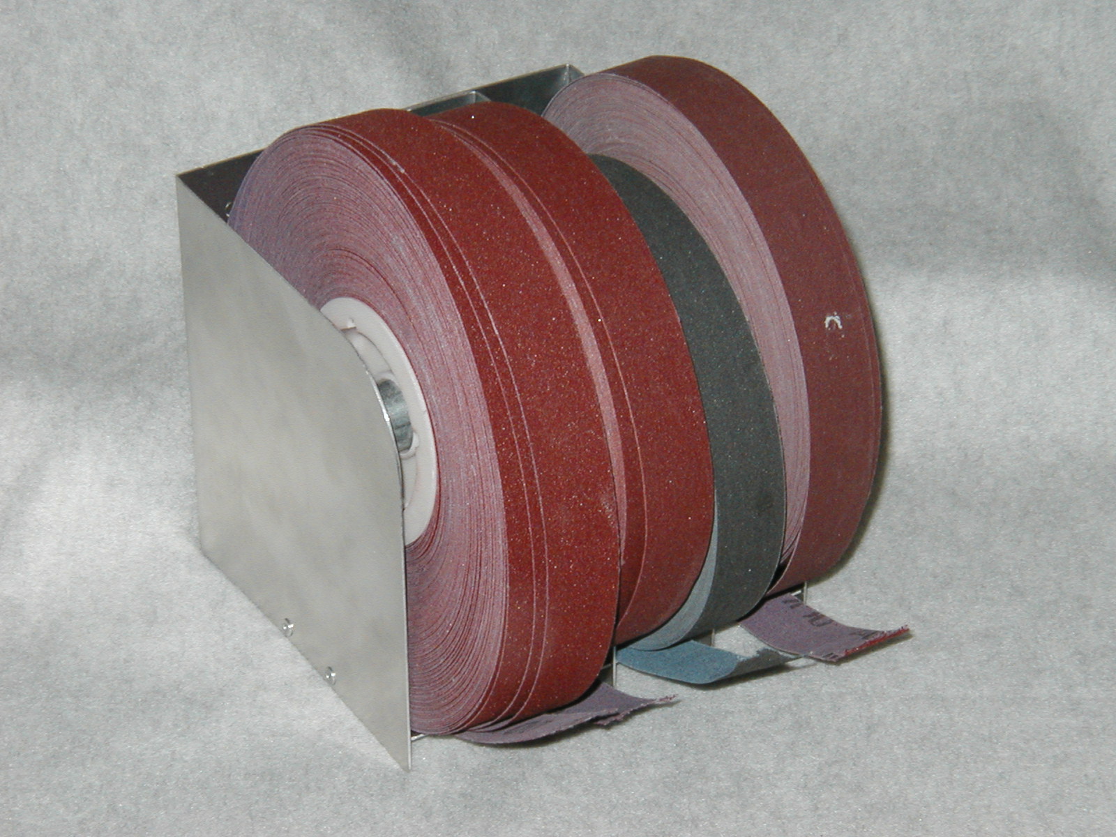

    That's neat. I made one for use at my lathe but had fewer sizes with larger 1" wide rolls.
    and
    It is all metal (aluminum) and the spindle is just a scrap of electrical conduit. Assembled with pop rivets. Since I use cloth backed sand paper in it, I did not see any need for a tear strip. The cloth tears straight across with no problems. I have made a nice trimming device with a hacksaw blade for sheets of sandpaper. Sorry, no photo is presently available.

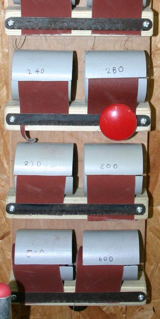

    Christophe again you are quite right about the difficulty of finding which grade of paper as the grit sizes are very sparsely printed. The idea of the coloured magnet is one I am already using and they attach neatly to the metal of the hacksaw blades. See photo below

    Hi Paul, The holders are as you have deduced, made of plastic pipe or ducting which in this instance are 54 mm outside diameter. The crucial measurement is the thickness of the pipe wall. The thickness I used was 1.5mm which means that the slit opens widely very easily (I was fumbling a bit in the movie clip, but that was just me being clumsy and not a difficulty opening the slit in the pipe). I tried using thicker plastic pipe and found that anything above about 2mm was too inflexible. All the tube is doing is supporting the 2 metre long roll and as long as the pipe opens easily along the slit there is no problem.
