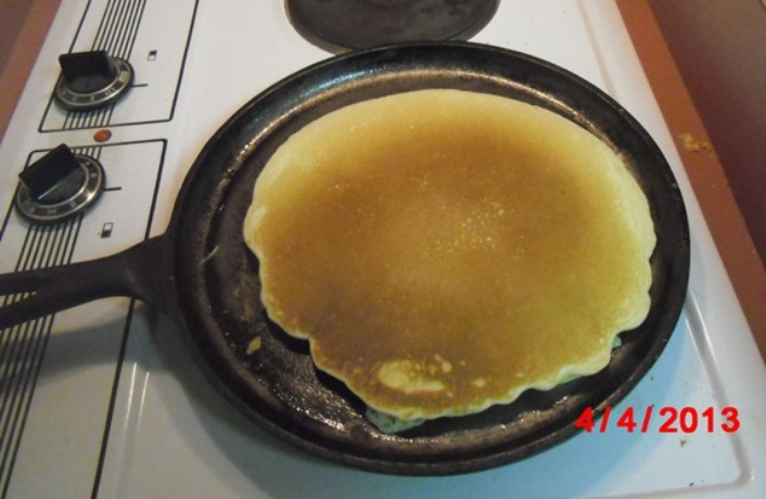

Sounds like a few new tools might be needed to if there was a perceived need to modify any pans to the 'right' height? One thing I have always wondered about is why there are no cast iron omelette pans.
This is what I always use to make my omelets, fried eggs, pan cakes, sausage patties, bacon, or hamburgers in
Attachment 20939
