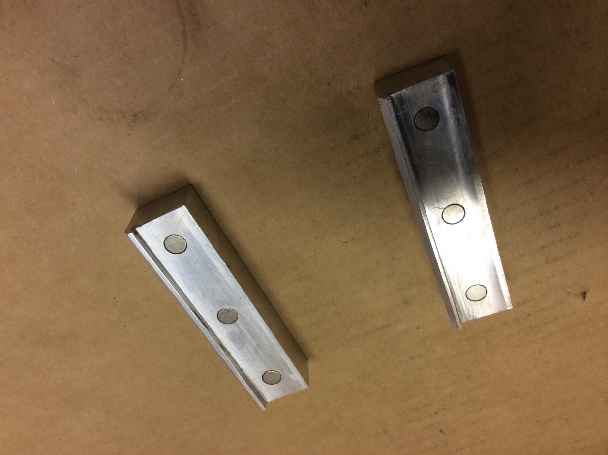

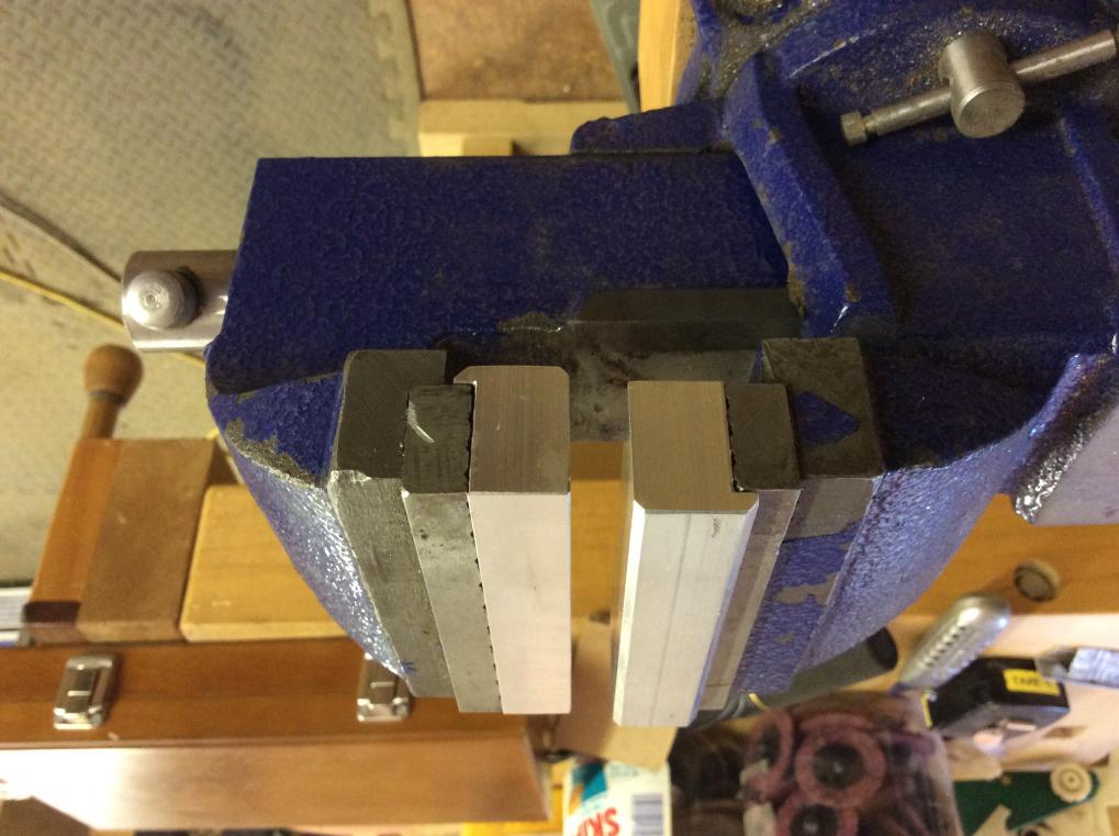

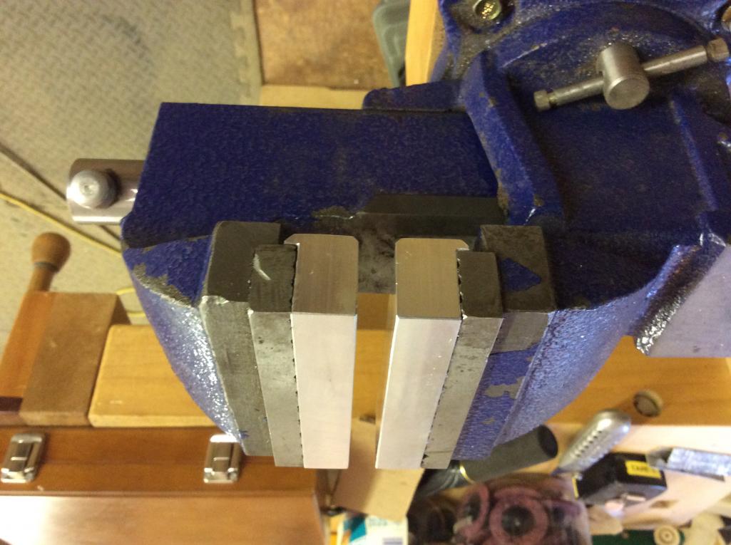

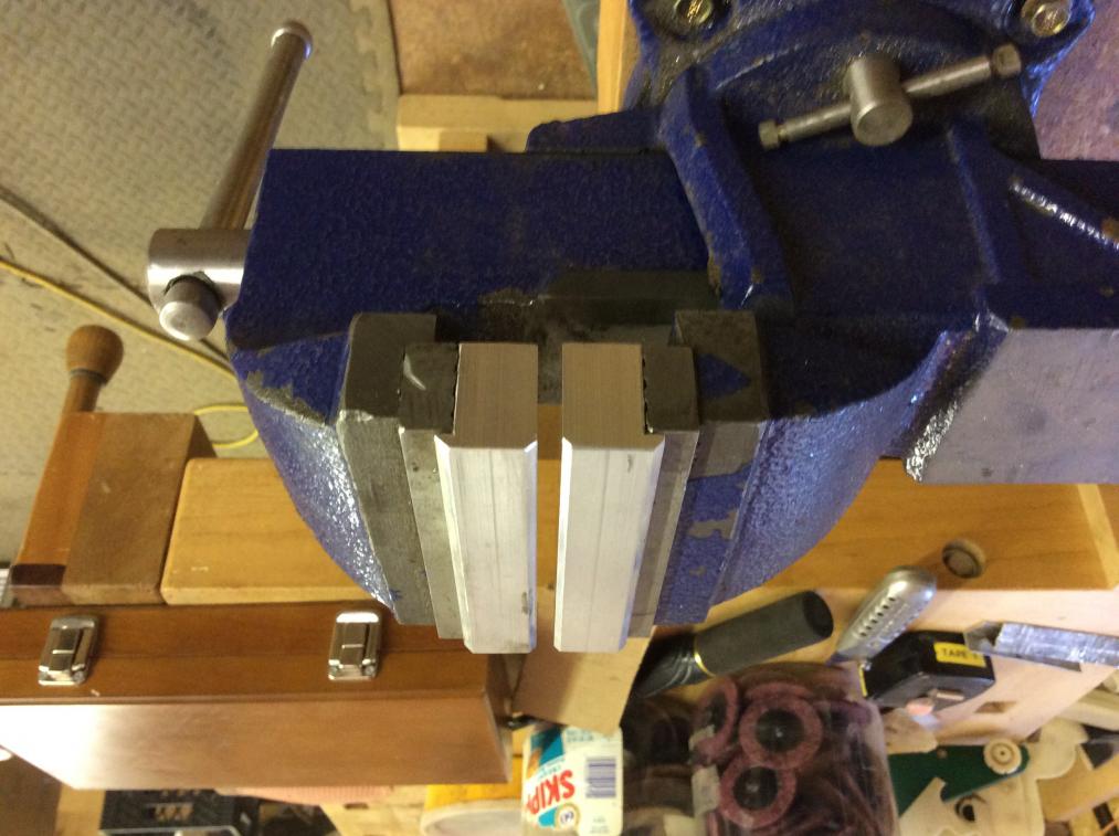

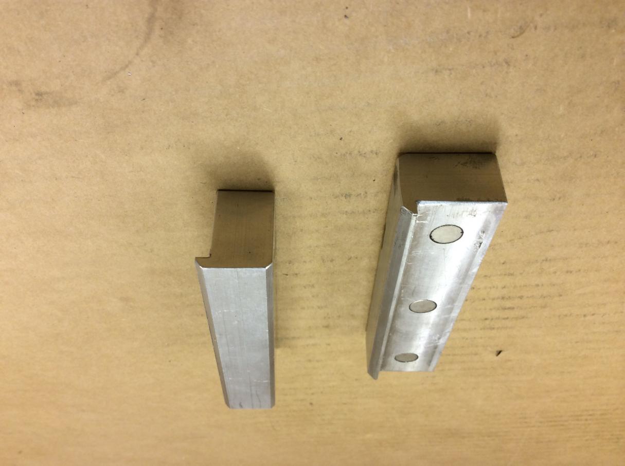

Some new soft jaws from 6061 Alu. Size 4" x 3/4" x 3/4". Potted in neo magnets.Attachment 1690Attachment 1691Attachment 1692Attachment 1693Attachment 1694

Catfish,
The soft jaws looks like something I would like to build. What are the dimensions (diameter and height) of the rare-earth magnets?
Thanks, Paul Jones
The magnets are Dia 0.315, Thickness 0.117. I bought 100 on ebay real cheap. Very strong.
Now I have an idea of the diameters to get. I've been thinking of getting a batch of neodymium magnets but didn't know what size would be appropriate.
I love the neo mag approach over bolt-on ones. Easier to install and remove.
