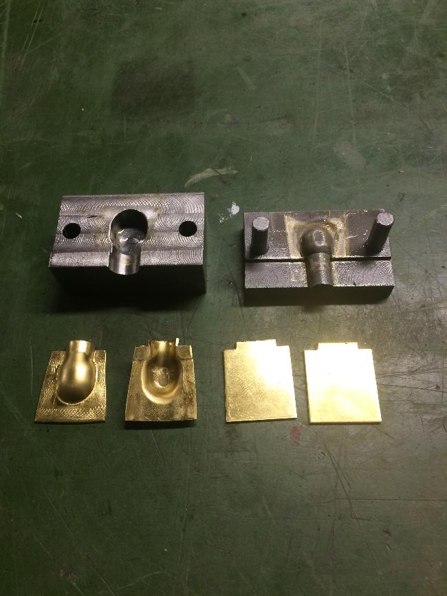

    Hi All

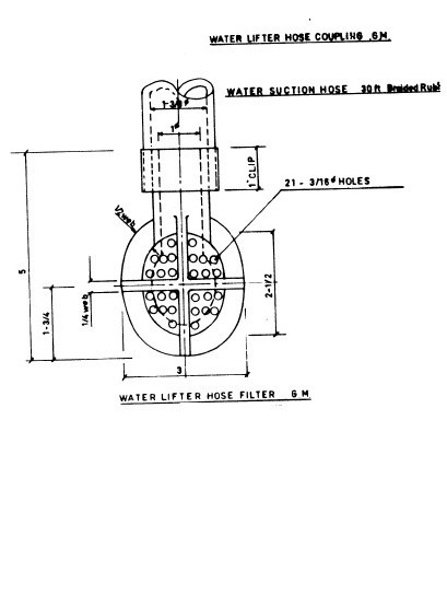

    This is a water lifter filter for my 3” Foden Steam Wagon. I thought I would share the tooling made to form the material along with the drawing so you can see what the product will eventually look like. The main body, is made from two brass pressings and silver soldered together then filed to shape. The webs are also silver solder to the pressings, and then the drilling. Will post more photos of the build as I go. The drawing is actual size of the original water filter, so I have scaled down to ¼ size.
    There is more info on the Foden build on my web site Practical Engineering
    Thank you for viewing
    The Home Engineer

    Nicely made press mold die set, What is the thickness of your brass sheet/ Did you use common shim stock? If so did you have to anneal it prior to pressing? In the past I've had to make pressing die set for antique carburetor floats out of copper sheets. I found that if I heated the sheets to between 900 to 1200° f then water quenching softened the sheet enough to work it into the complex shapes

    Hi Frank
    The brass is 16 Gauge and I did anneal the brass before pressing. I will have to look out the item and take some better photos.

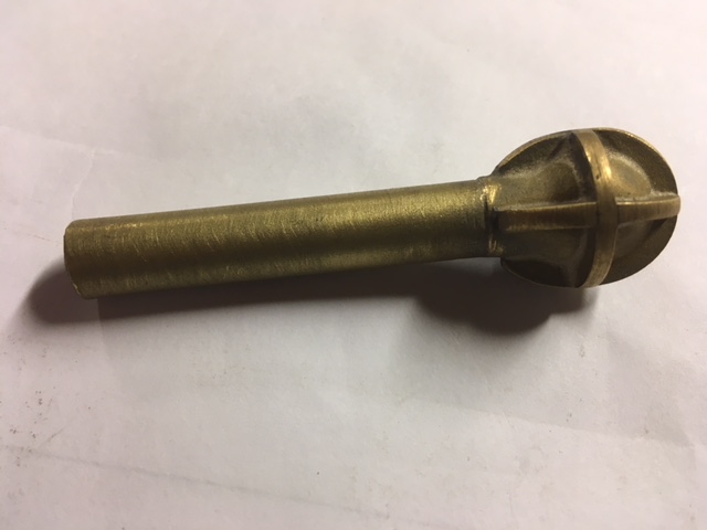

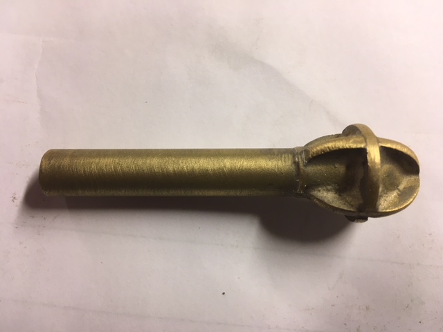

    Water lifter silver soldered together complete with webs, just needs drilling

    Wow it looks like it was cast! Beautiful work! Thanks for showing the mold and the details.
