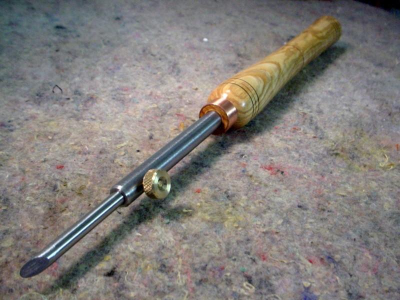

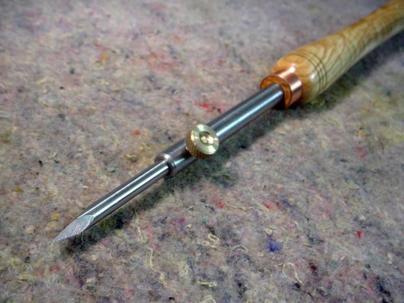

Here is a woodturning tool handle, with different tips :
- HSS three faces point for cutting thin grooves
http://www.labellenote.fr/photo/gal_...ini_gouge2.jpg
- HSS angle ground tip tool, for cutting coves
http://www.labellenote.fr/photo/gal_...ini_gouge1.jpg

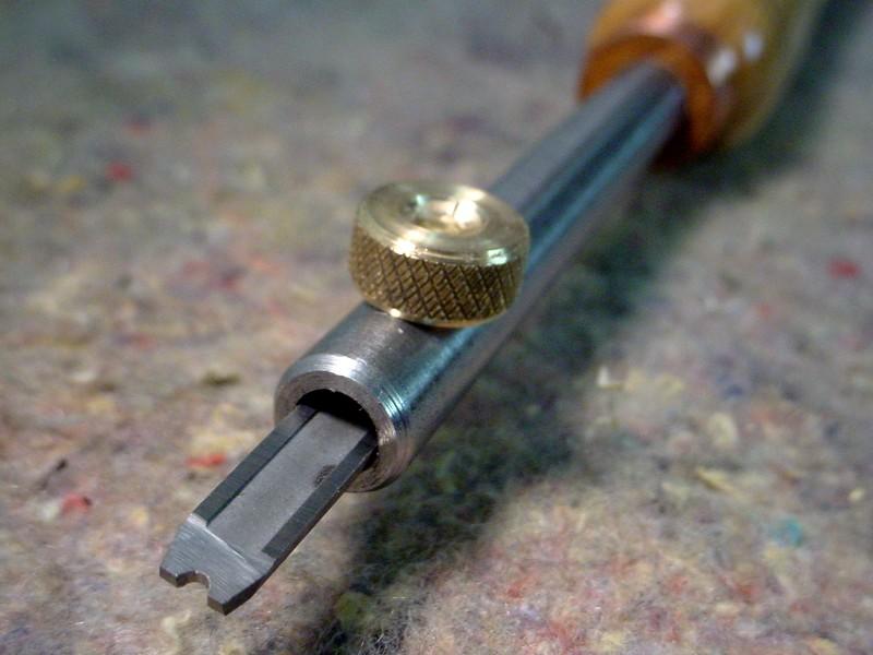

- carbide tip shaped to cut beads, in wood and even metal (brass rings)
http://www.labellenote.fr/photo/gal_...ini_gouge3.jpg
The two first tips are actually the same HSS 6mm bar that can be reverted.
The body is 10mm regular steel, with a little brass knurled pressure screw.
The handle is made from nice curly ash, oiled.
