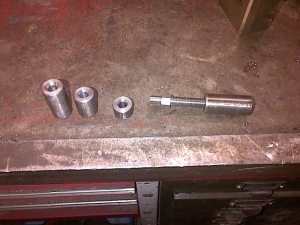

Homemade Case Spreader
naughtyboy on homemadetools.net
Homemade case spreader intended to facilitate the restoration of antique farm equipment. Machined from 1" round stock, drilled and tapped M10. Jacking bolt was fashioned from 11/16" hex bar. Spacers range from 1/2" - 1-1/2" in length.
