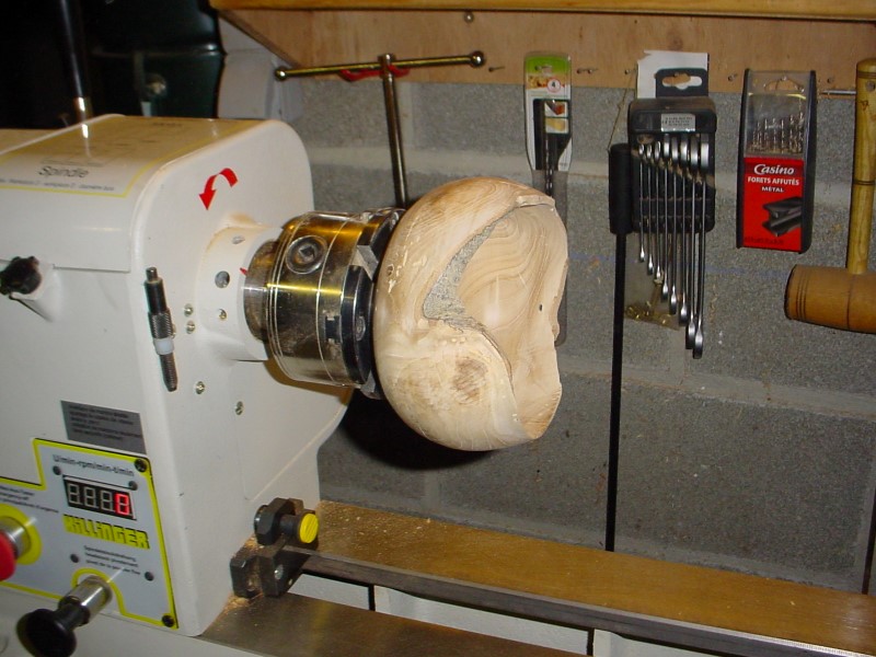

    I recently got the opportunity to purchase for a good price a batch of M33x3.5 nuts, which happen to be the thread of most of the European lathe spindles.

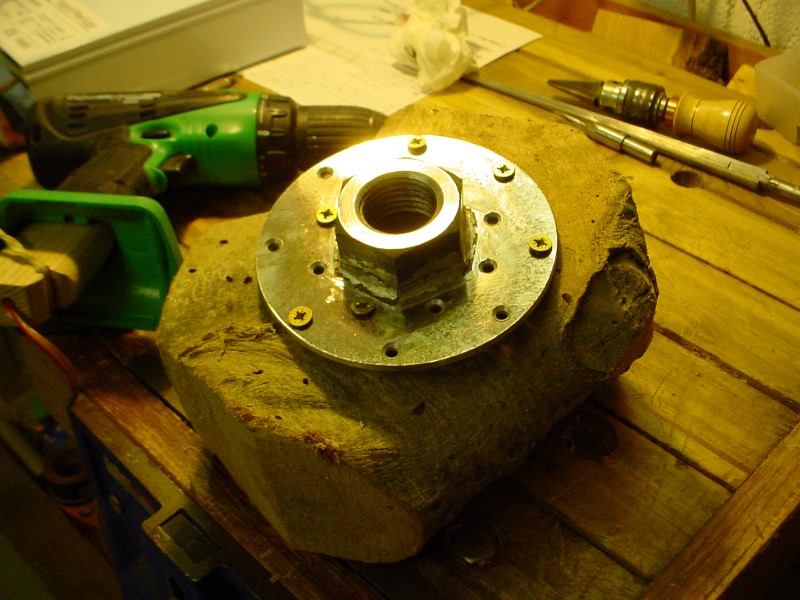

    There is a lot of possibilities with these nuts, here are a couple of examples :
    First example is a face plate.
    The nut is welded to a steel plate, then mounted on the metal lathe and the plate is then trued up.
    The holes are drilled afterwards.
    Before welding, I had trued the face of the nut on the lathe (I have an M33 spindle that can be mounted on my metal lathe chuck)
    And here we go:

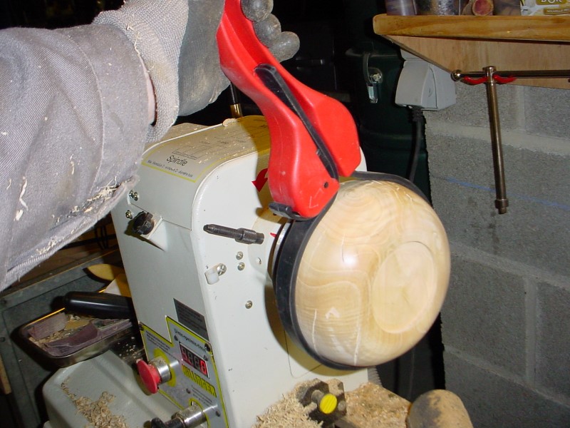

    Here, as I haven't got any 33mm spanner to unlock the nut after the turning (and dit not make one yet), I use this rubber band tool which appears to be very powerful.

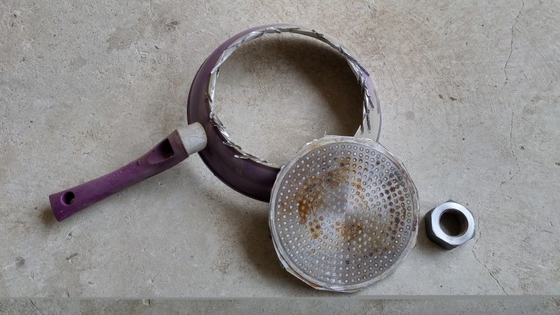

    I have often some difficulties to source plates of metal. Here is an idea ... (this is not what I used for the above example).

    That's a great idea to get metal! I wonder if cast iron would work for a faceplate, or if it would be too soft. It comes pretty thick anyway. I imagine that aluminum would also be common in a lot of cookware, which is weaker than steel so I imagine best to go a little thicker with that material.
    You got me thinking! Really what a great idea to get thicker metal, which can be expensive. I did the same thing, but used 2" or 3" steel washers. I had to keep them small because any bigger than that and it gets very expensive very fast. I suppose because the area of a circle increases much faster than the diameter so there's a lot of difference in amount of steel in 3" vs" 6" washers. That's why it usually pays to buy a large pizza, not a small or medium!
    Bigger than 3", I would have to order stock from a supplier. But maybe not any more, thanks for the tip.
