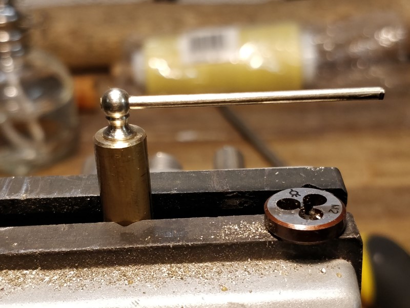

    Here is a batch of nickel silver ball post blanks : (they are quite small, the ball is 4.5 mm in diameter.)
    For supporting the rod, which is actually a long 2mm diameter screw, one ball must be drilled through, 2mm diameter, and the other ball must be tapped M2, so drilled 1.5mm.
    It is quite challenging drilling such small holes through a ball shaped piece, and it is quite critical to keep well centered.

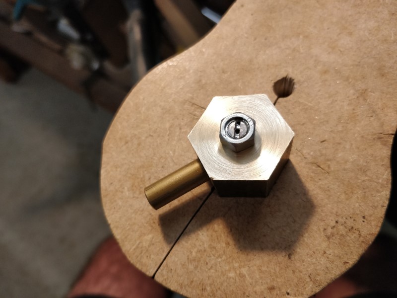

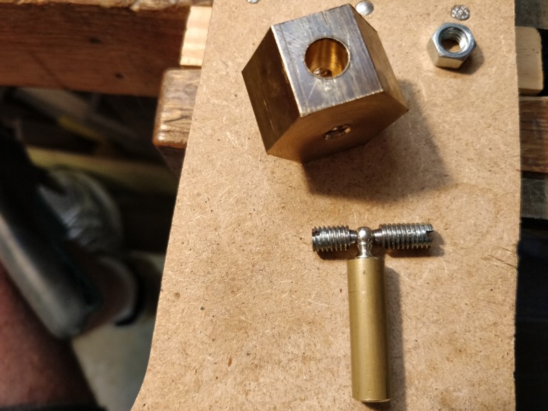

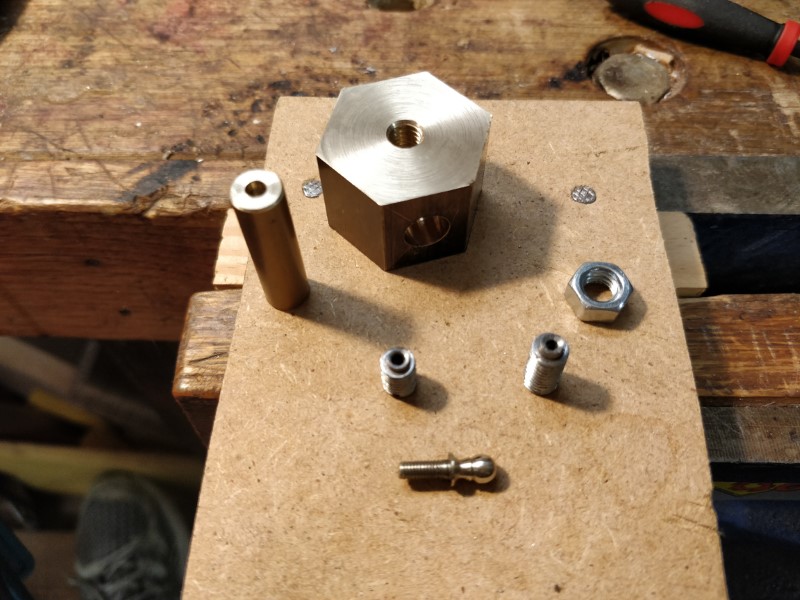

    Here are all the parts:
    - a main body (out of hex stock)
    - Two small screws, center drilled, and with a conical tip. They will act as drilling bushings to guide the drill bit.
    - A tapped transversal support, that will hold the ball post while being drilled.

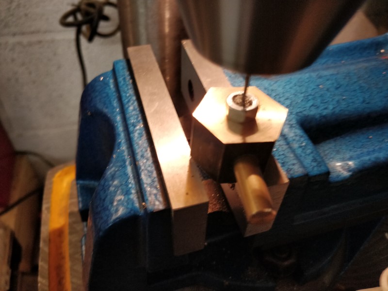

    Here you can see how the ball post is hold in place inside the fixture.
    The two screws will guide the drill bit. One is center drilled at 2mm, and the other at 1.5 mm, so the same fixture can be used for the two different sizes required, you just have to revert it upside down.

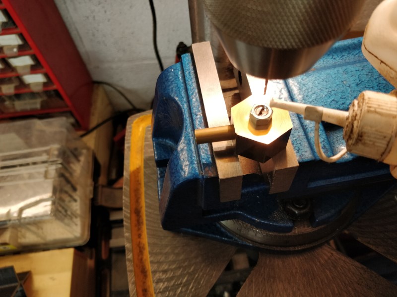

    Everything assembled, ready for drilling.
    one drop of oil
    And here we go

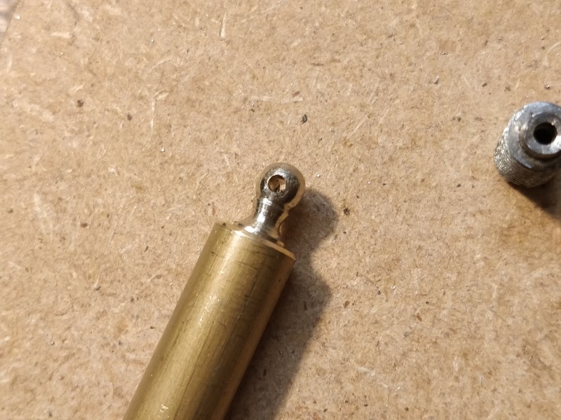

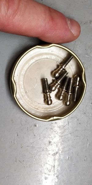

    What we obtain :
    Perfectly true :
    I can show here an example of what the finished key looks like (on my last instrument) :
