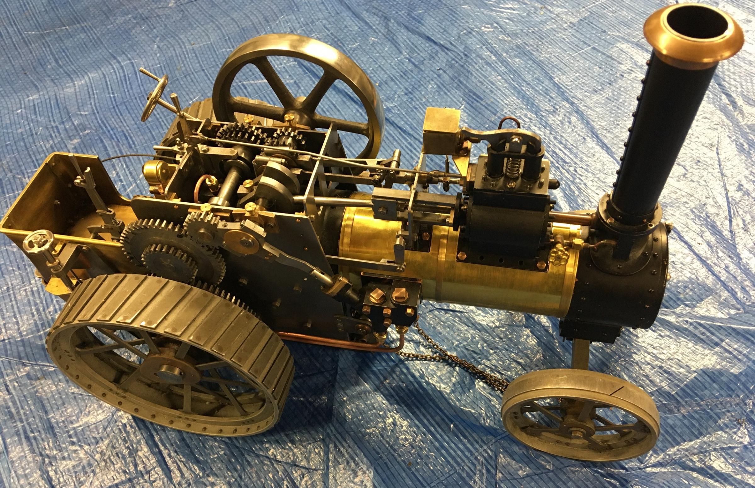

    Hi All
    Over the last few days I have decided to set a new years resolution and finish my 1" scale traction engine which I started in 1985. The engine is almost finished with only a few jobs such as the plumbing, fire grate and coal bunker and a few other minor jobs. It will then be taken apart for painting.
    Over the last few days I have made the boiler cladding and boiler straps. My home made bead roller had a couple of dies made to create a joggle along the edge of the brass cladding to ensure a nice fit.
    http://homemadetools.net/forum/bead-roller-75870
    The photos of the engine below has had a few items removed such as the water pump and steering so the cladding could be checked for clearance of the cylinder block, spectacle plate and the water pump. The cladding was rolled on my newly refurbished slip rollers
    Sheet metal rollers
    So I am starting to reap the benefits of the bead roller and the slip rollers didn't need a good clean before using.

    engine needing a little TLC

    showing motion gear

    Boiler bands riveted and silver soldered ends. These took an incredible four and a half hours to make

    Cladding with cut outs. I made a cardboard template to ensure the cutouts would fit the boiler. Trial fitted to a 2,5" tube with wooden insulation material to create the correct diameter of boiler.

    Joggle dies to 0,5mm set
    Thank you for taking a look at one of my many projects that need finishing.
