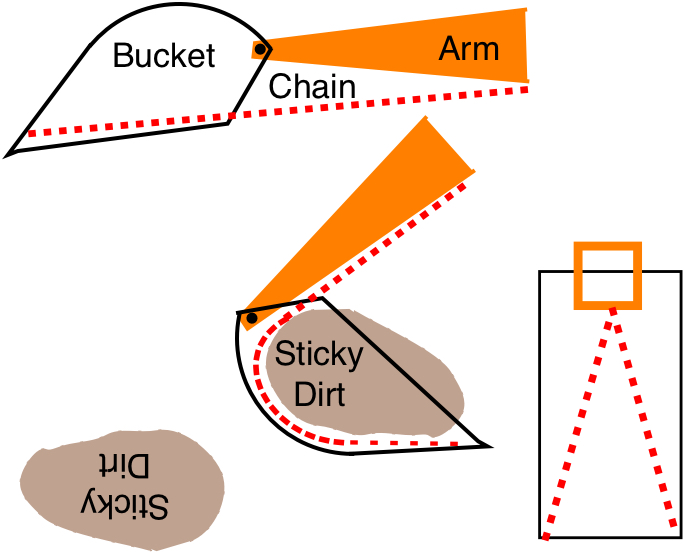

How do you get your bucket to empty out? I have a very similar trenching bucket but it always packs.up with my clay soils and I can hand dig a trench just about faster than I can using the old hoe. Spend more energy and time digging packed dirt out of the bucket than I do running the machine. Usually default to the wider digging bucket and ensuing mess
This is how I clear sticky material from a hoe bucket. Attach a chain to the arm. Run that down to the bucket. Add a second chain to make a "V". Attach the 2 ends of the V to the bucket. Adjust the length so the chain is almost straight but not tight with the bucket fully uncurled. When digging the mud will push the chain deep into the bucket, When you uncurl the bucket, the chain pulls the mud out.
