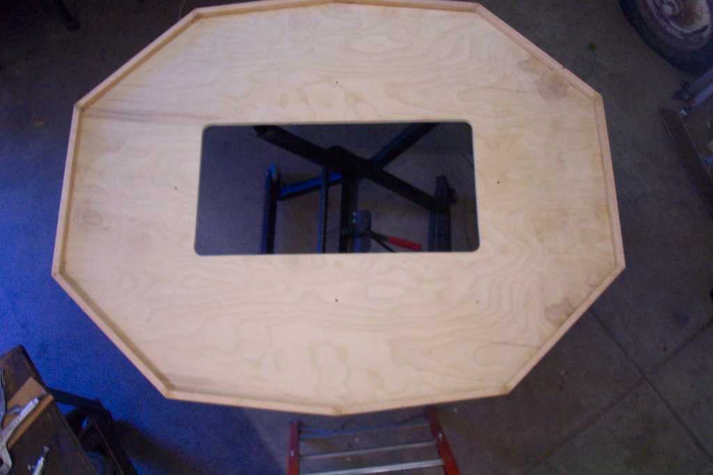

    A group of friends have been playing poker for many years. I decided to make a Poker Table that would accommodate up to 10 players.
    Although the usual count is 7 or 8 at our weekly games, there are times when it's easily filled with 10.

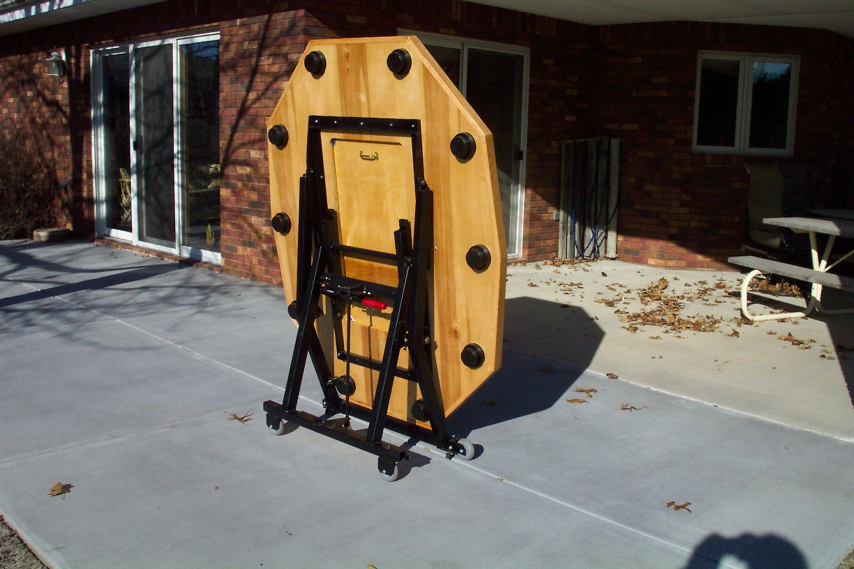

    The table was intended for limited space and be able to fold up for storage without having a split-line in the middle.
    I used SolidWorks to design the fold-up mechanism and the table top. It was made at a height for people to use "bar stools".
    The table top was made using surplus 3/4" Birch cabinet panels, with oak side rails & trim added.
    The angled Birch pieces were joined using biscuits.;

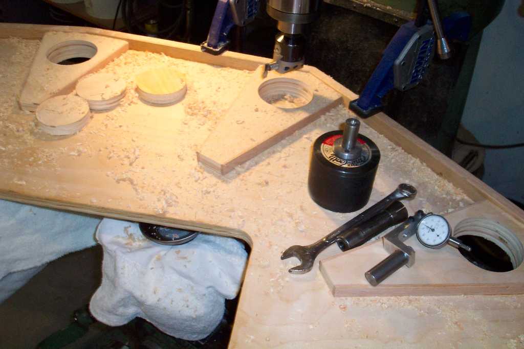

    Holes for cup holders were done on a mill;

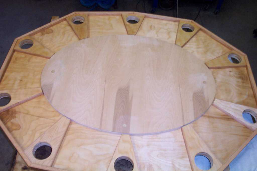

    Prior to staining.

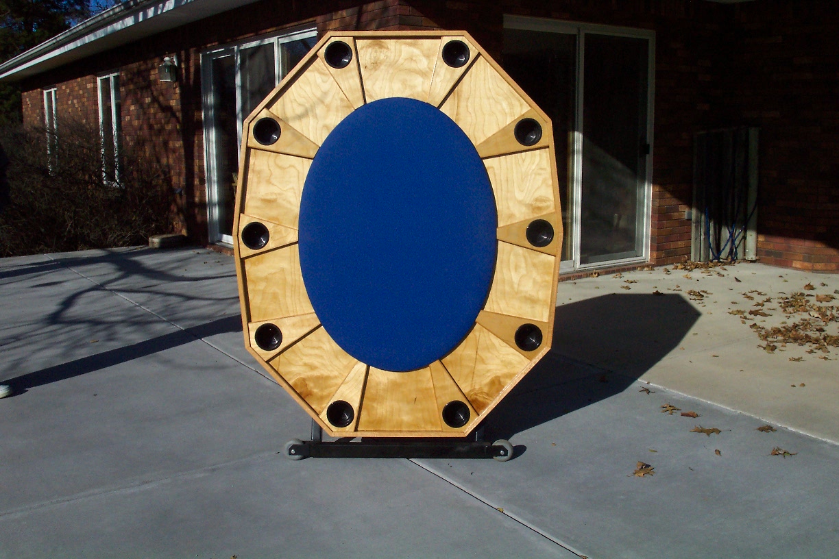

    The oval piece was covered with a tough vinyl
    and has seen about 17 years of use with no damage;
    Table with folding mechanism, rear view;

    Top folded up;

    Video of it is being folded up.. (excuse the poor quality of these videos, they were done with a compact camera)
    https://drive.google.com/file/d/1RIR...usp=drive_link
    Video of it unfolding...
    https://drive.google.com/file/d/1EUE...usp=drive_link
    Video showing how one set of casters is moved 90º from the position needed for opening up
    to the rolling position for storage...
    https://drive.google.com/file/d/1OiS...usp=drive_link
