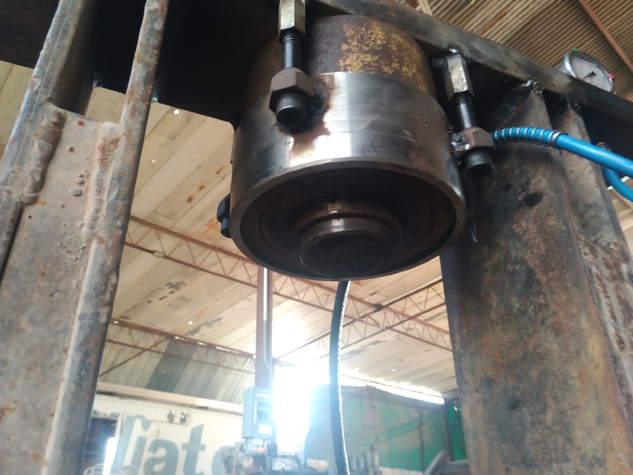

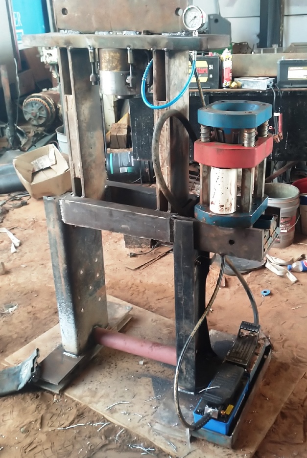

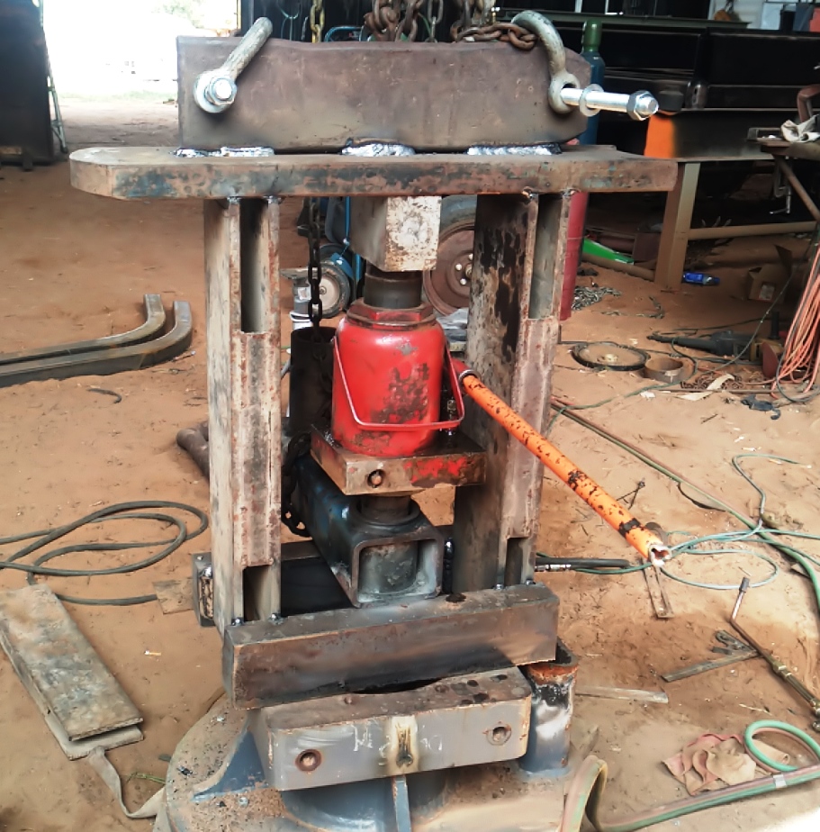

    I find myself needing a stronger shop press all the time/ So a while back when one of the farmers brought me a part that needed the spindles pressed out of it I welded some scrap pieces I had laying around and used my 50-ton bottle jack to press them out by using a lot of heat to get the job done. later I found a 100-ton Enerpac cylinder on ebay to make a proper press.

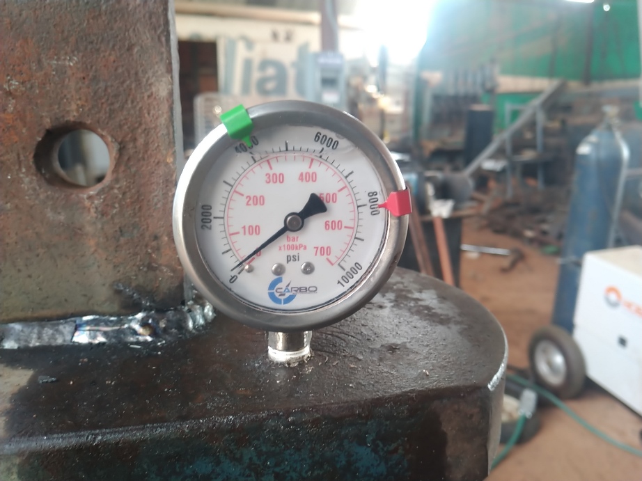

    I added a 10,000PSi gage to tell me how much tonnage it required to do the pressing
    each 1000 PSI in 10 tons Neat.

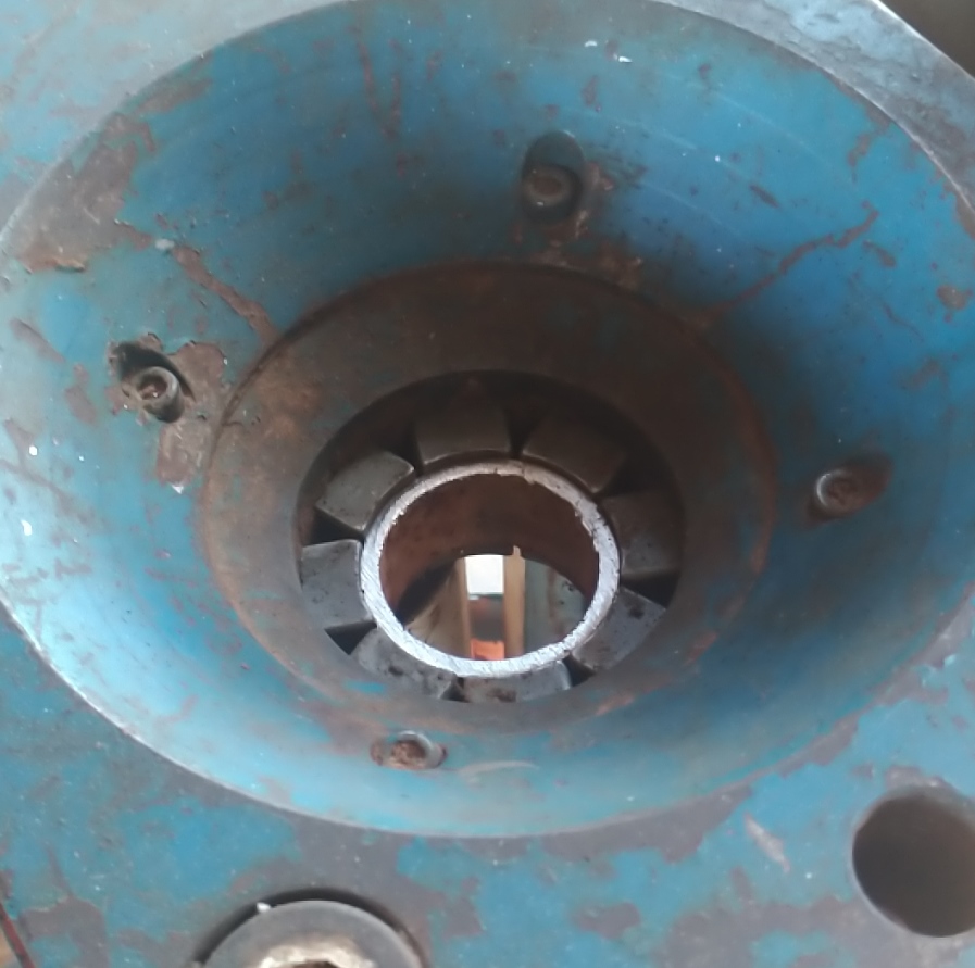

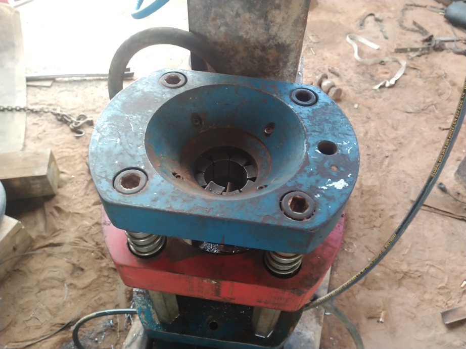

    The side of the press frame seemed to beg for the addition of my 50-ton hose and swedging press

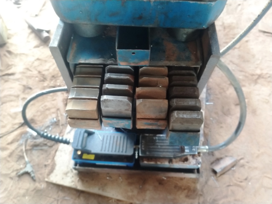

    A space below that became the home for the dies

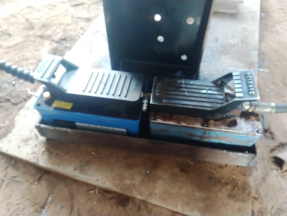

    2 Air pumps complete the press

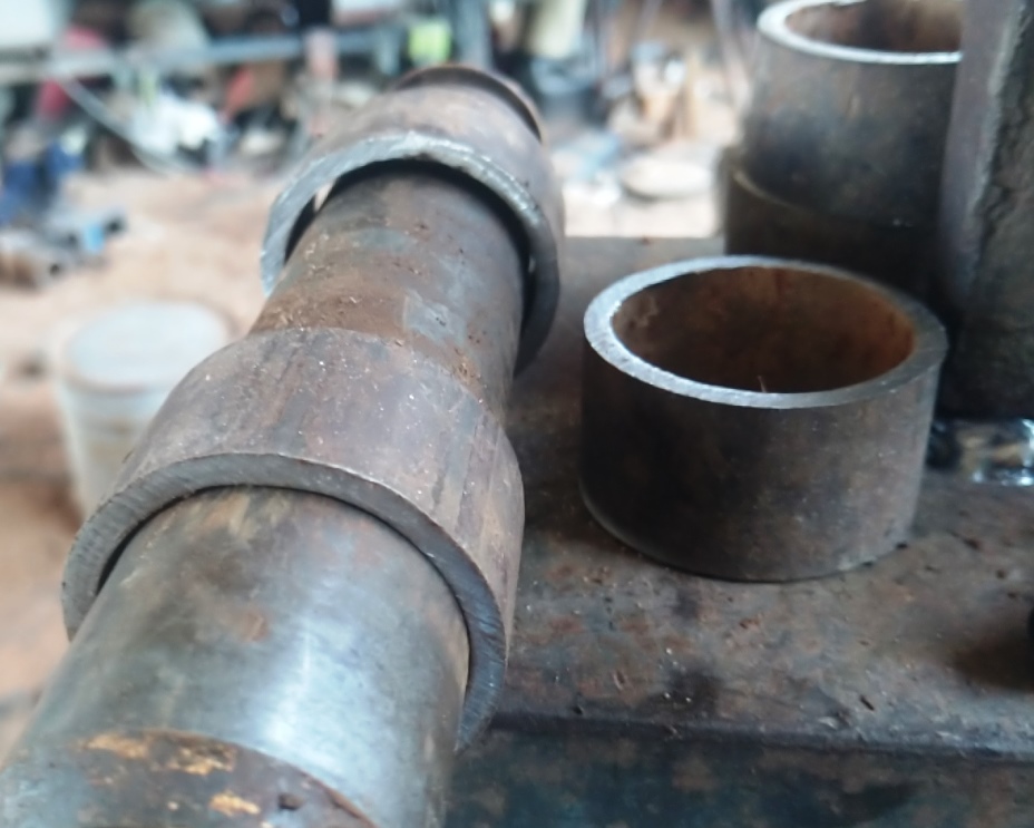

    Some pipe sleeves I swedged to size to use on the D3 dozer
    Before and after note the loseness of the sleeve on the background Vs the one in front
